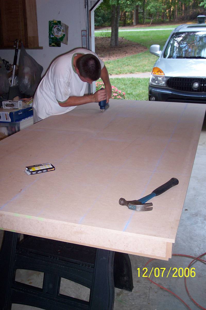

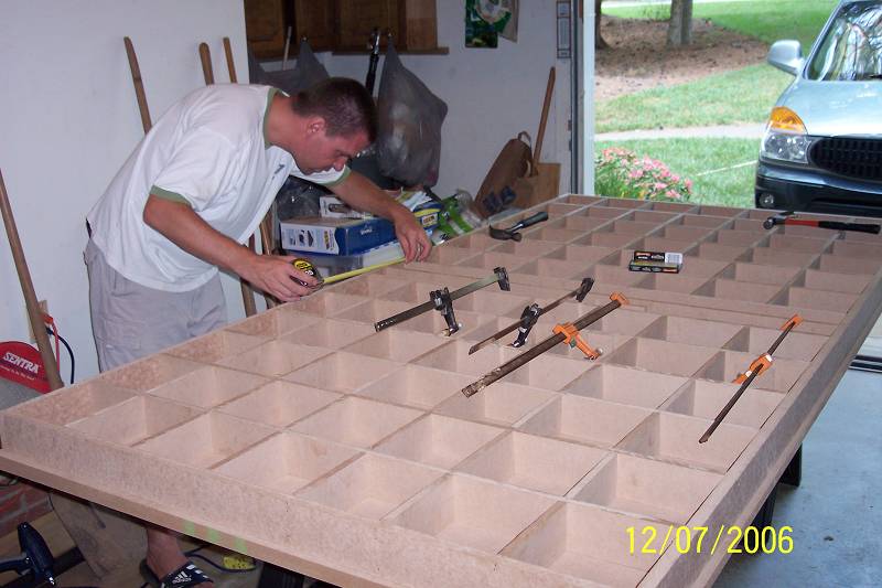

Ok guys I guess it's time I joined in and shared my Black Magic build. I started by locating a suitable building area and since I live in a condo with a roommate I had to look elsewhere for the space. Well after an hours drive to my parents house and a little chatting with dad I was given half of his workshop. Which meant that the riding lawnmower had to find a new home.
The first matter of business was building the work bench. Dad found plans for a woodworkers table in American Woodworkers magizine. I don't think I was doing the type of woodworking they had in mind but it'll work. The workbench is made from two pieces of 1/2" MDF board with a 3 inch honeycone in between them. I'll include some pics below which makes it much easier to visualize. That's it for now, more to come later.
Rick

Wow, that's an awesome looking table Rick!
I'm interested in how it resists warping under load and age. Like how much weight could you stack on it to sheet a wing, how humidity affects it etc....how long it takes to build it

Mike,
I build it almost a month ago, and it's been sitting in a non-climate controlled shop and so far it's rock solid. I wouldn't be afraid to put a couple wings on it for sheeting. I can tell you that when we carried it from the garage where I built it to the shop it didn't warp one bit. I'll keep you guys posted on how it holds up.
I think I started building it at around 10 in the morning and finished around 9 at night. All I can say is thank god for that new nail gun. Without it I'd still be putting nails in
I didn't think of using it for a foundation, if the whole airplane building thing doesn't work out I'll give it some thought!!
Rick

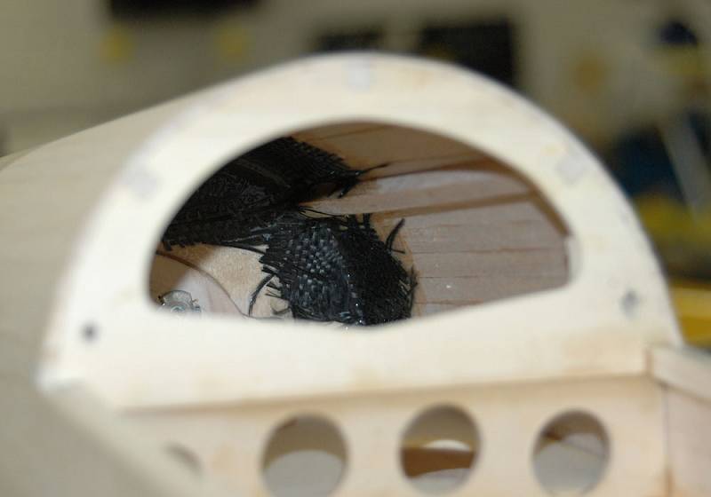

Hey all,
another little thing to do, is lay in some carbon cloth from the fire wall to the top strip sheeting. Mike suggested doing this to prevent cracks in the sheeting.
this photo is a bit tight but you can see what I did. I layed up about 2 layers of 2 oz cloth. It's hard to do it super neat, but no worries cause nobody can really see it without hurting themselfs...
spent the day yesterday flying with Mike, Emory and Jim Ivy - had a great day of practice.
I videoed Emory flying the Masters pattern with his eBlack Magic - super impressive. I'll try and get it up on a web link early this week.
later all....
