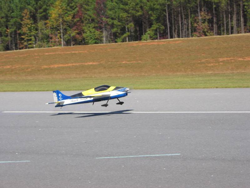

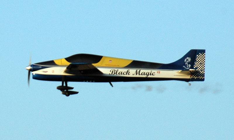

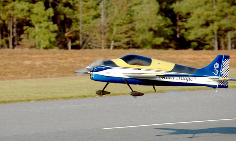

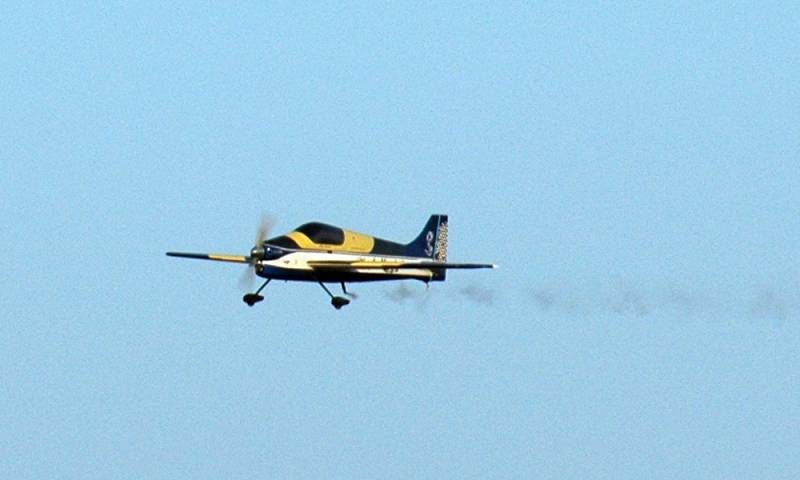

Hey All,
here are some pics of Mike's plane on the practice days before the D3 champs. and a couple of close ups of mine.
enjoy!

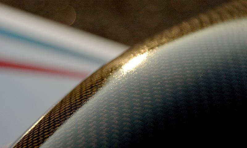

Well, since this seems to be " Post Black Magic Pics Day " I might as well throw in a couple. Emory's and Mike's.

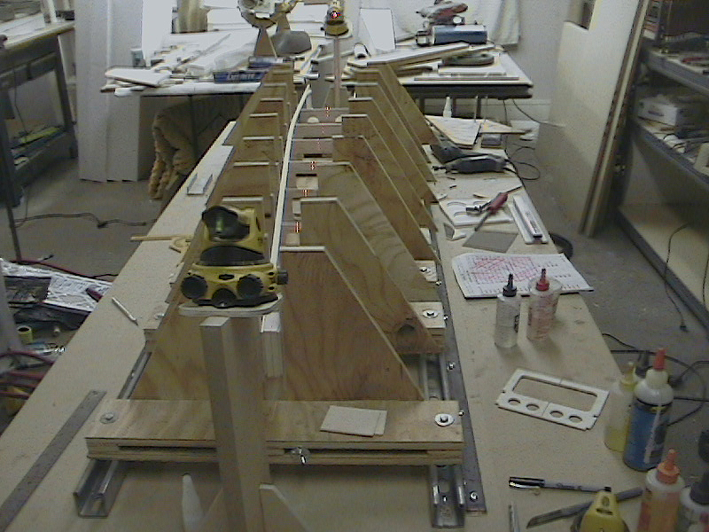

Nice pics by the way!
Now as promised (better late than never) here are a couple of pics of the laser jig. I'm messing with a new camera so I don't have the settings quite right yet.
Basically, this is Pete Cosky's jig rails and stations with a few modifications.
First I mounted it to a piece of MDF board, about 8 feet x 20 inches. I also installed some angles to brace the rails and make sure it stays flat and level.
After marking a good center line, I installed 2 posts on each end, and this is where the lasers are monuted. The model of this laser is an X3 available at lowes for about $35 or so. From there, they get more expensive...but this one works great and is fully adjustable.
They are mounted at downward angles. This lets the light shine on more of the formers, top and bottom so you can keep it from being skewed or twisted. The uprights on this jig are large and extremely powerful.
After using it a couple of times, I'd have to say for function, it blows a gator jig away. This is only my opinion, but with it's size and adjustability, and the way it locks and holds a position, I think this one wins hands down. It doesn't have positive 90 degree locking on the uprights, but after having to shim a gator jig because the wood wasn't cooperating, I REALLY like being able to just snug these up and lock them down.....done, no slipping.
Also because of the way it's made, I can see easily how to install adjustable leveling cradles for wing and tail alignment. That's my next project!
I also made a really cool edge sander, and it makes trueing the edges of lots of sheeting a breeze. I'll take some pics of that when I get a few.....

Geez Mike.....that thing looks massive in your pictures.....oh wait...it is.
I'm glad you like it.

Hey Pete,
What thickness of plywood did you use for the laminated cross pieces that bolt to the Unistrut rail?

The whole thing is 19/32" ply. I didn't want an issue with warping. The strut is made locally and is 12 gauge cold rolled steel.
I wanted adjustability so if someone was building a "V" structure it could accomodate it. It's also big enough to take a fuse up to 16" wide. Maybe the IMAC and boat guys could use them too.

Thanks for the info, Pete. I am making my own version and thought it looked heavier than 1/2". Not much, as it turns out, though.

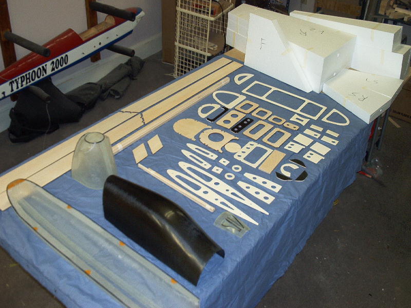

A few sneak peeks at the new kits.....
Looks like it won't be too much more expensive than the older kits, but with more parts, and better accuracy. Many parts are still "sand to fit", but at least you don't have to actually make them and stand there with a dremel forever. I haven't priced it all out yet, but it doesn't look too bad.
The parts are SWEET. After much debate, we elected to go with laser cutting for the balsa parts. There is no burn out to speak of, just a little tan dusting on the edges. This allowed us to make center line marks on the parts.
The plywood and composite laminated parts are CNC cut. Very, very nice indeed. I'm also including some super light hand cut stringers. This can save a ton of weight alone.
Anyway, I should have pricing tomorrow and the web site updated by the weekend (hopefully).
-Mike

Hey Mike,
Man that kit looks great, I bet you could do the basic building in less than 3 days with the look of the kit parts. Wow! It really looks super easy now - all the parts gotta save at least 2 full days of cutting and sanding. Man those root ribs look great and wow - your even supplying the carbon laminated parts - dang it's more like saving 4 full days of work.
I think the hardest part of the build now is the wing spars and tubes, which is actually super easy, just scary the first time.
I bet guys are really going to be jumping on these kits!!!!
