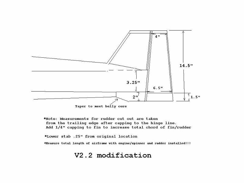

Mike,
To do the rudder mod do I need a new core or could I just extend it with a balsa block since I am going to run a YS in the nose? The tail weight from the balsa block would help offset that.

You can just use a balsa block and extend the bottom rear 1/2" back and down....the weight is miniscule.

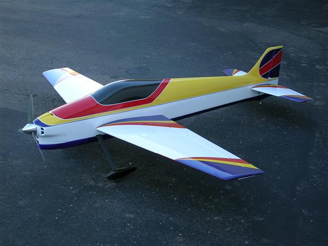

Default RE: Black Magic v2 builder's thread! *Updated*

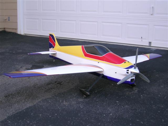

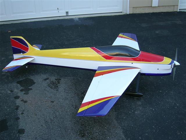

My current Black Magic model. I should be finished with it in a couple of weeks. Then I will start building a another one for electric. I should of had it done several months ago but I am a slow builder and an even slower painter.
Tony Watkins

Ok, here ya go....the V2.2 mods.
I do have the cores, and will sell them at dead cost. Foam, box, packing and shipping....$50, Paypal only for this one.
You can easily do it yourself. But the belly core is bigger, and the rudder/fin core makes it cleaner with a thicker TE.
This update is optional, and provided as a service to existing customers. Thank you for everything!
-Mike

Looks great Tony! More when ya get it done!

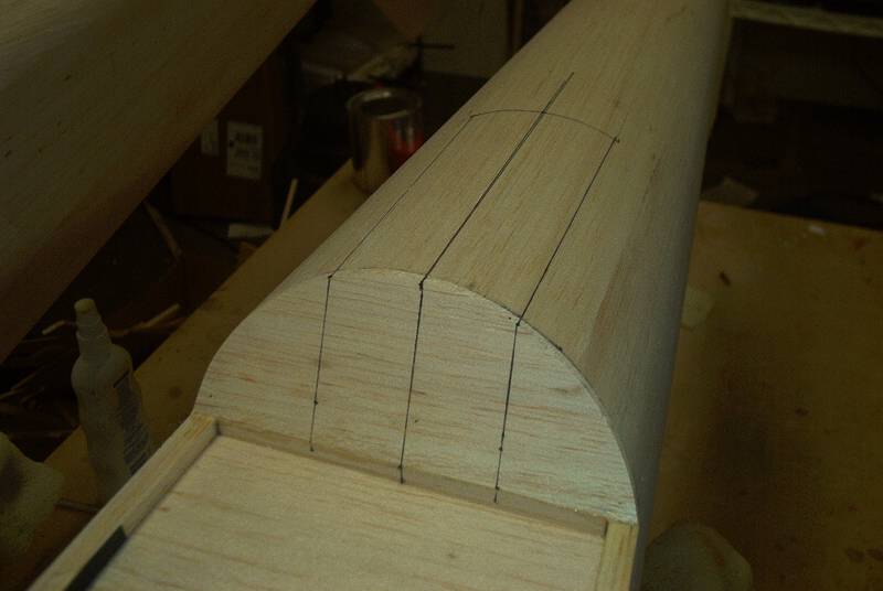

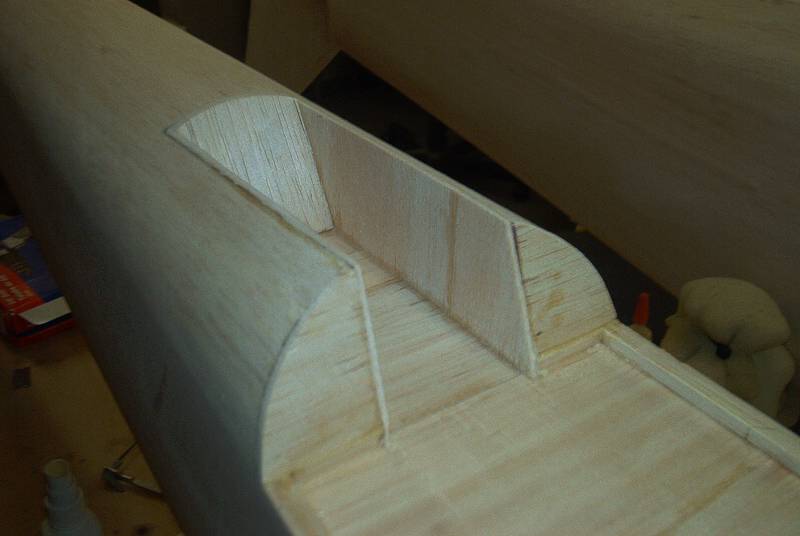

Dennis, I always use the 2C140M8 pipe on all of my OS engines. header at stock length. What this amounts to on the plane is that you have to extend thepipe tunnel about 6-61/2" past the end of the belly pan. It's easy, just floor it there, make a cut with a razor saw, sand with a block and install vertical grain 3/23" or 1/8" balsa. On the back face, angle it out and won, not dead flat.
Wendell.....yes, tons of maintenance. I'll get to that when I have a minute.....

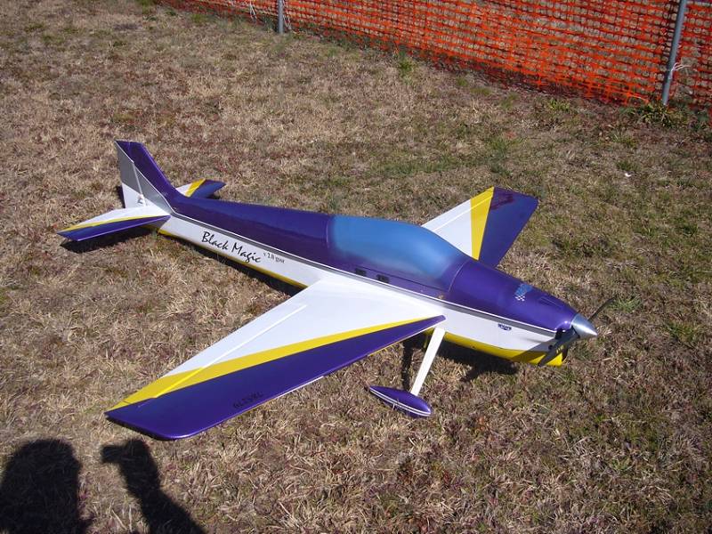

Well the Black Magic gasser is finished. Final wieght 10lbs 14 oz another 3 oz can be saved by changing battery types li ion to li poly. Planning on a maiden flight tomorrow and will post some pics.
Old 02-11-2007 | 07:23 PM
  #915
My Feedback: (62)
Joined: Apr 2003
Posts: 62
From: Lilburn, GA
First flight was great, need to dial in the cg and throws. Engine ran great I would say almost equivalent to the OS 1.40 and after breakin and tuning will be as good. Not a DZ 1.60. But for me flying sportsman plenty of power. I have an Impact with an Os 1.40 and cannot tell any difference in power. Smooth is the word the engine runs very smoothly and I thinks vibrates less than the 1.40. These are my observations. The plane was flown by others who had positive comments. You can fly 15 minutes on less than 12 oz of fuel just one of the benefits and fuel is alot cheaper.

Pretty simple. Black Magic with the fuselage not being glassed and painted however just covered. The tuned pipe area is glassed for protection. The engine is a MVVS 26 petrol with a Karl Mueller header, ES composite tuned pipe and Hyde mount (type A). I am currently using li ion batteries for rec and ignition but will change out to li poly for an addtional 3 oz weght savings. I am also using fiberglass landing gear but am changing that out to carbon ES gear to save another 2-3 oz. Fuel tank size is a 12 oz tank will get you in excess of 15 minutes of flying time. I am using the PT models 18-8 carbon prop which seems to give consistant speed and good vertical. The plane should be around 10 lbs 8 oz by weeks end.

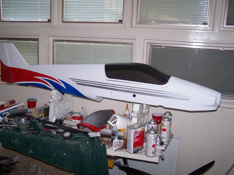

Well guys this is the first of two Black Magics that I'll be painting in the next couple of weeks (weather permitting). I just couldn't resist to post some before pics. This one is totally glassed and ready to prime. I liked to paint stands that I saw on the last page and made a few slights mods of my own. I didn't see the point of making two more stands when I could just use the ones I made for the lasers and just cover up the lazers when I'm shooting paint. I'll keep you guys posted on the finishing so wishme luck.... it'll be m first time painting!!
Rick
