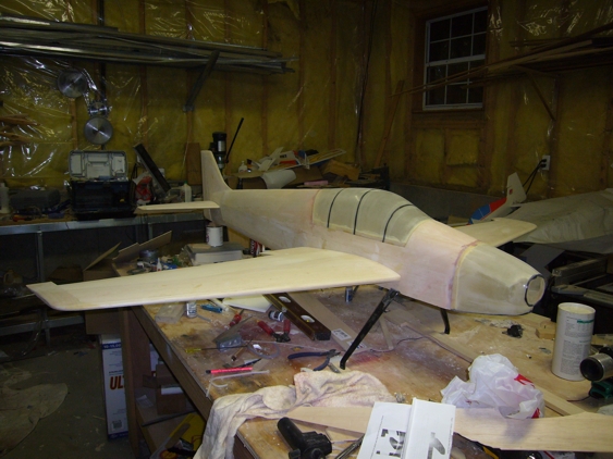

Well here is another V2. Been working on it off and on but almost ready for glassing and covering. I am determined not to let any other projects get in front untill it is complete.
Dan

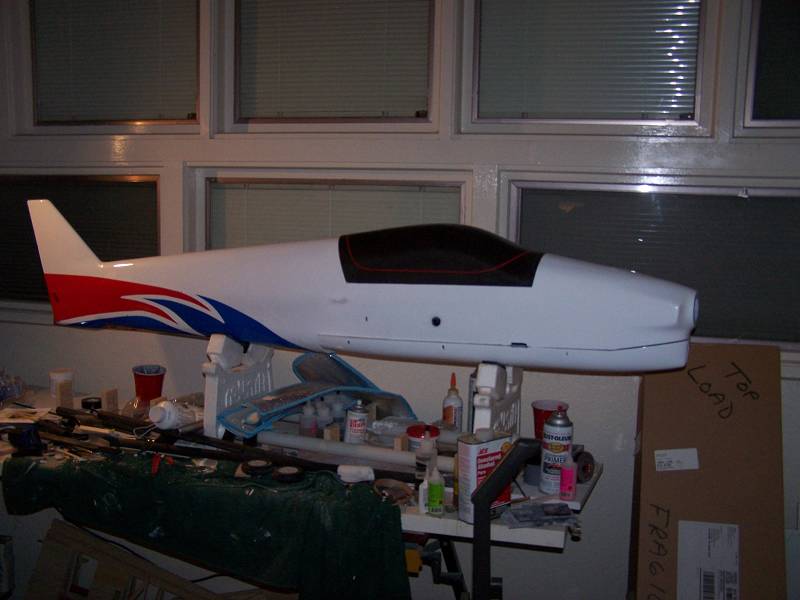

Hi All,

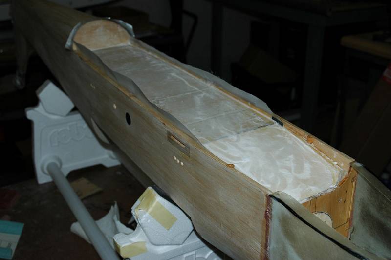

just completed fiber-glassing my Black magic. I have to tell you guys that have never done this type of finish, so far it's been super easy. okay a bit time consuming but really very easy. Mike suggests letting the everything cure for a week before I can start more sanding and priming - but the fiberglass is on and everything looks great.
Over the next couple weeks as time allows I hope to cover my wings and stabs in monokote while I am sanding, priming and painting the fuselage. It's been on and off again with this project for almost a year now. But I am getting real close now.
I have spent a lot of time designing my trim scheme for tis bird. I am really starting to get anxious now.... can't wait to start shooting paint : )

Hi all,

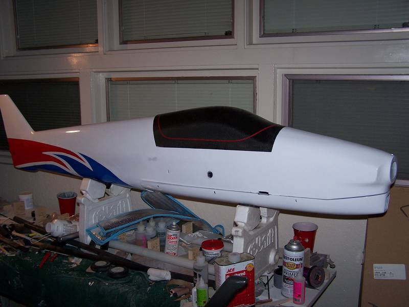

I finished fiber-glassing my build and trimmed it this morning. Now I am going to let it cure for a week before i start sanding. The complete fuselage after fiber glassing weighs 3 lbs .1 ounces - compare that to my weight back on page 18 of this thread of 2 lbs 12.5 oz - for a net gain of 3 .6 oz.
now I did not weigh the fuse right before I did the fiber-glassing and I did a lot of sanding since where I was at on page 18 - but I think a net gain of 3.6 oz is outstanding... I should be able to sand off at least one full ounce, maybe more before priming.
I did double check my scales. I am just real happy my completed fuse is at 3 lbs....
wow - that was worth getting up at 6:30 am too !!!!
I am just amazed at how easy this project has been. I asked Mike the other day "where is the hard stuff".
this project has been a dream so far : )
#858
Posts: 2,707
From: Woodstock, GA
I just happen to have some exact numbers.
These are weights of the raw fuselages, before any filler. No canopy or belly pan, No engine mount, just the raw fuse with everything done and ready to fill and glass.
M1- 25.4 ounces
M2- 26.6 ounces
E1- 25.8 ounces
E2- 25.8 ounces
After filling, sealing, glassing and sanding, ready for primer:
M1- 30.2 ounces
M2- 30.3 ounces
E1- 28.3 ounces
E2- 28.7 ounces
Painiting added about 3 ounces with clear. 2 ounces on the electric. Those numbers, I don't have written down, that's just from memory. I know that if you don't rub with micro balloons, it's a few ounces more.
BTW your planes look fantastic guys!!!
-Mike

It is automotive white paint. A single stage paint. The plane was glassed, filled with spackling, primered then sealed and painted. The pictures do not do the planes finish justice. I do not take very good pictures. There were some runs in the paint. You can see one on the side. It was sanded out and a grey stripe will be painted over it. The plane is very shinny. It still will be buffed and waxed for an even deeper look on the paint.

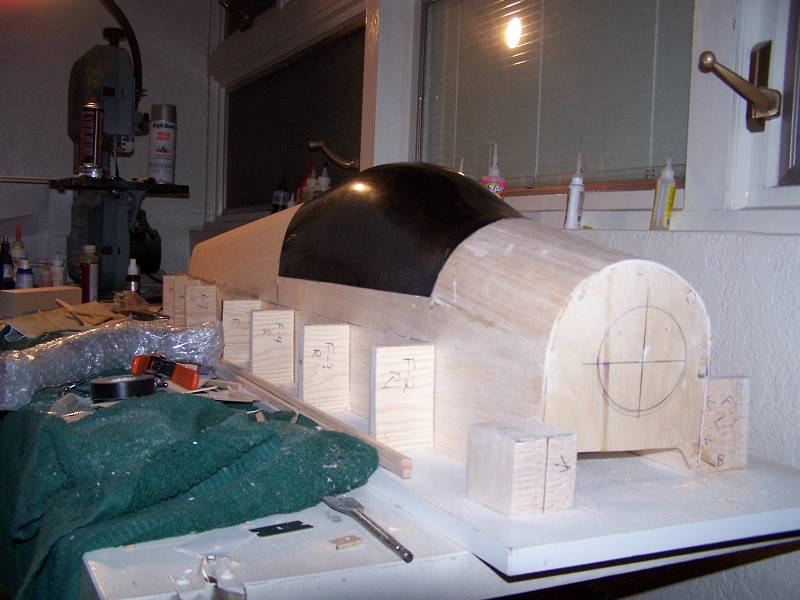

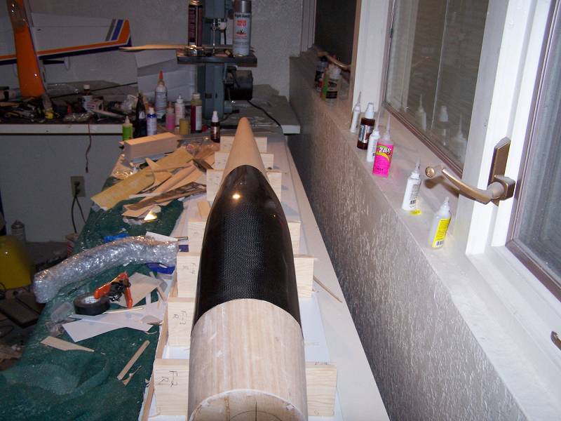

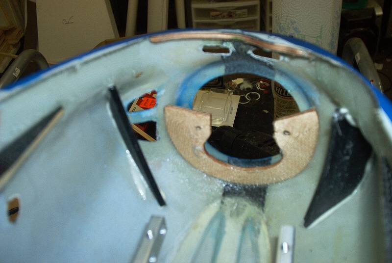

Nose ring former
I thought I'd add a little detail to using a nose ring former. I installed one in my current plane after the fact, and it was a piece of cake. The key here is 80 grit sandpaper and pateince.
If you're installing one from the start, here's how.
First line up your nose ring with the tabs on the former. This first picture isn't absolutely accurate, you need to move the holes closer to the solid side of the former. Not TOO much, but a little.
Mark and drill your holes, and mount the nose ring to the former.
TIP: If you're using a YS engine and a central hobbies nose ring, the nose ring is too tight!!!!! Use a dremel sanding drum and carefully remove some of the O ring until it is a slip fit on the front of the engine. It should be snug, but you should be able to slide it on and off without using power tools!!! When I first installed mine, I noticed a LOT of vibration. I killed 2 sets of servos, a wing adjuster, my wing and stab hard points and a few other things before I had a long talk with Merle Hyde and came to the conclusion that my nose ring was too tight, and just transferring vibration through the nose ring former directly into the air frame. After loosening it up a bit, it's SMOOOOOOTH and no detectable wear on anything. This is important guys.
Mount the engine to the firewall, and install the nose ring and former on the engine itself. The distance from the thrust washer to the former should be 6 3/8" or very close to it. Use spacers behind the engine mount if you have to. Trim 3/8" from the back of the cowl (the mounting flange). Clean the cowl with soap and water, acetone, alcohol, wax remover, throw everything at it. This mold release is pretty aggressive, so you have to get it ALL off. Once it's clean, rough up the mounting areas with 80 grit paper and clean again.
Using the tips I showed earlier in this thread, sand a lip on the front flange of the fuselage to accept the cowl flush. Now install your cowl, and check the fit. Suprise! Sanding time.
All you do from here is use 80 grit paper on a solid or 3m curved type sanding block and remove material from the nose ring former until it aligns in the center.
Use your spinner backplate to get your cowl lined up. Be careful to mate the former as far forward as it will go without getting into the thrust washer. The further back it is, the more you get into the funky curve of the cowl cheeks. So, keep it forward. When you have a good idea of where the former will be glued, remove the cowl and rough up the are a with 80 grit paper, and clean with acetone.
When you're satisfied with the fit (you should be even around the spinner and have about 1/16" of clearance) it's time to glue it on. Mix up some 30 minute epoxy and light micro balloons (don't use a lot, jut enough to turn it white and thicken it slightly). Now apply a bead around the mounting flange of the cowl and a small but thick bead on the edge of the nose ring former. Put everything in place and use tape to secure it. Wipe away the excess with a paper towel. Walk away and let it cure before removing anything.
After at least a 3-4 hour cure, remove the engine. Cut some small strips of either 4 ounce carbon or glass and glass in the former. Let it overlap, just get a good nice seamless bond at the corner where the former meets the cowl. This will spread the stress and keep your cowl in one piece.
When everything is cured overnight, trim and you're done.
