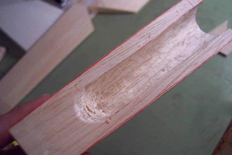

Way back on page 14 post #329 (Man, I have read this thing too many times) you have pictures of the elevators and mention cutting off the inboard corners and installing a solid piece of balsa. Is this to put a hard point in later for the control horn? This block is sanded to shape and then capped in place? Sorry, just a little fuzzy on the process and guess where I am up to. A rainy weekend coming so I hope to get a lot done!
Old 01-12-2007 | 11:33 PM

Yes, that's exactly how you do it Anthony. Easy stuff.
You can also put the block in place before you sheet it, and that is probably a little stronger. But the ones I'm flying are done like that in the pic, and they have zero wear, zero play, just as stiff.
-Mike

Thanks Mike, once I looked a little more closely at the pictures it made sense. Wich way should the grain go on the block? Do you do the same with the rudder or put a dowel in befoe you sheet?

The grain on the block is sort of irrelavent in this application. I run it span-wise, side to side.
The rudder dowel is easy, just pick up most of the hinge facing and you're good to go. I install blocks underneath the skins sometimes, sometimes not. It depends.
-Mike

Ok, an attempt at some progress photos. Things have slowed down a little since classes have started but still making headway.
Tail alignment done.
V2 versus V2.2 rudder 1/2" longer and 3/4" taller. Must have grabbed some heavy wood because it is 10 grams heavier.
Carved out tail block. Easily done with some patients and a piece of brass tubing.
Now just filler blocks and sanding remain!
Ok somebody pm me and let me know whether you see the upper or lower photos

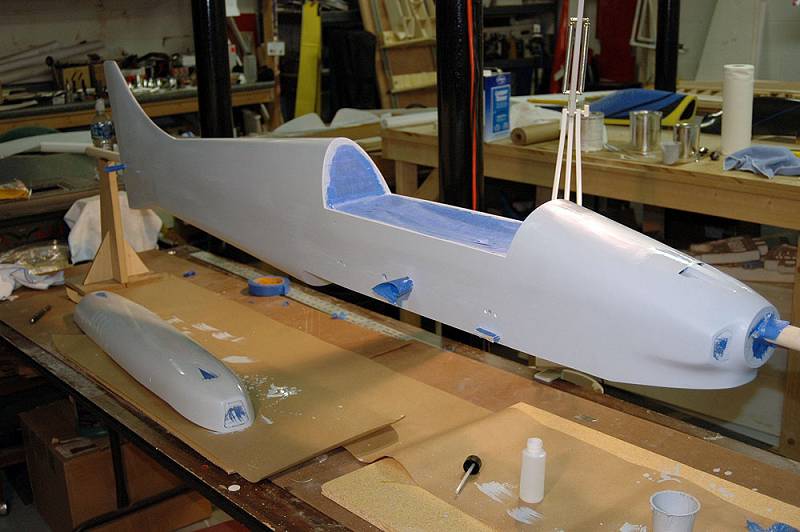

pics of my priming stage and the painting rack I made, copied from Mikes.......

Great paint rack. Should be a Kfactor article! Details on how the plane is held at each end please!

Hi Anthony,
I will when I get a little time later this week. Busy doing final primer coats today.....
