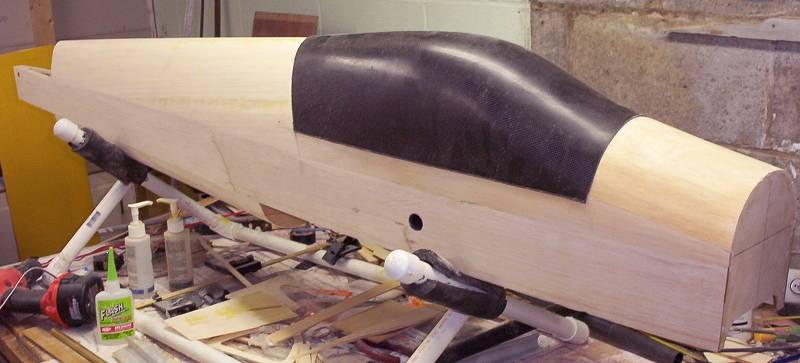

I'm getting ready to sheet the nose of the fuse between te canopy and firewall. I am considering doing it with three piexes of 1./8" as opposed to stick sheeting like you did. Any thoughts on it before I do it?
Old 05-15-2007 | 09:52 PM
  #1158
My Feedback: (12)
Joined: Feb 2003
Posts: 638
From: Madison, AL
Default RE: Black Magic v2 builder's thread! *Updated*
I glued two sheets of 1/8" balsa together with CA, soaked one side with ammonia and water, and wrapped it around the outside of my ammonia bottle which had about the same radius of the top of the nose. Held it in place with rubber bands. Let it dry overnight on the bottle, and it worked great after I trimmed it to fit.
Jon

Yeah I did basically the same thing as Jon. I used Ambroid cement because it's water proof and sands easily (better than CA). I didn't even use ammonia, just warm water. I taped mine around an empty fuel bottle and let it sit overnight. It came out great. Since I'm planning on covering the fuse with Monokote, not fiberglass I didn't want to have all the lines from gluing strips in there.

I really don't think strip planking would buy much since we are using 1/8" unless you are really heavy handed starting your plane. I used three pieces of 1/8" to do the front on this one.
Anyway, the more I work on it the more it looks like a plane...amazing how that works.
Next on my agenda is to build a fixture to drill the engine mount holes so the mount aligns with the reinforcment on the back of the firewall.

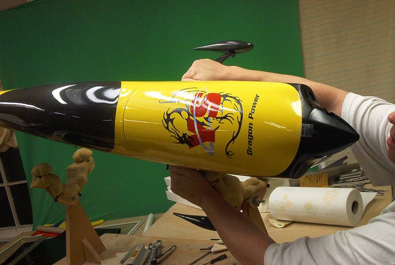

for all my OS friends, I've made a OS version of my Dragon. I am cutting a couple as we speak....
here is my flat cutter file, I'll have some examples soon....
You want one John, just ask bro !!!!!
Old 05-25-2007 | 08:38 AM
  #1168
MHester's Avatar
Posts: 2,707
From: Woodstock, GA
And the "real one" is freakin gorgeous.........
-Mike
