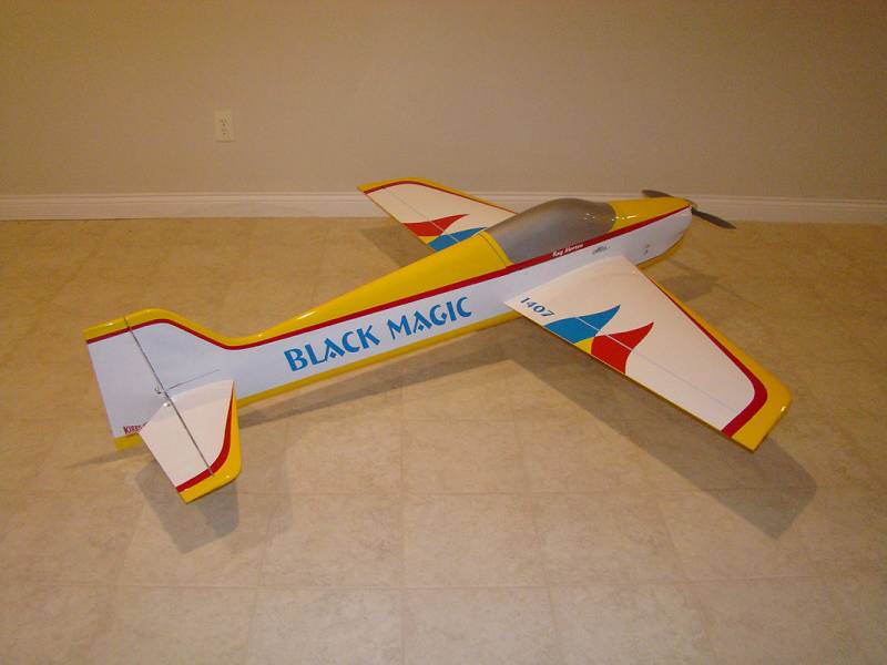

Finally after over a year my first BM V2.2+ is ready to go see my friend Buddy to get covered in Ultracote. As you can see I added a cap to the vertical fin like the VF3. Mike isn't sure if it will help or hurt but I can always cut it off if it is a problem. Also, since I am not glassing and painting mine I opted to make my cowl removable so I get to the engine more easily.
Now to get number two on the bench and finished. Hopefully that will prove easier since my son is almost two....he has been my major project for the past year and a half so airplanes came in a very distant second.

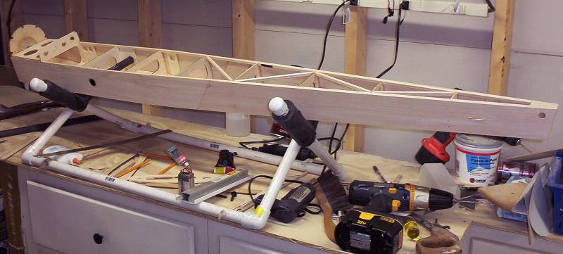

And here is the crutch for #2 on the dirty bench getting ready to make the move to other banch and get worked on.
I have the turtle decks and stabs already sheeted and the wings are ready to sheet as well as the sheeting is already cut and ready to go. will probably put the vacuum to it tomorrow. Hopefully I'll have two ready to fly by June. It's a;lways easier to do after you get one done.....

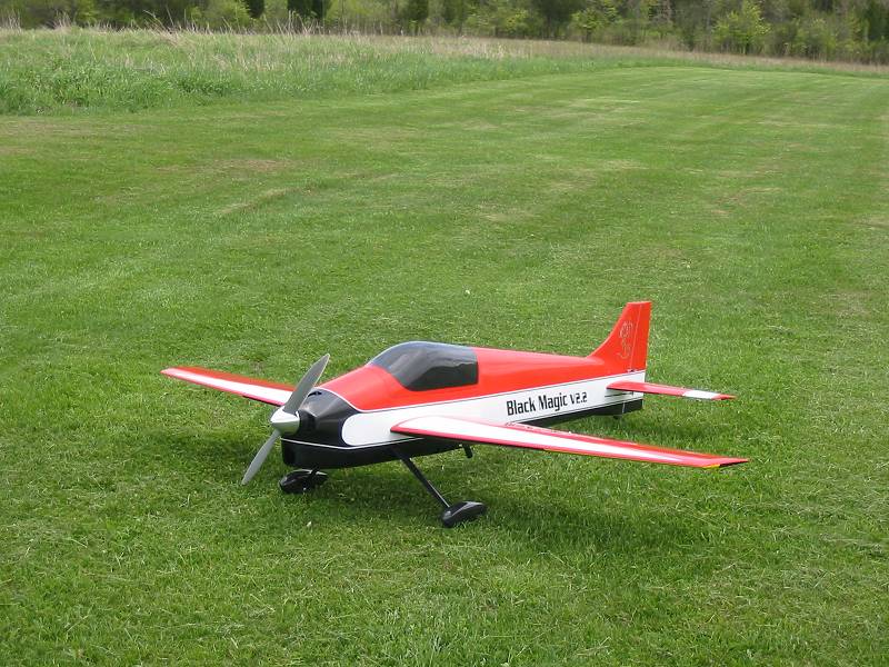

OK, I know it's been a while but here's my V2.2. Power is an OS 160 w/ Aeroslave pipe and APC 18.1x10. I see about 7900 RPM on the ground with this setup. Plenty of power as mine came out at 10lbs., 6.9oz. Finish is Monokote on the wings and stab's with Nelson Urethane on the fuse and rudder (yeah I PAINTED the rudder!). The fuse and rudder are covered with silkspan not fiberglass. It's hard to see from this picture but the wings are actually one piece of white and ONE piece of red Monokote. The white went on first. The red is one sheet with a "window" cut out. The overlap is 1/8 +/- 1/32 of an inch. I'll never do THAT again! LOL Landing gear is Bolly F3a wide with carbon spats. Now on to my VF-3 project...
John Pavlick
BTW - This plane flies on rails. I hear the VF-3 is even better but right now that's hard to imagine.

That is one SWEET plane. You should see some of the close up pics....awesome work! And not even done in the Southeast <vbg>
Yes, the VF3 is better...LOL But it's apples and oranges. This plane is more of a pure "tracker", the 3 flies a bit slower and is much more graceful, if you can envision that. Well you'll see in a couple months when you fly mine.
Still, every once in a while I fly someone's V2 and it's like that glove still fits. it's still an awesome plane, just not the best for KE loops and such. It'll do them, just more pilot load.

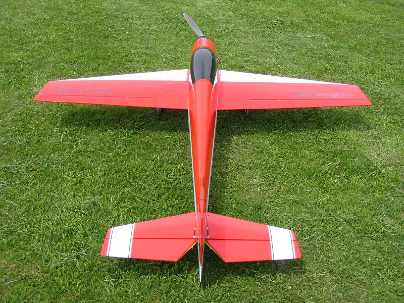

Here is a picture of another V2, it flies very well.
Ray

That picture doesn't do Ray's plane justice. The paint is FLAWLESS! Definately one of the nicest builds I've ever seen!

That is pretty! Nice job Ray! What kind of paint did you use? I think my next one will be PPG. The water-based Urethane is really tricky to apply. Of course you can shoot that stuff in your basement with no danger whereas with PPG you need to take some precautions.

Thank you, it was PPG Concept with the expert painting help of Bob Pannell and his paint booth in his basement. You are right about the precautions with this paint. I am now looking forward to finishing a couple more. After flying an ARF for a few years it was nice to build and finish an airplane again.
