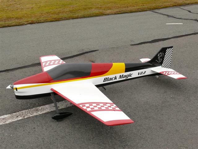

Mike and Dean: Flew the Black Magic yesterday,so am enclosing a few photos.
The decals are by Dean (Handglider) and are excellent. I highly recomment him.
Weight is 10 lbs,2 oz,fuse is painted,film is Ultracote.

Hey Dave,
That is a sweet looking bird!

That's nice!! Flight report?

I had only one flight,but will give a detailed report when and if the weather permits. I can say it rolls very nicely,and very little rudder required for knife edge. Inside loop tracking seemed right on.
Wasn't feeling in top shape,so didn't stay long.

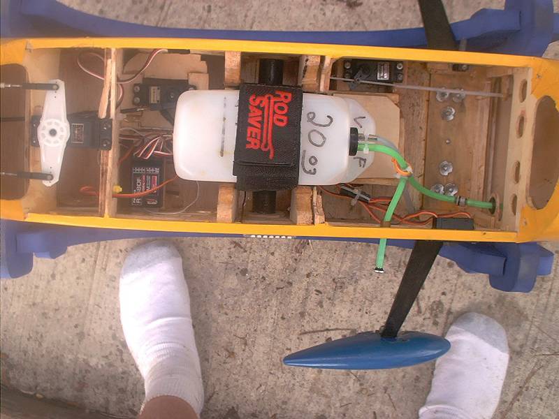

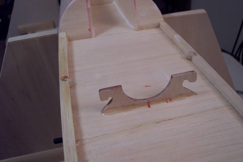

Ever so slowwwwlllyy progress is being made. Responsibilities just eat up too much of my free time. This is my pipe mount with a piece of split fuel tubing over it. Two hardware store O rings since I haven't found any big enough to use just one. Needed something low enough to fit in the belly pan.
What is the consensus on fuel tank mounts? Mike, I like the rubber band idea but wasn't there some issues with that? If not what where the cross piece made from? I hope the tank centers. In my preliminary fitting the canopy pushes the tank off center.

ok here's the scoop on the tank mounts and battery trays for the E birds, listen up because the VF3 is the same way....
These planes snap HARD. I'd love to put a data logger in one on a negative snap, because every time we've broken something loose, it was in a negative snap. My guess is 16+ Gs....I did one at Andersonville last year that had to be over 20. Ask anybody that was there. Instant 45 down negative blender in a split second. LOL
Bottom line, however you mount the tank, make SURE it's solid. I used a tank tray mounted to (2) 3/8"x1/4" rails, vertically mounted, with a carbon strip bonded top and bottom. Then I used 18" velcro straps with buckles to secure the tank. That's the only system I couldn't break, but it did break loose in the VF3 until we made a piece that captured the tray top and bottom. This is pretty critical, because if it comes loose in a snap, you'll damage that pretty canopy.

Be more specific in the tank issue? Did you cut away the front cross piece of the canopy frame?

Thanks for the quick reply. Have to look more closely at it but when I quickly put the tank in and the canopy on I couldn't get the tank as far forward as I would have liked. Does that front cross piece come out? I thought that was to give the frame some rigidity.

It is, until the canopy itself is bonded, then cut it out.

Maybe these tank pitures will help.

OMG! If you ever throw that tank, i fear for those around you. That is the beauty of wood, you can put in an 8 oz fuel tank mount and still make weight!
Interesting to see all the different setups you can run with in the Black Magic, goes to show that there is no ONE magic way to do something eh.

HI Dave,
Your plane looks great and thanks for the kind words about my graphics - looks like they fit just right. I do like your paint job, I have be designing a scheme with a similar nose stripe. You may see it soon.
thanks, Dean
