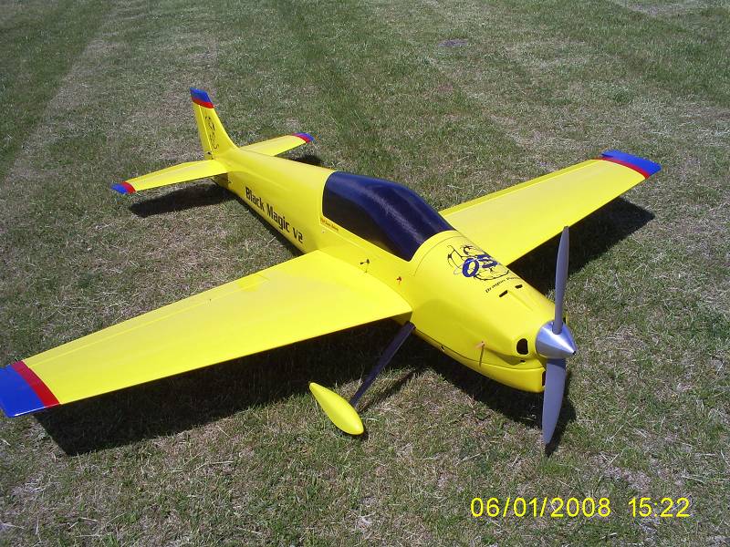

Sure hope this worked, if not, I'll have to try it again later.

Had 0 degrees on the wing and 1 degree pos on the stab.
Now have 1/2 degree pos on the wing and 0 degrees on the stab. Cut the aileron throws to 12 degrees. only had a inch and a half throw on the rudder. went to two inches. Much Much better. Also put the battery pack behind the firewall instead of under the wing tube. Hopefully you enjoyed the pictures. told you it was yellow.

Dennis,
You were right about it being yellow. Sounds like you are moving in the right direction with the incidence and CG. After the strong, gusty crosswinds in Columbus, I am also moving my CG forward. Now a little more trimming and practice before the Shootout, I am glad you will be able to make it.

Dennis,
That looks pretty good. Glad you found the trim problem. That must have felt pretty weird the way you had it set up originally. I bet it flies a lot better now. When you get everything right you should need ony a slight amount of rudder - (up) elevator mix to clean up the knife edge. Don't try to fix it all with the C.G. Depending on how much the plane weighs, you may need a little more or a little less incidence in the wing to fine tune your uplines and downlines. I was able to get rid of any pull to the canopy on uplines and downlines with just a little more positive in the wing. My plane weighs 10 lbs, 6.9 oz. YMMV.
