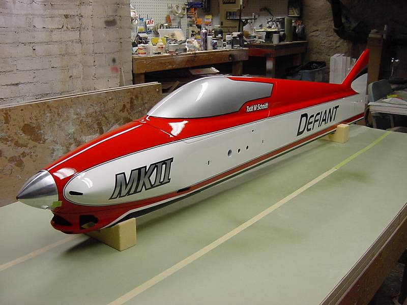

Finally got some paint on. Kind of plain, but heck, it's July and this bird needs to get in the air!
Todd

ORIGINAL: tschmidt
Todd
It's not "plain", it's elegant, classic, understated. Gorgeous, too. Looking great, Todd. Now you need to finish and get a flight report posted.
Mark

Default RE: Defiant MKII
Hey Todd,
Really like the newest paint scheme!! Hardly a plain looking fuselage!! That is going to be one GREAT looking model...Have you come up with a design for the wings/stab as yet??
Real looker in the design and now the paint job!! Charlie

Thanks Mark and Charlie,
I'm ready to have this thing done!!! Been a hard long haul since November... Haven't quite got the details worked out for the wing and stab, but probably will be similar to the fin and rudder. Going to be simple for sure .

That will look outstanding with the wings/stab in the same pattern and easy to find in the sky too!!
Hope to have the Brio at Columbia IF all goes well...and gas doesn't hit 4.00 a gallon!!
But outstanding work there Todd!! Charlie

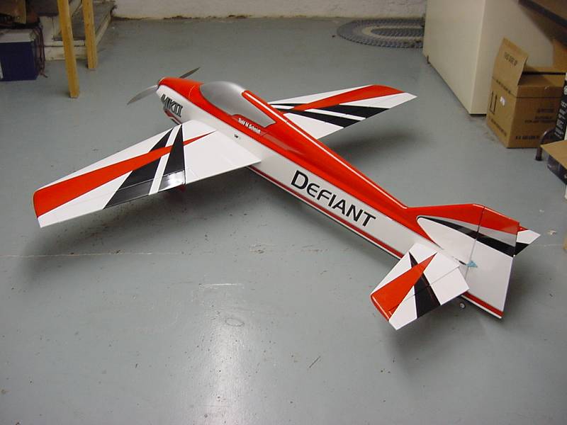

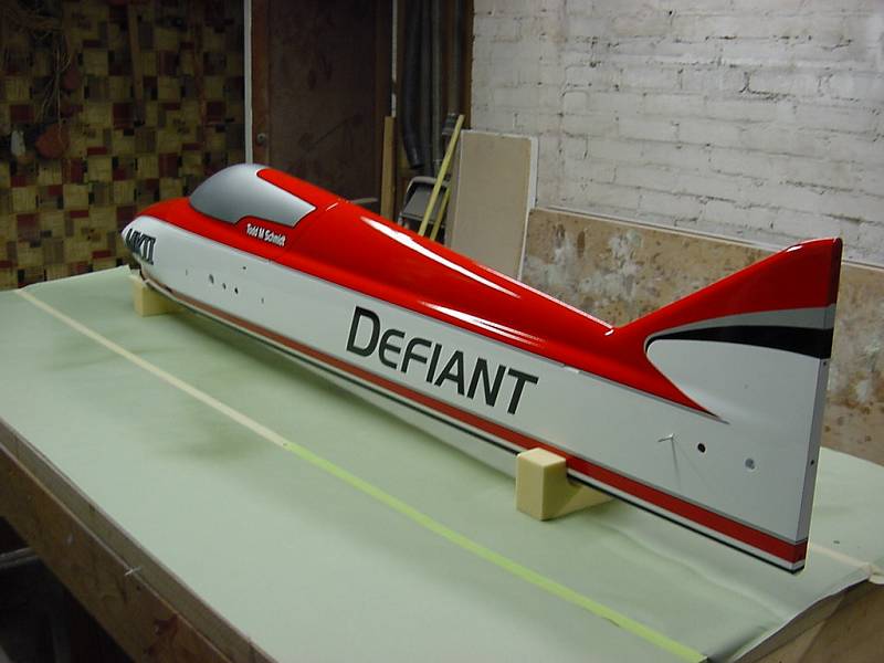

Pretty much done! Have a few minor details left but should be able to put her in the air very soon.
Was hoping to take her to the Columbia contest this coming weekend, but with no test flight she'll have to stay home.
Thanks everyone for your comments during this long build. It kept me inspired to keep moving forward. I started making the mold plug first of November 05 and now almost August 06. I'm tired and ready to relax with some flying!!
I'll give a flight report as soon as I can!
Todd

Todd,
Really like the newest wing scheme! What did you do for the bottom portion of the wings/stab?? Can't wait to see in person though, won't be at Columbia this WE...
Nice job though, you are very talented at this!! Second job! :-)) Charlie

Thanks everyone for your kind words.
atvracer, man your right, the scheme does look a lot like the hitec logo. No hitec equipment in the plane though. After putting the scheme on the plane, I realized it's a lot like the Reebok shoe logo too.
Greg and Tom, I don't know at this time if I'll make kits or not. It will depend on how the plane flys and more importantly if I can produce kit components up to the standards we all desire. This fuselage was not to good, but I know what I did wrong (I hot box dried the fuselage). This caused some defects in the kevlar that had to be addressed in the finish stage. The fuse started heavy at 33oz, mainly because I got carried away with primer in the mold. I used way to much and sanded a lot off. The plane finished comes to 10 pounds 12oz. (good windy weather plane). This is with a solid 3.5" spinner back plate and the big heavy tru turn adapter, so some weight may be able to come off depending on CG.
The plane has some width and girth to it. Widest point is 7.5" at the leading edge of the wing. Total girth at the highest point of the fuse is 33" if I remember correctly.
I'm contemplating trying a glass/balsa/glass laminate in future layups. I'd like to get away from kevlar due cost and it's not the friendliest material to work with. Plan on trying this after contest season over.
Thanks again everyone!
Todd
