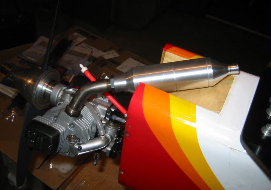

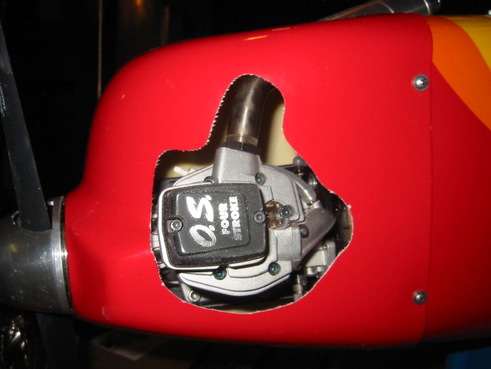

I purchased a used Venus II this month and have flown it several times so far and like it a lot. I bought it with everything but an engine and receiver, and stuck a new shiney OS 120 FS pumper in it which I think is perfect for this plane. The low end torque seems to pull the plane through verticals and loops at half to three quarters throttle and I am really think for me, a beginner who wants to get into pattern flying, it'll be fine for a while. I do also want an electric plane similar in size or a little larger some time next year, maybe a Wind S Pro! I can dream, can't I?
Anyway, I have a question right off the bat. I was given two cut cowls and a brand new cowl with the Venus II. The two cut cowls were cut for different engines so they have excessive cutaways at some points and not enough in others. So I mounted the cowl that was closest and did a decent job cutting away an area for the exhaust pipe. I taped areas of cardboard over the excessively cut areas. Now, I want to use that cut cowl as a template and trace what I need on the new cowl.
The question is, both the cut cowls have a large cutout on the bottom for what I think is airflow. How large of an opening do I need, if at all, on the bottom of the cowl. I'm attaching some pictures for clarity. Thanks in advance!!

The cylinder is totally outside the cowl so you do not need any air exit in the bottom of the cowl.
If the cylinder was inside the cowl the rule of thumb is the air exit needs to be 2 times larger then the inlet.

Okay, so if I make the hole smaller than the one shown in my picture, but the cylinder head is still sticking out, which it will be, you're saying I don't need any cut out underneath the engine? That'd be great - a nice clean look!

Correct, bit of course you need a cutout for the muffler, so there will still be a small hole in bottom.

That plane originally had an OS 120AX mounted on it. The bottom cutaway is to fit the big box muffler. There are pics in this thread if you want to see it. You will need to cut out some to fit around your muffler, and also to make sure the cowl fits around the fuse/firewall - it's a tight fit.
Also, the engine was pushed back closer to the firewall to help the CG. Because of this, excess material has to be removed from the bottom to allow the cowl to spread out a little.
Making a template out of another cowl doesn't work as easily as we'd like it to, since they aren't made to stack that way. If you do it that way, make sure you cut inside your lines, fit everything up and make adjustments.
I wouldn't worry too much about cutting holes for cooling until you've got it properly mounted and tested out. You can always cut more later, but putting material back isn't easy.

I'll post pics on the resulting new cowl. I think it'll work out fine. The only thing is, I really don't need to cut much if anything from the bottom of the cowl and the part of the muffler that extends beneath the plane is behind the cowl pretty much. SO I won't have any air flow around the engine. I guess that's okay though. I have a temperature gauge so I can check the temperature without the cowl immediately after a flight and again with it, the same way.

I think it would be wise to measure the distance to the front of the cowl, remove the engine, and try dry-fitting the new cowl over the firewall to the appropriate location. See if it will in fact slide on far enough without being cut. If not, you have to remove material from the bottom of the cowl. I know I'm not the first one who had to do that to make a VII cowl fit.

This morning I cut the new cowel for my Venus II. Came out pretty good and I think I'll get plenty of air flow through. I cut a slot larger than necessary for the muffler on the bottom to make sure I have adequate cooling. Got a couple knicks in the fiberglass and plan on painting with a nail polish the same color. Also, wish I had worn a long sleeves and put on my respirator as the fine fiberglass dust went all over the place and it itches

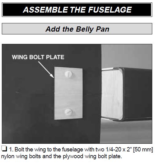

Has anyone had any problem with the wing not mounting securely to the fuse on their Venus II? I have had several people comment on how the wing looks loose and sure enough when checked it can be wiggled fairly easily both side to side and up and down, albeit by a small amount.
Also, is the mounting plate with the blind nuts supposed to be gapped underneath the wing? I've had a couple people tell me that my plate should be up higher so it contacts the wing instead of recessed a way down the way it is, and that this might be part of the reason the wing can be wiggled.
Last, how tight can those nylon bolts be tightened before stripping them? I'm using a large screwdriver and tightening as tight as I can without exerting enough torque where I feel it would strip the threads. Is there a torque rating on the bolts? Thanks in advance.
#1344
My Feedback: (8)
I tighten the nylon bolts until I feel them just start to snug up, then one more 1/4 turn. You don't want them to stretch. Are both bolts definitely finding the holes? I definitely did NOT have a problem with wings being loose when I had the plane, I am 100% sure about that.
If it's wiggling up and down there is definitely something wrong - something's not bolting in right.

I'm 100 percent sure the bolts are in the threads correctly, and their is significant torque applied to the wing bolts, just shy of stripping, I'm very confident of that as well.
You'd have to see what I'm talking about in person. Maybe I'll shoot a video and post it here. It's not rocking up and down to the point most people would even notice it. It's something you can see from the vibration of the plane when running. The wing has no mounting plate on the bottom of my wing, as shown in the manual, unless it's recessed under the covering and I cannot see it. Like I say, there's a gap between the bottom of the wing and the mounting holes, and that doesn't seem right. The assembly manual shows something that looks like a mounting plate that would fit in this gap, but I'm probably interpretting it incorrectly. Nonetheless, the wing does move IF you apply slight pressure at the wing tips fore and aft. I wish I knew how to eliminate it. It would seem a couple dowels in the wing bottom and through the fuse would 'lock' the wing in place so it couldn't be pushed to move at the wing tips.
#1346
My Feedback: (8)
The wing bolt plate is on the other side of the wings, under the belly pan. It's there.
Having the space between the mounting holes lets the wing secure to the sides of the fuse, and not to a point in the center of the plane. This would give it a little more stability and ensure there is no gap between the plane and the wings.
Maybe you could try a new set of bolts? Maybe they got stretched or stripped? It shouldn't take much force to screw them down, and as soon as you start to feel resistance, stop.

cappaj1, just to double check, when you assembled your wing, did you put that plywood wing bolt plate on before gluing on the belly pan? If you did not, then the nylon bolts would be digging in to the soft balsa wood of the wing. Hope what I typed makes sense. Let me know if you want me to elaborate.
