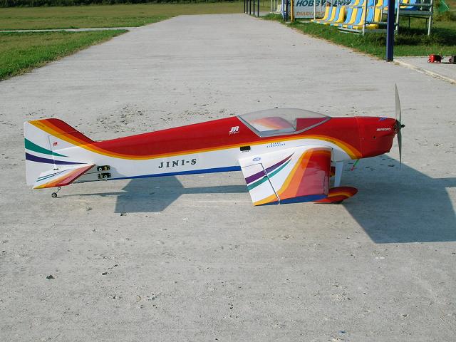

Yesterday I first flew Venus, I had about 10 flights (1 gallon of Cool Power[]) and I am pretty satisfied by the performance of both the plane and the YS-140. During the first flight the plane seemed to be nose heavy so I put around 1.2 oz (35gr) weight at the tail, it still is nose heavy but I would not rather to add any extra weight. I will try to remove the battery further back.
Some notes:
- The plane rolls very well and knife edge perfromance is brilliant. Coupling is nearly non existent even in slow/high alpha knife edge
- Snaps are crisp and predictable, I thoughy I was incompetent flying snaps precisely but with this plane I don't feel the same
- It seems to be pretty slow in the downlines and general gives the impression of constant speed in the box
- The YS-140 is a very good match for flying in a big box, I wouldn't put something less powerful, throttle management is the key though.
- Control surfaces are very effective so if you want it for pattern keep your throws to the recommended range. I have set three modes: Normal (recommended large throws), Snap Mode and Spin Mode
- The plane did not seem to be influenced by the wind of around 20Km nearly 3bft
For the price the plane takes 9.9/10
Here are some photos.

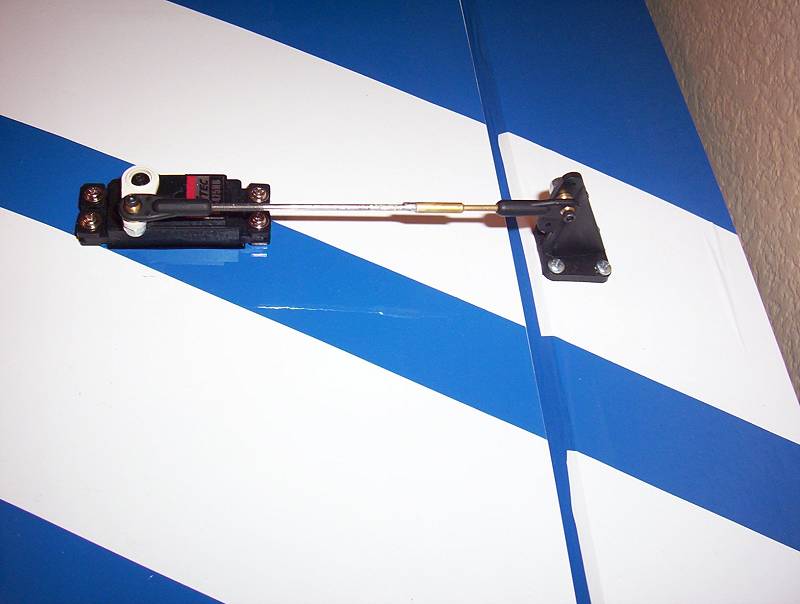

It won't ! Can't image why you would want to do this. I have an OS 120 up front and servos in the rear. It is a bit nose heavy still.

I really don't care for servos being exposed to the exterior of a model. It seems to take away some of their beauty IMHO.
If it won't balance as I have described, I guess I am stuck with it. I have the Venus .40 with all servos in the fuse as instructed. I guessed her big sister would be the same. That is what you get when you don't do your homework. I should have bought something else I suppose. What a shame. Thanks for your feedback.

I don't see why you could not cut a hatch into the bottom
rear and install your batteries back there.
Then you could place your servo's inside.

The plane will come nose heavy if you place the servos upfront. Please have a look at my setup and comments above if you want, YS-140 that I use has similar or less weight than YS-120. Mine has come nose heavy with the servos at the tail and the battery to the rear tray.

IMHO the control would be much more precise with the shorter more ridgid rear mounted linkage. I considered putting my servos up front also but when I saw the flex in the loooong rods it was a no brainer.
Besides I always apply the 50 / 50 rule. At 50 feet and 50 mph no one can tell the difference.
