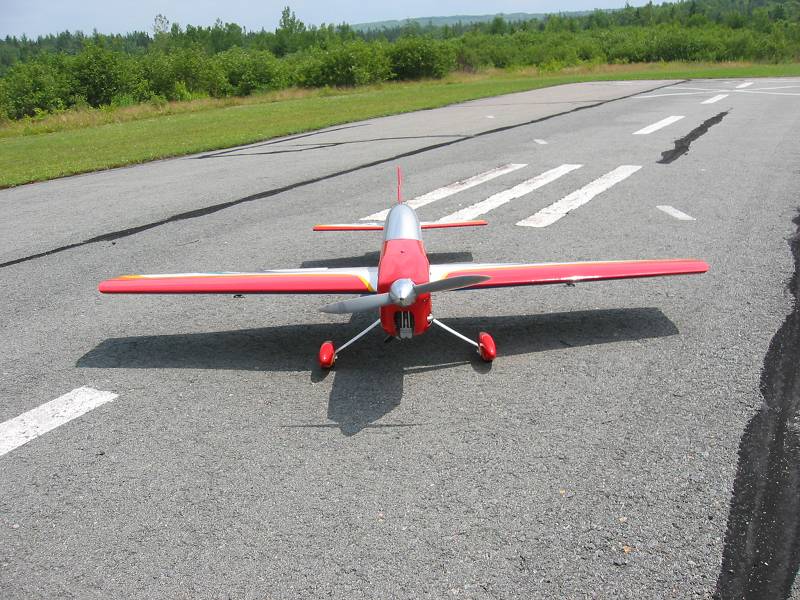

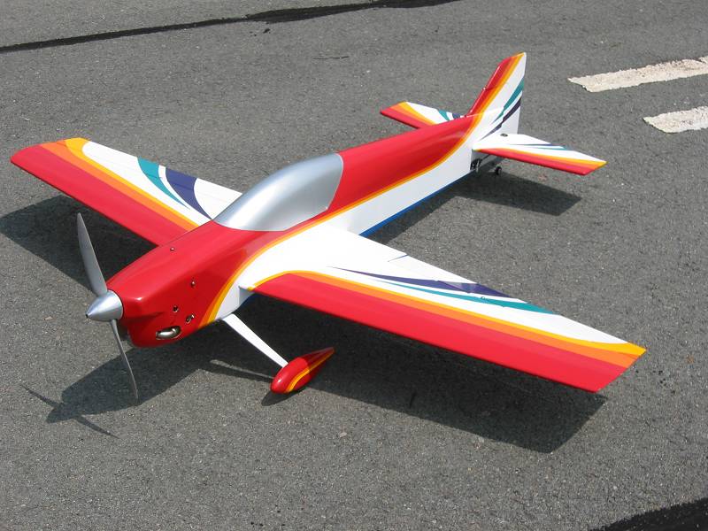

I have put about 150 flights on my Venus 11 over the last 2 months and have to say that it is the best flying sport / pattern plane I have had in 20 years. My set up is an OS 120FS, weighs 8.5 lbs. and has unlimited vertical with a 15 - 8 APC. I started out with a Saito 125 but it was so sick and used so much fuel I pulled it and sent it to Horizon. It has been returned with a few new parts ( warranty ) but the OS works so good it will stay in it.
To the guy above who wants to run a Evolution 26cc in it all I can say is you won't be happy. I just sold a MVVS 26cc and they weigh 55 ozs. with a tuned pipe, battery etc. If you run without a pipe you will lose toooo much power. Yes they are advertised at 32 ozs. but that is BARE weight.

I've noticed you installed the servos at the tail, how does the model balance with the OS-120? I plan to do the same that's why asking.

Actually it is still a bit nose heavy. I have the battery as far back as I can get it without modifications. It flies fine that way, it just needs a bit too much down elevator inverted for my liking. I replaced the steel pushrods with CF ones. Not sure if that is lighter or heavier. Also as you can see I have an OS flex pipe on the engine which may add 1 - 2 ozs. in the nose. Whatever you do the 120 FS with the rear servos will be fine.

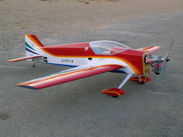

Hi guys,
Venus (Jini-S)is finally ready to go, I just need to install the cowl and check some minor things. The plane balances ok with the YS-140 FZ which is a beast in terms of power but not weight. Battery has been located just behind the recommended Rx position. Tank is located at the CG region.
My setup is as follows:
- Engine YS-140 FZ turning an APC 15x12 prop with std muffler set
- Gator Soft Mount
- Tetra 16 oz high pressure tank
- JR NES-4131 on elevator and ailerons, JR NES-4721 on Rudder, JR NES-321 on throttle
- JR 10ch PCM synthesized Rx 10DS and JR heavy duty switch
- JR 1400 mAh NiCd
- Sullivan 4-40 pushrods everywhere I did not trust that soldering illustrated in the manual.
It seems very promising and now that has been assembled I like it more, let's hope that it will fly as good.

That is absolutely crazy putting that engine in it, you need some professional help [X(] I love it

Thanks for the mental help...
Throttle management is the key...and proper adjustment of the throttle curve. On Saturday I will maiden it so I will write a brief flight report and trmming notes.
