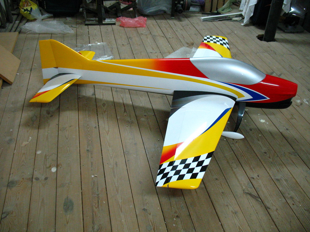

I am working on my new ZN scheme Integral,
I know all about the risks when using ball links so I will use Dubro Safety Lock Kwik Link.
What kind and size of pushrods is recommended for ailerons and elevator?
Thanks in advance

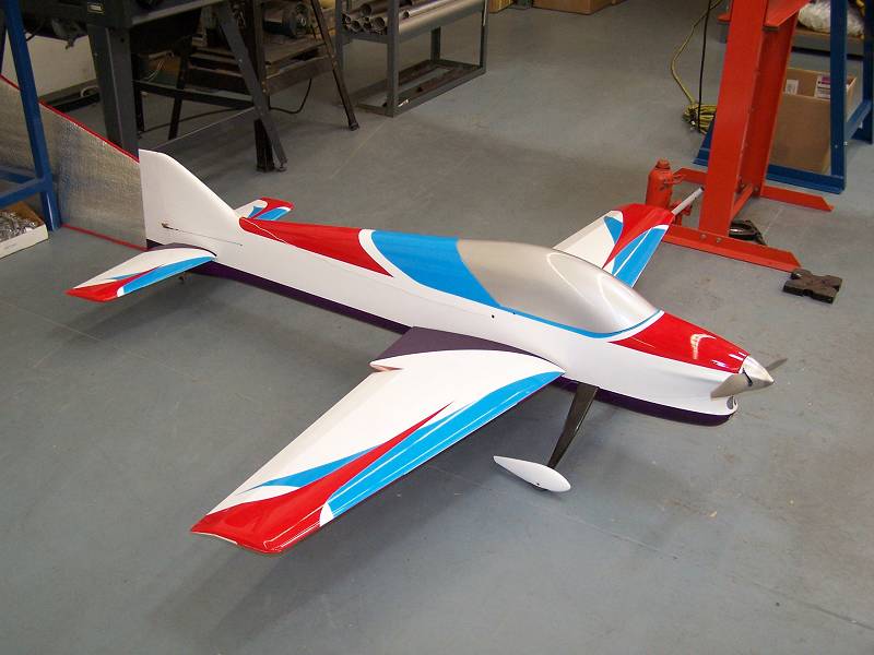

Here is my plane. Hacker C50-14Xl, Opto 77 controller, Thunder power 4200, APC 20X15
weight 10 pounds 3 ounces. No special mods, all stock.
