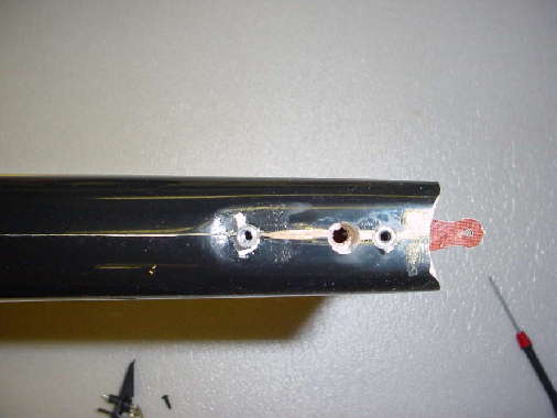

This is my stab. And the carbon tube is not glued. Is that luck or bad luck. My friend has bought a Beryll. For me, that is quality. Without painting. And the price is almost the same. I love this Plane. The construction not the work. And this is the only reason for Integral. Next plane I will buy from ZN Line. Then I can adjust everything by myself. That is the better way and my opinion.
But I will not criticize always. Please do not understood me false.
SR
andreas

I still have not drilled the holes for the stab tube screws.
Does the screw hole go on the outboard or inboard side of the support rib?
Colin.

According to my instructions - "Each stab also has a matching carbon sleeve inside it, with a blob of epoxy/microballoons on the bottom of it to reinforce the position where you must install the M3 X 12mm stab retaining bolts, approx. 75mm (3") in from the root rib." I measured my stab and found that 4" (measuring from the outside edge of the stab - the root rib is an 1/8 " indent) puts you right on/just inside of the the inner rib. Any reason why you chose 4" rather than 3"? The reason that I ask is that I'm getting ready to do my stab.
Nitpicking as always,
Terry
P.S. See you out at the field if the rain ever stops.

Was at the field for 4 flights today, and I was the only one flying at the time until I was done. It was kind of nice to have the entire field to myself wth very mild wind and some high clouds.
The 4" location has no particular reason, and since I had a hard time finding the exact location where they placed the epoxy/microballoon reinforcement, I went with my own measurement instead. The good thing is the plane has more than 200 flights without any sign of issues.
Kevin

I did some more measuring and I discovered that stab tube sticks out 4 1/4" (from fuselage side to end of tube). If you tap at 4" this puts you out near the end of the tube and makes it easier to put in the T-nut that they supply. It also matches the picture that they have in the back of the manual. Tapping at 3" is doable, but it makes it a little harder to put the T-nut in.
Terry

Forgot to mention that I decided to use 6-32 screw and T-nut combo on mine. It may be a little over kill, but so far it has been working fine, meanwhile, they are easier for me to find a replacement in case I need them...
Next weekend should be sunny and warm on both days, hope to see you at the field.

I am at the assembly of the integral.
First Manufacturers error. I think that is not the last.
[:@] Futaba S 9650 does not fit into the elevator. [:@]
I am angry [:@] [:@] [:@]
andreas

Not a manufacturer error !!!!
All their kits are "optimized" for JR servo's, Correct me if I'm wrong!
If you really want to loose your time, take your biggest pencil and try to convince Carf to change that !
Or just buy equivalent JR servo and stop to complain
I had the same little prob., just 30 min to adjust and glue a little plywood behind !
No worries
Personnaly, I also changed the rudder servo tray to have receiver and powerbox inter on the same plate.
Wheels : simply a diam. 4 mm hex screw through everything, some nylons washers, nylon-bolts see pictures. Almost what's written in the manual.
Tailwheel : some 3 mm plywood, PU glue, 2 insert coil MPjet "et zou....."
Enjoy the great airplane you have for the money you paid
I didn't try to save any weight
Laurent
