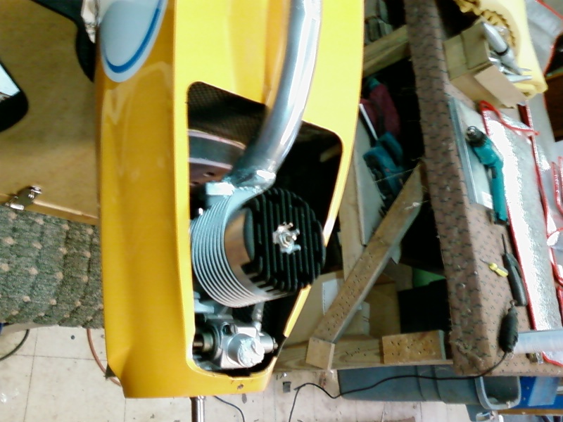

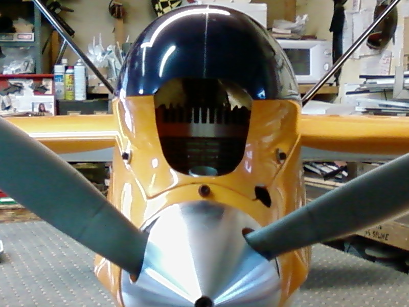

It might be easier with the 1.60 because the exhuast is on the side. You will gain about an 1" to 1 1/2" of length that way. The 1.60 and 1.40 tune in about 26" to 26 1/2" from the piston face to the first baffle in the pipe. Turning and 18 x 10 or a 15. 75 x 10-11 at about 8000 rpm.
The 1.60 will require you to cut some of the fuse out of the way for exhaust clearance.
As you can see by the picture the 1.40 is a tight fit.
Carl

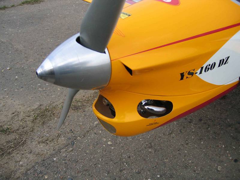

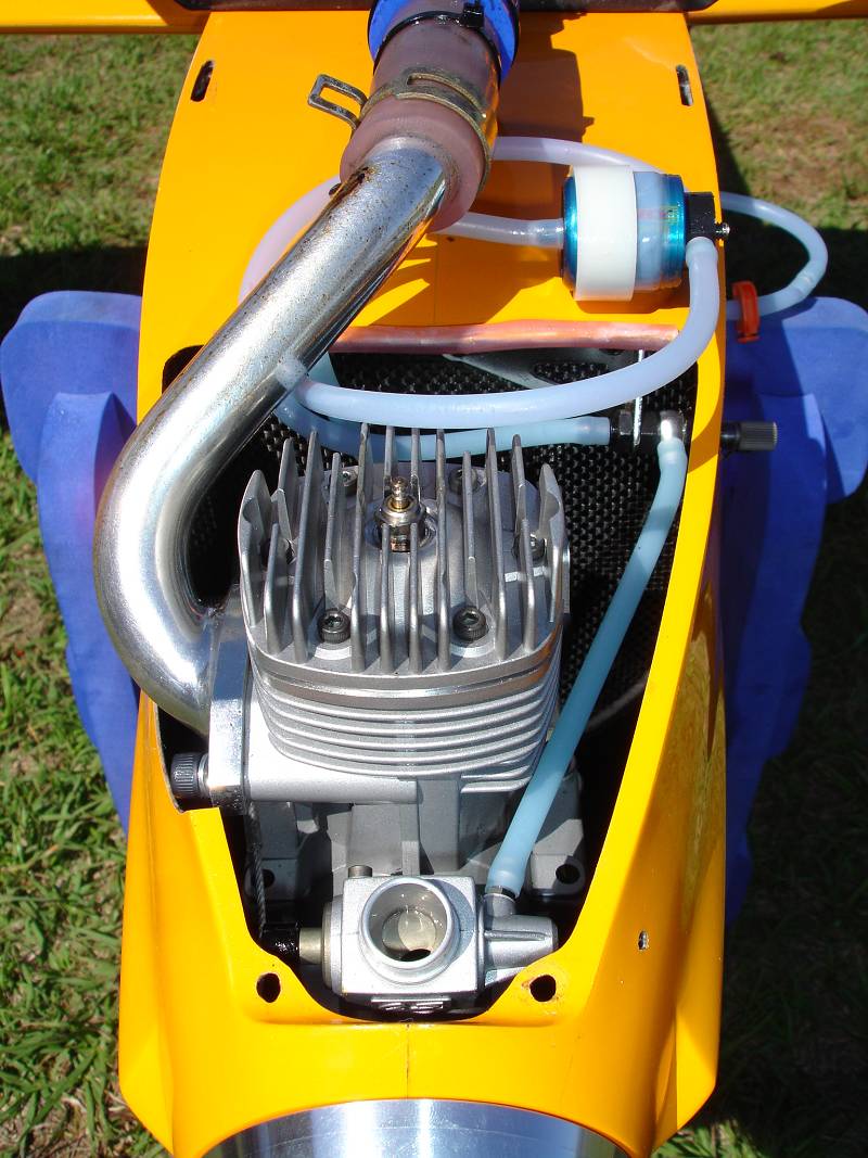

Here's some pics of an OS-160 install with ES pipe, Perry pump and Central Hobbies pipe mounts.
The YS header is the higher rise of the 2, the 822

Old 03-26-2007 | 11:25 AM
  #232
Joined: Jan 2005
Posts: 79
From: Ocean View, NJ
Default RE: Composite-ARF Integral, kinda build thread
Looks good!
What type of engine mount is used with the 1.60?
What weight did the plane come in with the 1.60 Mounted?
Whose pipe is mounted on the 1.60?
I know with the 1.40, the Hyde mount is pretty soft and the engine comes close to smacking the fuse.
Carl
Old 03-26-2007 | 11:51 AM
  #233
JAS's Avatar
JAS
Joined: May 2002
Posts: 1,432
From: Around
He's using the Hyde ARI mount. It doesn't hit the nose area. I've been using the CR mount and have the motor offset and not hitting the nose. Its the ES pipe (I think L). Not sure about weight, but his felt the same as mine.

Old 03-26-2007 | 01:36 PM
  #235
Joined: Jan 2005
Posts: 79
Looking closely at the picture, it sure looks like the header and carb will do some banging at idle. Maybe not.
Carl
Old 03-26-2007 | 03:05 PM
  #236
JAS's Avatar
JAS
Joined: May 2002
Posts: 1,432
From: Around
The carb is low enough to be outta the way (unless it rotates more than 45 degrees [X(]) and the header has enough clearence. It doesn't move that much. You see that the motor is actually a bit to the left (from front) and can be rotated a bit right the help with that.

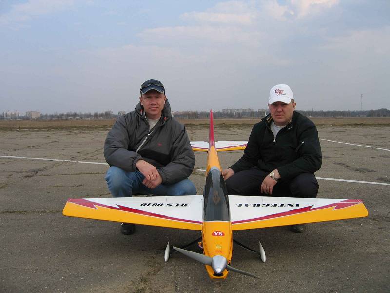

Old 04-02-2007 | 06:52 AM
  #239
Izverg's Avatar
Joined: Oct 2005
Posts: 13
From: Yeisk, RUSSIA
Pls, find some pfotos of our Integral.
First fly last saturday 31.03.2007
Good fly with CG 185 mm from lE.
ID:	655224   Click image for larger version
ID:	655225   Click image for larger version
ID:	655226   Click image for larger version
ID:	655227   Click image for larger version
ID:	655228   Click image for larger version

Old 04-02-2007 | 02:29 PM
  #241
Izverg's Avatar
Joined: Oct 2005
Posts: 13
From: Yeisk, RUSSIA
weight 4830 gr.
