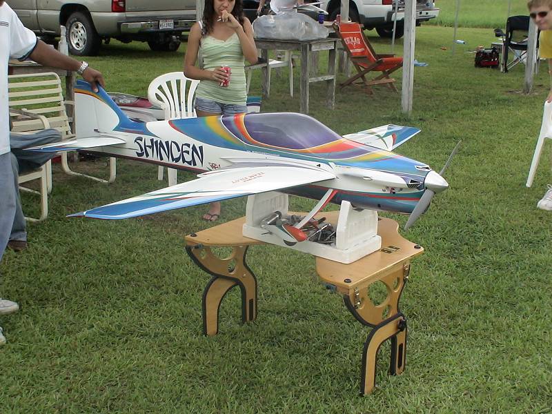

Bear in mind this is the largest airplane on the market ,
it matches the 1.6 and 1.7 YS very nicely ,,, but I have no knowledge of an electric setup.
Use a Hyde ar. mount for best vibration free setup

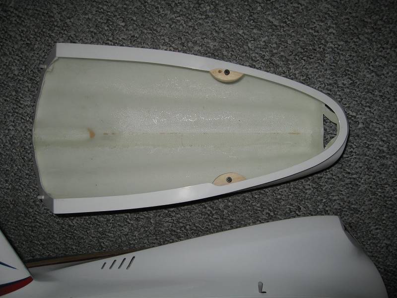

add rear mounting screws to the canopy and it will reduce vibration noise

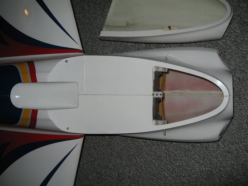

the BVM Hatch latch will not hold up all season ,,, it`s nifty ,, but not practicle for the full season.
Don`t use the supplied ailr horn setup use a stainless steel stud of equal size,
I`ve broken two different aileron horns on two different models.
If using glow power add wedges to the underneath of the gear mounts to throw the gears down and increase clearance for the 18- 19 inch props.
it likes the 18.1-10 apc.
Drill the axle holes in the gear as far down as you can on the legs for more clearance don`t go by the recomented boss they have predrilled .
I also use 3 inch dubro diamond tred tires,, 12 grams each ,,,,,[the gear are now updated on the latest models}
use the alum axles from Central Hobby they are the lightest out there, nothing else compaires { make sure you use green lock tight or they might back out }
Mount the tank under the wing tube releive the servo plate so you can put the tank towards the rear, it should be centered on the c/g
{1/8 forward of the wing tube }this is the most convenient way,, and out of the way

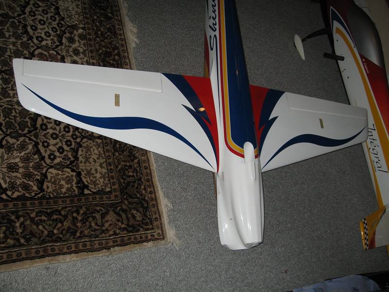

Raw weights of my Integral kit was:
Fuselage: 810 Grams
Canopy: 87 Grams
Cowl: 78 Grams
Right wing half: 410 Grams
Left wing half: 420 Grams
Wing tube: 95 Grams
Right stab: 122 Grams
Left stab: 117 Grams
Stab tube: 12 Grams
Fixed gear: 112 Grams
Wheel pants: 33 Grams
Total: 2296 Grams

#143
Looking at those pictures, the Integral is in a different class in terms of manufacturing. The Integral is a balsa/glass sandwich, with the complete forward section from the gear on layed up with carbon. It also has a kevlar band running the entire length of the fuz on both sides.
This looks lik a foam/glass sandwich and thats about it, which is I understand heavier.
#145
Posts: 242
From: Henne, DENMARK
Hi Mark,
You are correct that the Integral is not quite as "ARF'ed" as the Shinden.
If you like you can find some details here in post 387: [link=http://www.rcuniverse.com/forum/m_5004679/mpage_16/key_/tm.htm]http://www.rcuniverse.com/forum/m_5004679/mpage_16/key_/tm.htm[/link]
The finished product is here in post 534: [link=http://www.rcuniverse.com/forum/m_5004679/mpage_22/key_/tm.htm]http://www.rcuniverse.com/forum/m_5004679/mpage_22/key_/tm.htm[/link]
