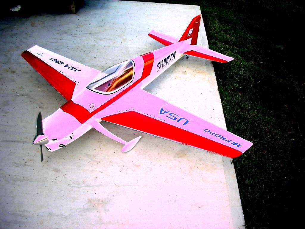

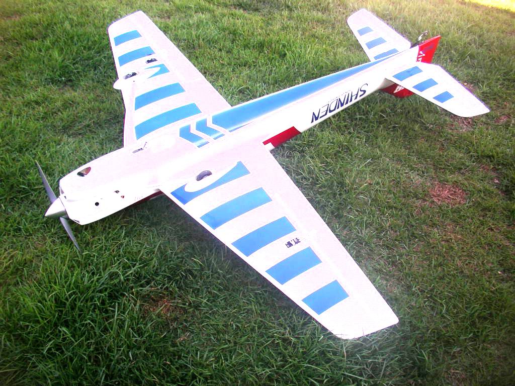

Thanks Dave. I'll try mine the same way. Here's a picture. It's ready except for checking the CG and installing the battery, switch, and receiver.

Hi Dave
plane looks good !
make sure for best flying results you have the c/g on the front side of the wing tube to 1/8 in front of the wing tube
mount your switch and battery all the way forward ,,,battery near the firewall.
Set the wing inc at 5/8 deg pos. it`s a little shy from the factory,
adjust the stab to match the elevators after the trim flight
On the air intake I opened mine a little in the front to help keep it cool !!!
down here in the dead of summer it does get a little warm in the cowling
for snaps it takes
13 deg up elevator 15 down
18-20 deg ail throw evenly adjusted up and down
low rate rudder ,,,for both snaps and spins.
If it wants to keep rotating on the snaps and spins your ,,,tail Heavy or,,, too much rudder input {it takes very little rudder for all snaps }
good luck let us know how it flies.
Now1,,,, back to Nat`s packing
Bryan

Is the plane really that pink, or is there something wrong with the picture? Or my eyes?
Old 07-18-2008 | 09:41 AM
  #187
My Feedback: (15)
Joined: May 2003
Posts: 254
From: Lake Charles, LA
Default RE: Shinden Build
That is PAANK!
<G>
G
Old 07-18-2008 | 09:57 AM
  #188
My Feedback: (50)
Joined: Apr 2003
Posts: 558
From: Bolivia, NC
ORIGINAL: mjfrederick
Nope, It's red, white, and blue. Sometimes my digital camera gets the exposure wrong due to my ignorance of them and I don't know how to correct. Pictures would have come out better if I had put the plane in the sunshine rather than the shade of the shop I think.
Old 07-18-2008 | 10:42 AM
  #189
Joined: Aug 2006
Posts: 1,175
From: Denham Springs, LA
OK, I figured something like that had happened, now I can at least imagine... Nice looking job on that! To be honest, my first thought when I saw the picture was "That's beautiful, what is that, velvet?"

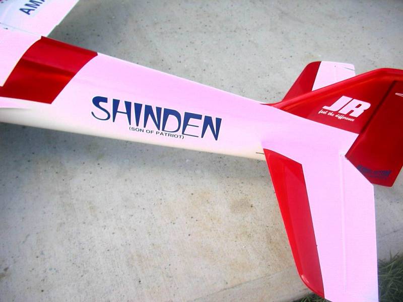

WHAT FONT IS THE SHINDEN ON THE SIDE? NICE PLANE.

ORIGINAL: DAVE KEPHART
I don't know. I asked the sign lady to use an oriental style and that's what she came up with.
Here's a better picture.
