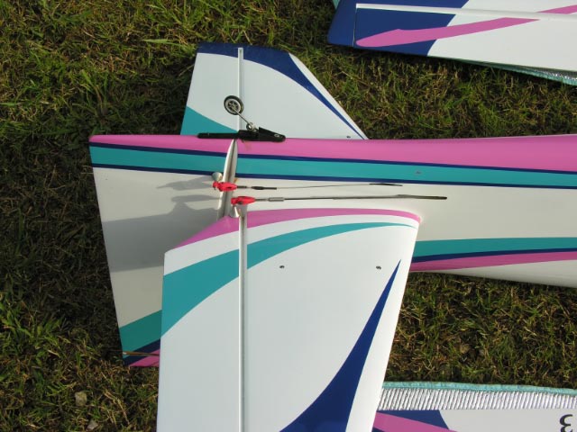

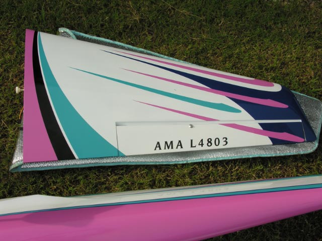

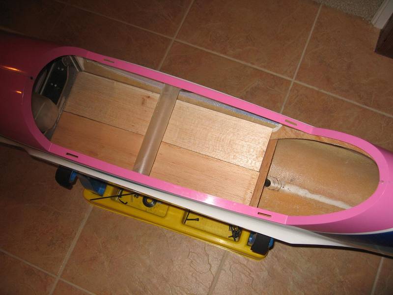

Yes, it's a full aircraft. Here are some photos.
