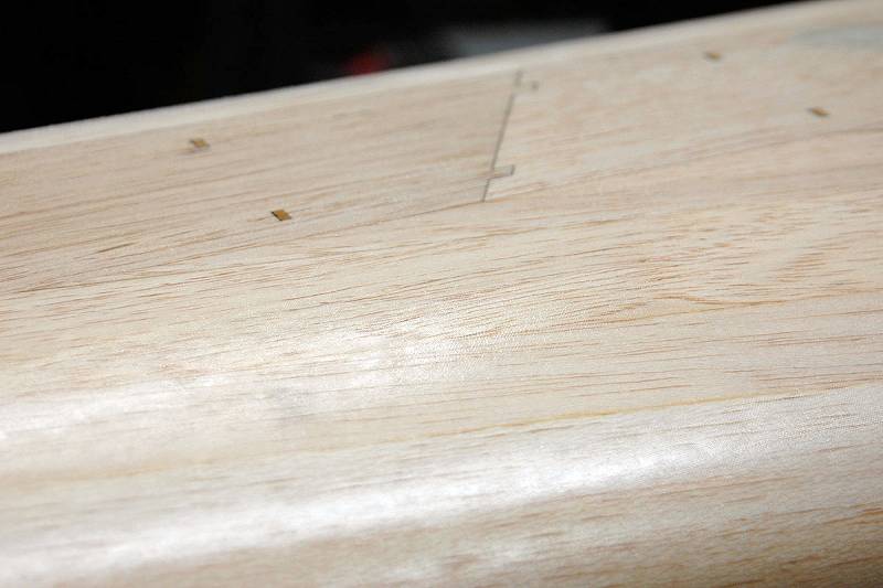

Finish up with 320 grit. I use a hard rubber flexible sander to do the turtle decks at this point. You should have a nicely leveled surface at this point with no major surface defects. Now is the time to weight the plane. Mike gives a reference weight of 32 oz for the bare fuse (no canopy or chin) mine hit the scales at 31.75 oz. So I am in the ball park.

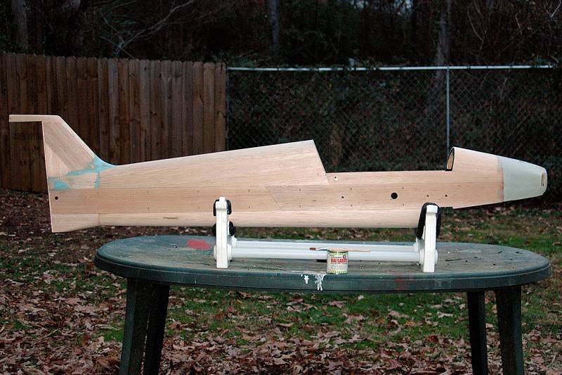

Your next step is to brush or spray on a coat of balsarite to seal the surface from the laminating resin. I use a 3/4 or 1" nylon craft brush. Just paint on a nice neat coat. It dries almost as fast as you can paint.
I let the balsarite sit overnight so it gets good and hard. Then just go over the airframe with 320 on the block to smooth out the fuzzies.

An update on weights: this plane was at 31.6 oz before basarite, the coat of balsarite added .4 oz to the plane it is now at 32 oz before the first stage of fiberglass. I am going to record weights thru every stage of the finishing process. If possible I would like to paint the wings and stabs, but I will first focus on just he fuse and rudder to make sure I'll be hitting that magic 10.5 lb mark - shouldn't be a problem - the infamous red plane that I glassed and painted finished out to be 10.5 lbs.
one of the nice things about the balsarite is it hardens the surface and makes it a bit easier to see the surface leveling and defects. I noticed I can do a little more sanding to the top of the fin and rudder cap - I'm only talking about 1/64" here but a little extra work will get things a little more flush. Figuring the time invested to this point - an extra 15 mins here or there is not a lot. And I might be able to shave off .1 oz of balsa getting my weight back down a bit.

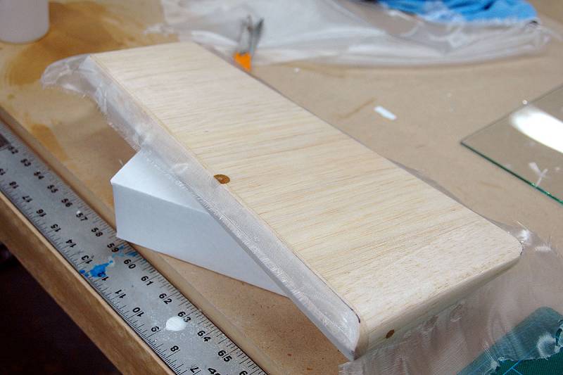

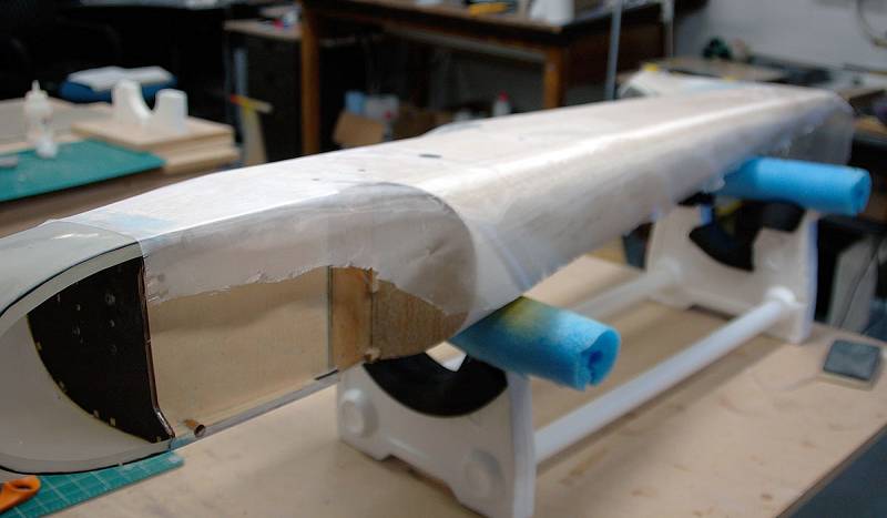

here is a shot of the rudder with the first stage of fiberglass, I do the leading edge and top of the rudder with one piece of .5 cloth, thinned west systems and micro balloons. This may actually be a 4 stage process to do the leading edge and top, one side and bottom, other side and bottom and trailing edge. You have plenty of cure cycles to work while your finishing the fuse. I have this little stand to keep the rudder vertical while this first stage cures.
#288
My Feedback: (23)
HI all,
More notes on the first stage of fiberglass. When doing the fin post apply your slow west systems reduced with acetone (about 50% reduction) with a epoxy brush. Just do a thin coat with the brush. It's a small area and with the reduced resin it's hard to add too much epoxy. Once you've brushed on the epoxy rub in your micro-balloons. On the lower chin area use 2 oz cloth, there is no need to fill the weave with micro-balloons as it will be enclosed by the chin cowl - it will fill well enough with the primer - it's also too hard to sand that area if you do use the micro balloons.
Once these areas cure, I trim away excess cloth with a single edge razor and sand flush any overhang. then your ready for next steps...

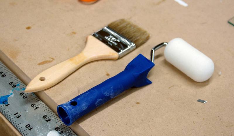

When applying the fiberglass the the fuse sides I use a 2 1/2 brush and a 2" foam roller. I buy my .6 oz fiberglass cloth in rolls from CST. You can get rolls in 25" widths which are perfect for our use here. The advantage in buying the fiberglass in rolls is that there are no folds to fight and no need to "iron" the cloth. Lay the fuse on it's side, on a stand, as it's helpful to elevate the fuse to allow the cloth to hang while working the resin and balloons....
#290
My Feedback: (23)

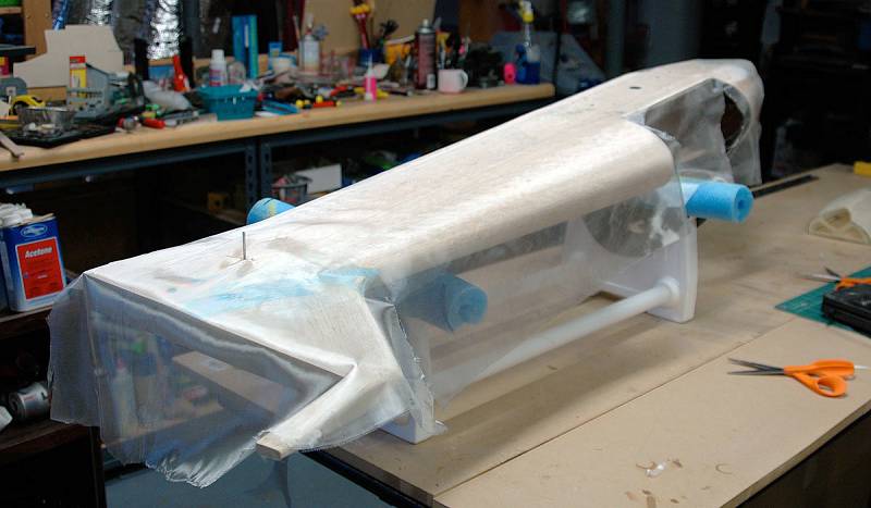

Mix up a 50 g batch of West Systems 105/206 (slow hardener) and add 20g of Acetone. This is a good working reduction. Once you have your cloth positioned to cover the entire side of the airframe start from the center and brush a coat of the reduced resin out from the center. using the brush you can pull the cloth and eliminate any wrinkles and such. Just take your time brushing. You will notice with the reduced resin it's almost impossible to lay up too much resin as it is thin and runs off really well. Your just wetting and spreading here.
If your nervous, just keep breathing this stuff has an extended working time and if you think you really screwed up, just yank the entire piece of cloth off the airframe and start over. Also be careful of lose threads getting wadded up in your brush or laying across the cloth - you just want to work at a slow pace spreading the resin, trying not to make a big mess and just making things nice and even
Once you have a nice coat take the foam roller and start rolling the cloth out again starting from the center, you will start picking up resin, using a clean rag or paper towel, start ringing out the foam roller as you go. You will notice any small bubbles will go away as you push the cloth into the surface with the roller - you will also notice the resin forming a nice even layer with the weave of the cloth. keeo working the resin with the foam roller until satisfied that you have both rolled up all the excess resin and that you have created a smooth, level and even surface.
Between one fuse side and one side of the rudder I used appx. 40 grams of resin (just a guess I had a lot on the paper towel and foam roller and almost 8 grams left in the mixing cup)

The awesome thing about this finishing method is since you sealed the wood with balsarite you are trapping the resin between the surface of the wood and the top of the weave. Just take your time rolling and wiping the foam roller you want the resin to have a matted look to it and a smooth appearance.
this is easy within 5 mins your will get the hang of it and be a pro.....
just remember to keep breathing and don't start hurrying...

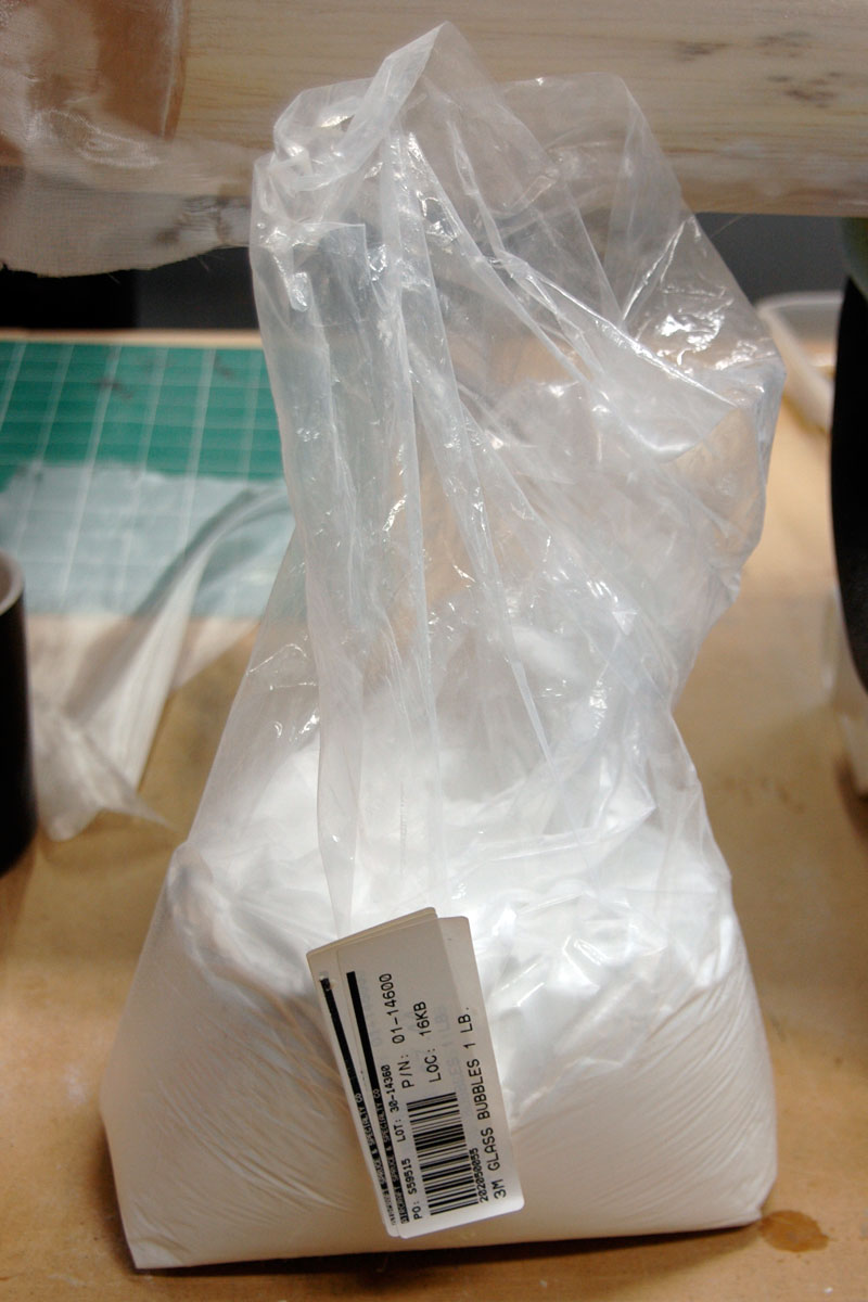

Now for the fun part (okay I know I am a bit of a sicko here)
Let's play with the microballoons
I use 3M Micro Bubbles available from Aircraft Spruce - I've used the Top Flight product before and these just seem like a higher quality product. It might be exactly the same but I can buy a 1 lb sack for the same price you can get the little Top Flight bottle at your LHS. Yea, this might be a life time supply for the average modeler, I think I paid less than 10 bucks for this sack.
#293
My Feedback: (23)
Okay, you've got your resin rolled out nice and pretty.
Take small handfuls of the microballoons and sprinkle it over the surface. It easier to do the flat, level areas first to get a the hang of it. With the palm of your hand just lightly rub and push the MBs around first it will be sticky and tacky but once you cover the area with MBs the tackyess goes away flip the plane around to do the turtle decks and fin area. It's really easy and here is no reason to get stressed. Just take your time. It's kind of like finger painting I guess.
Please use a dust mask with this stuff, even with the 3M dust mask you will still get a gritty taste in your mouth. Also if you have small pets or wifes in the area, please ask them to leave the room. on warmer days I usually do this out side as the MBs float in the air and this process is a bit messy. I usually shop vac the area as soon as I am done.
The cool thing about how the MBs work is if you have a heavy area of resin more MBs will stick in that area absorbing the resin. Let this happen, you will be sanding off about 90 percent of the MBs and all the excess resin.
I completed this at around 11 am this morning, it's now 7 pm as I am writing this thread, the 206 hardener is about a 15 hour full cure, I won't be ableto do the other side till tomorrow morning.

Mike what is the side area of the VF3? - would like to get a weight per sq/in for this finish.

Side area is 860 square inches or thereabouts.
Oh what a difference thinning the resin makes
