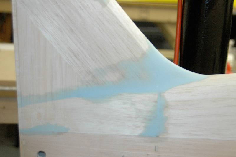

Sanded and glassed. But I can see some very minor inperfections because I cut out some bubbles that came out in the glassing process.
The question is, do I need to deal with those very minor imprefections on the surface before priming it up?? or the primer can take care of these on the final sanding of primer??
Srikar.
Srikar.

if it's large and bare wood, I'd cut small pieces and re-glass. if they are very small, just hit them with resin and resand. Primer over bare wood isn't good in the long term. It's fine until you get some age and hot sunlight.
I've definitely experienced the bubbling before and it boils down to one thing: too much resin. if it's properly rolled out and thin and tight, it can't bubble. It' all practice and technique. You will learn SOOOOOOOO much the first one you ever do. I'm sure you've found this to be true.

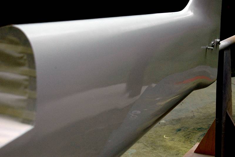

I've got 2 VF3s ready for paint - So here I go into finishing these babies.

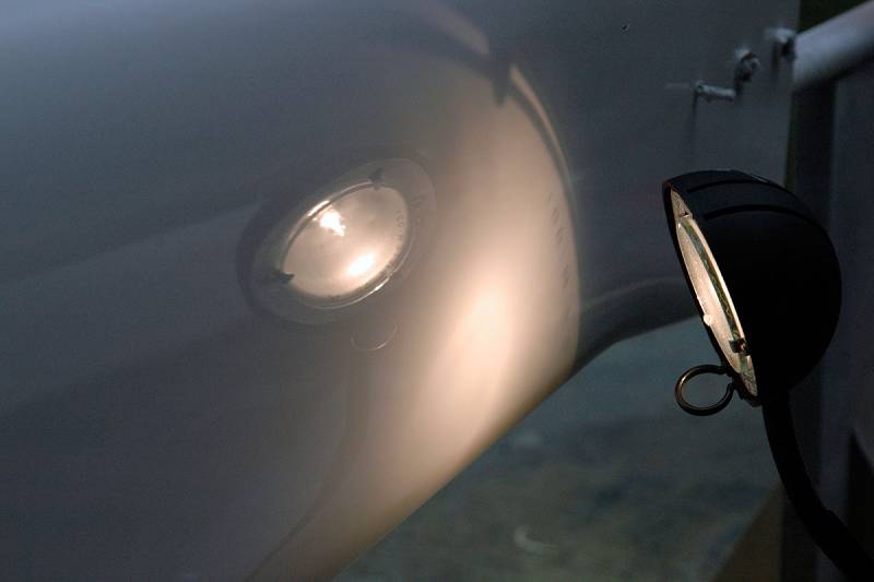

Mike is right about the sanding - be prepared to spend a considerable amount of time filling and sanding the wood airframe. I use a product called "Super Fill" from Aircraft Spruce- it's a two part epoxy filler that sands almost like balsa. Use this filler on the fin fillet, to flair in the cowling and to touch up any other dings or small cracks. Like Mikes says the more on the floor, the less in the air.
I learned from one of the top painters it's best to work with a point light source at an angle to the surface your working - it's hard to see surface details under fluorescent shop lights.
I use different sized flat sanding blocks, and large hard rubber flexible sanding blocks. To achieve a "plate flat" look - it's important to use only a block sander, I use a few different commercial block sanders - 3M makes a variety of different styles of sanders, all available from your local hardware/Home Depot store. I've attached a pic of what "plate flat" looks like, you can achieve this with not a lot of extra effort and a sanding block. The main point is don't touch your plane with out a block - if you think you can fold up a sheet of sandpaper and go at it with your fingers - your mistaken.

I try to avoid much sanding during the framing stage. I may use 80 or 100 grit paper to rough sand the tip of the fin, the lower fin block or to shape the fin fillet or front turtle deck strip planking. Once the airframe is complete and your ready to start the finishing process Start with 150 grit and the block sander roughly 3-4 inches wide and 6-7 in length. All your doing here is basic leveling, do not get carried away here with just go over the entire airframe with the flat block - I do the curved areas of the turtledeck with the flat block, just make multiple passes over the curved areas. You want to pa attention to all the butt seams in the wood construction, the tabs and notches, all the intersections. try your best to level and feather as best you can.
At this point I apply the filler, you can use whatever you like, Mike turned me onto a product call "Super Fill" 2-part epoxy based that sands like balsa. I use that to fill in the fin fillet and all other areas of the plane that need it - it's a 12 hour cure so hit the entire plane. Once the filler is cured hit the filled areas with the 150 on the block and then move onto a 220 grit again covering the entire airframe.
