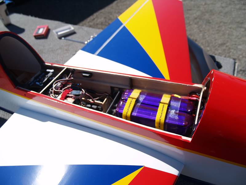

#839
I have a couple of pictures of mine, below is one that shows under the canopy. I don't have any pics of the motor/esc, it's really simple, but I can get those in a day or two, headed to work tonight.
Found that I have to push the batteries quite a bit further forward that I had once thought. In fact, I might have to build a new tray to locate them more securely up front. I'll worry about that later this winter. In the picture below, the batteries are actually located about 2.5" further forward than shown here. About half the battery is forward of the hatch. Flies perfect there.
Great flying airplane. I have never been one to jump on any type of band wagon, but seriously, it's phenomenal.

#841
My Feedback: (15)
Joined: May 2003
Posts: 254
From: Lake Charles,
LA
EFF;
My batts are half way under the forward end of the canopy, too. That puts my CG just a little ahead of the wing tube.

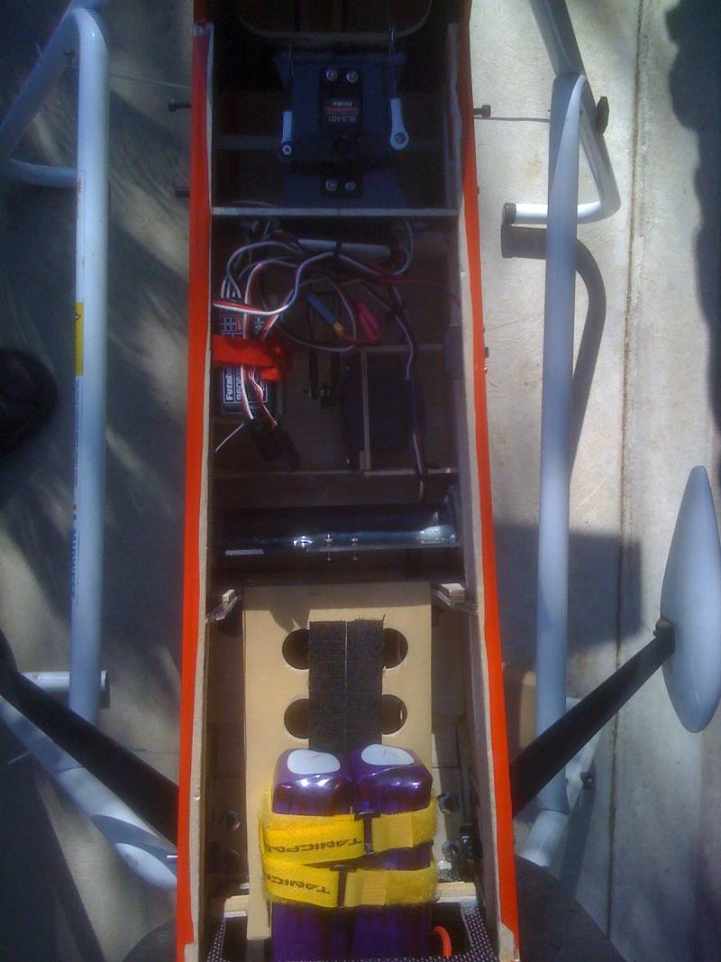

#849
Posts: 2,707
From: Woodstock, GA
Not hijacking at all Tom. To me it just underscores the "other side" of this modeling thing. It's what we do, and who we are. It's simply the other part of modeling that you don't always see at the flying field.
Jason there's really not a lot to see. It's so simple and so basic. Most people mount the ESC underneath the fuse, under the chin cowl behind the firewall. The motor can be mounted a number of different ways, but not to the nose ring only, that won't work. You can either use stand offs (my favorite but some guys out west hate it), or some form of box mount system...I have that but it's special order and I only use it when someone just refuses to do it my way LOL
The packs go where you see them....on a tray/floor between the firewall and the F3 former, usually a bit forward. CG usually ends up between the LE of the tube and the rear face of F3, depending on your preference in trimming and "feel". Exactly where the packs end up will totally be dictated by the plane itself, but I haven't found one that won't balance yet. Unless you get it REALLY heavy in the tail and use elevator servos in the stabs, then you have to get creative. This plane has a very short nose moment and an extremely long tail moment. So build it like you think it's going to be tail heavy....minimize everything behind the wing tube. That way you'll come out light and with a very easy trimming plane.
One thing about this plane: most people seem to really like it. I mean like....a lot. it doesn't have a bunch of fancy gimmicks, bells and whistles, instead it's just a solid, honest plane that flies straight and easy. It can take a little getting used to because it flies slower than most. The fuselage is HUGE, the wings are thick, and it's very draggy. Some have likened the drag profile to a 40% plane. Just do a power off down line close and listen (LOL) Therefore taking this all into account, you have to be very proficeint with the rudder and throttle as well as the aileron/evevator. But when you get used to it.......it's deadly.
If you're flying the electric version, think pitch for the prop. 20" max, 13-15 on the pitch and it is a very good match.
-Mike

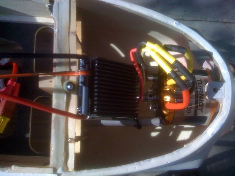

#850
Here are a couple of pics, sorry they are a bit blurry as I took them with my phone. My other cameras' batteries were dead. But like Mike said, there is nothing earthshattering about how this is done. The motor is mounted on standoffs like Mike recommends. I have done several models this way and it's simple and effective. You just need to make sure the firewall is absolutely stiff, so be careful how much you cut out of it for airflow. We did a bit too much and had to put a lattice type structure in to stiffen it back up.
The position of the battery in this pic is where I fly with it. What I need to do is pull out the tray that's in there and locate it more forward. Not a lot of work, but I am just not in the mood for it. It flies fine this way.
