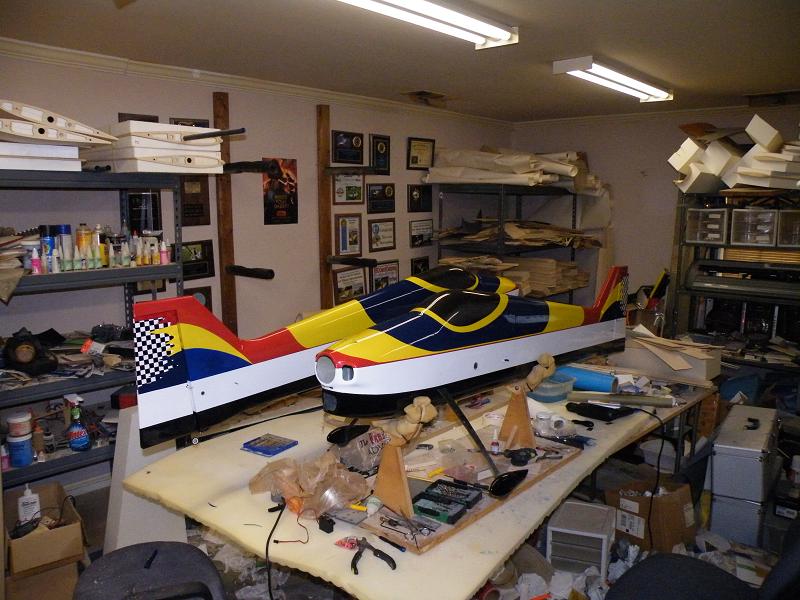

Keep the ideas coming,................open to suggestions for finishing the nose area.
</p></p>
Thanks Dean and Chris,..........
Bill Holsten</p>
#1206
Arch,....
After I looked at it several times that was the conlussion I came to,....red it is!
Thanks for the input,............
</p></p>
</p>
Bill Holsten

I recently acquired a Black Magic with similar fuse scheme. It has purple where you have blue.
the top wings are all yellow with purple and white stripes flaring from the front wing root to the ou tboard trailing edge of the aileron.
botom wings are purple and yellow checkerboard (big squares)
very visible.
hope this helps =- wish I had pics to show.
eddie
very visible.
eddie
