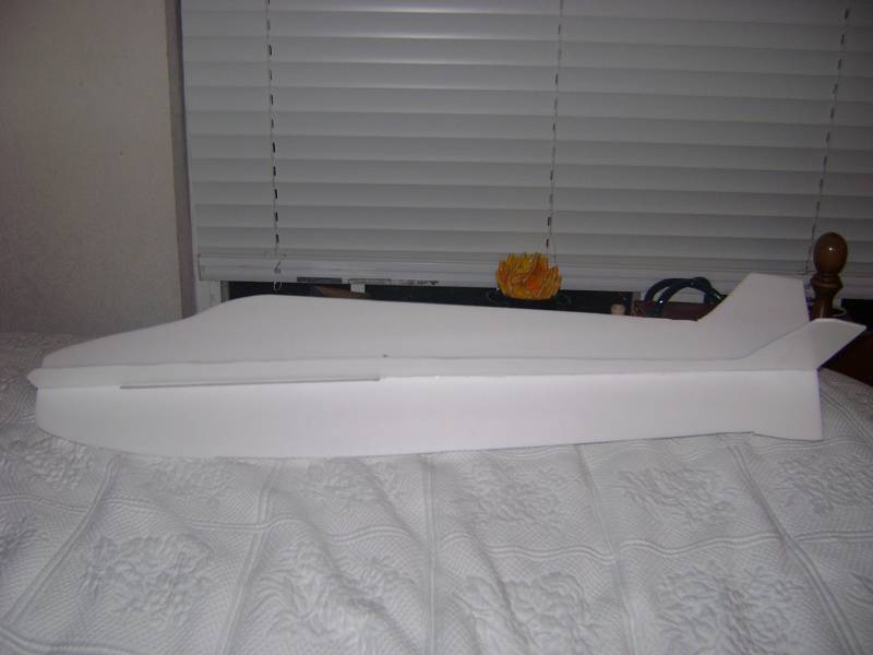

well guys I have been kind of bord lately and was wanting to start flying some indoors. So I took the Black Magic foamie kit that Dean Funk cuts out and decided to cut my own 3mm depron indoor model. In one night Ive been able to get the fuse done. here is some pics I think it looks pretty close to the real one.

nice dude....

Thanks bro... it really came together quick. I cut the foamie with a soldering iron with a xacto razorblade attachment that came with it. and it just when through the foam like butter. and then I used a block sander to smooth out the edges.
but this did take all of my foam. so building will kind of stop for a little bit, till I get some more.

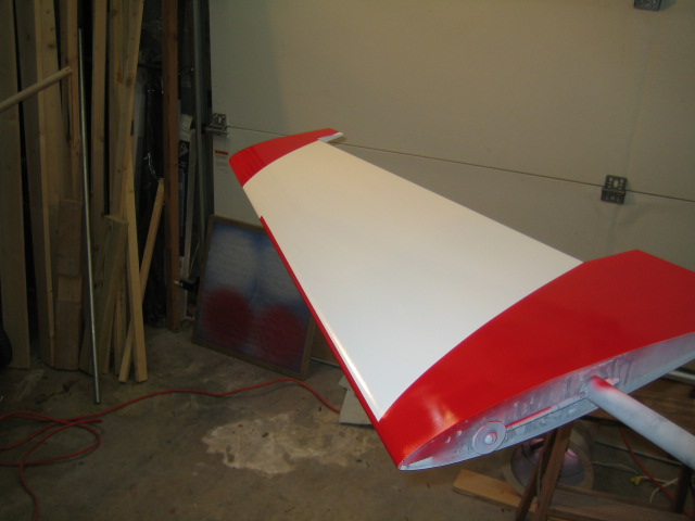

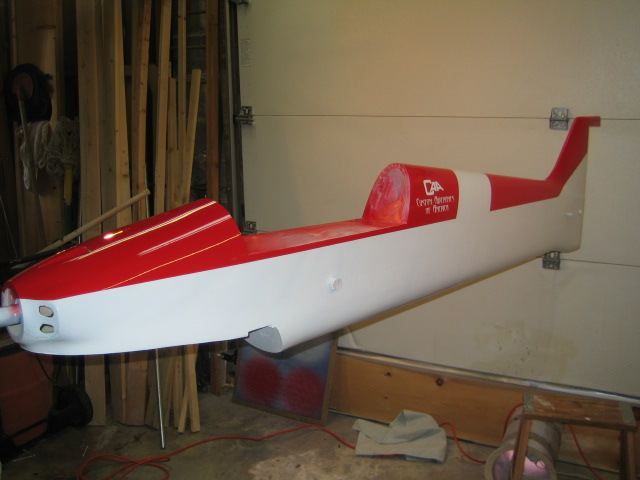

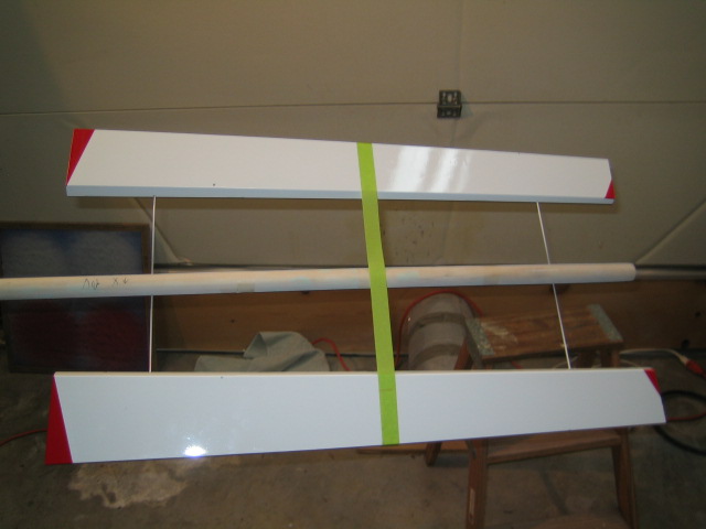

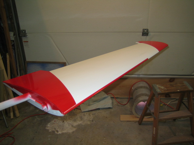

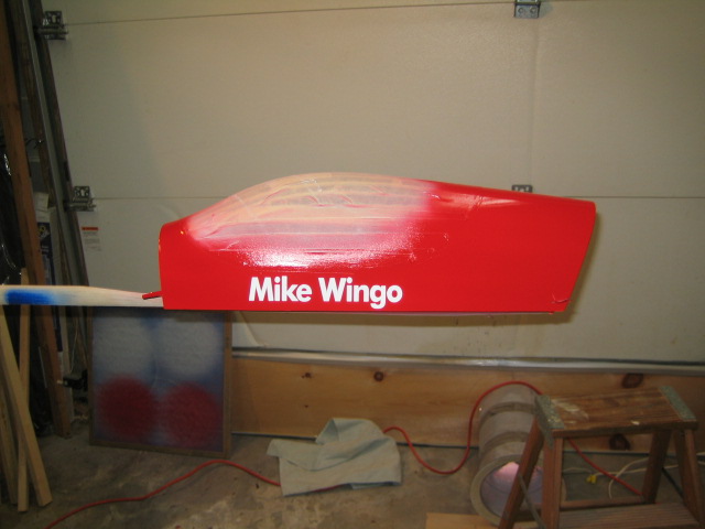

It's been too quiet on this thread. I 'll share a few pix of my latest project in paint.

Mike,
Looks great. Can't wait to see that in the air..

Default RE: Black Magic VF3 Build Thread
larger graphics on the name next time Mike...LOL. looks good so far!!!!!!!!!!!!!!
Lookin good Mikey!
Doing the same thing over here. I'll see if I can get some pics up next week.
-M
yo Mike !!!!
post or send me more pics of your downdraft ventilation system your using, I need to improve my paint booth asap !!!!
looking great bro !!!!!
I love that red - you need to pour me out an oz from your lifetime supply
dean
