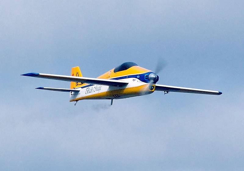

Question: The blue on the cowl area,...? Should I extend that to the chin cowl. It looks sort of odd,..like a raccoon without with out it's bandit mask and eye rings,....looks unfinished up there?

maybe extending the blue into the chin is a good ideal, it looks a little bit cut off from the front view. maybe bring it down so the area around the opening is blue with a dagger coming off the bottom extending along the bottom of the chin....

Yeah,....I was thinking the samething with the blue and a dagger or tear drop,...deal with it later. I just want to get it ready before next weekends contest at Lake City. Just finished installing the engine, pipe and throttle servo,..............off and running now. I got my 14MZ, so that will go in it but it's not on 2.4 yet. I will check out the gear,..thanks!

no dude, that is an old graphic that Chris Odom created back from the crapoola thread days. Go back to the first few pages of the crappola thread you will see it. There are a few classics over there. Your one of the amigos dude, no worries
Your going to have to ask Chris to make a new update photoshop job with tres amigos. Yo Chris, Arch needs a photoshop hack job....
The other pic is the very first Black Magic the prototype V1.Mike actually gave it to me and Iflew it well until good old Jimbo had to crash into it..... LOL - Heck I loved that plane, I first saw it at my first pattern meet and fell in love.
I am hearing rumors that Mike might be doing a V1 tribute scheme on his new plane. Sorry for letting that out of the bag, but Ijust think that is AWESOME!!!!
I loved the heck out of that prototype but took it like an man when she went down...

Thanks dude, I was just digging around for pics! That one shows what I was looking for.
I am gonna add some red and change up the design....slightly. But that was one plane I could SEE!!!!
So yeah trying to keep it simple and clean. 4 days, 5 tops.
