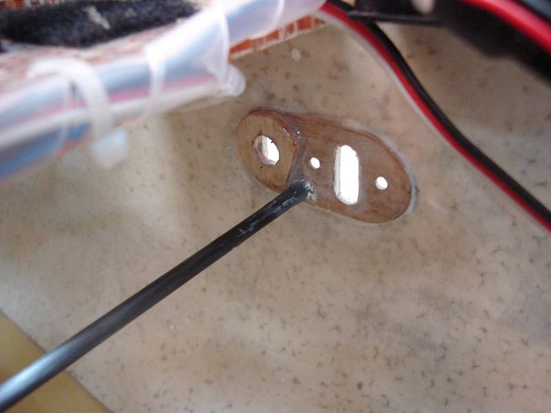

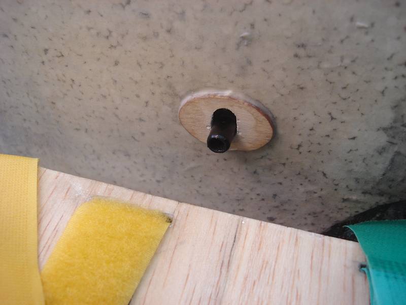

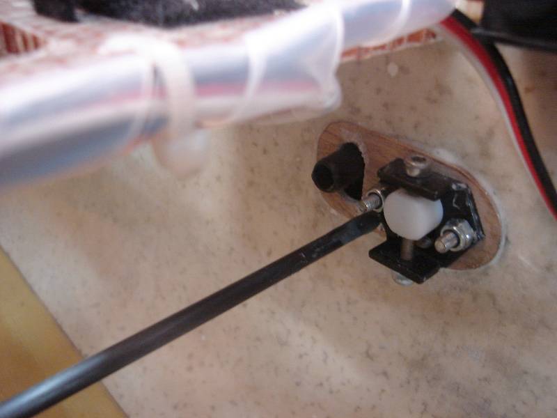

I am a little concerned about the rear attachment of the battery tray, where the carbon rods are glued on to the wing tube sleeve.
Ref. pictures in post 291.
Are you sure this is strong enough?
(Just a thought...)

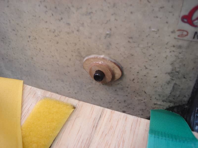

Hi Magne
Till now the plane has 43 flights without any failure,
Take a look at the little plywood pieces, (post 233), where the carbon rods touch the wing tube, these are very essential.
Regards,
Isaac Najary

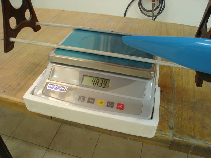

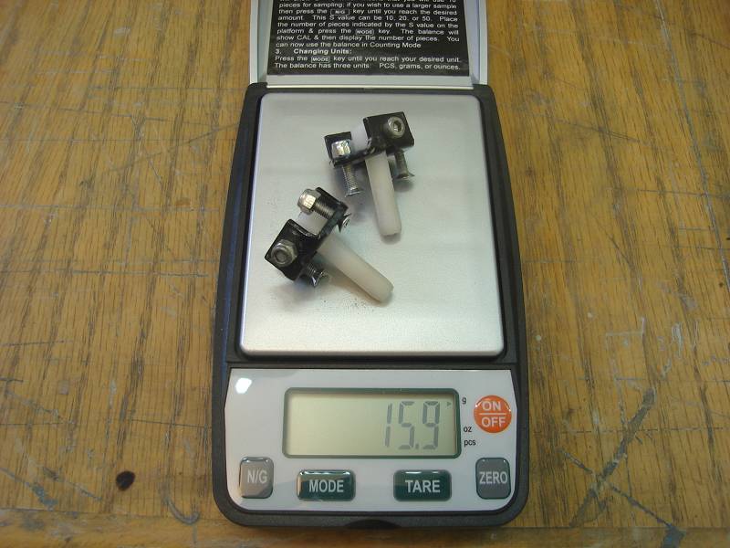

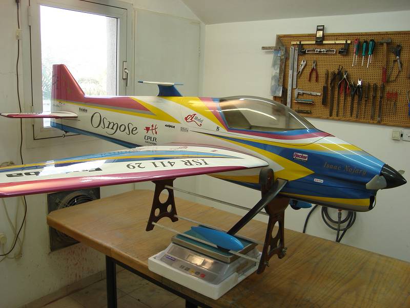

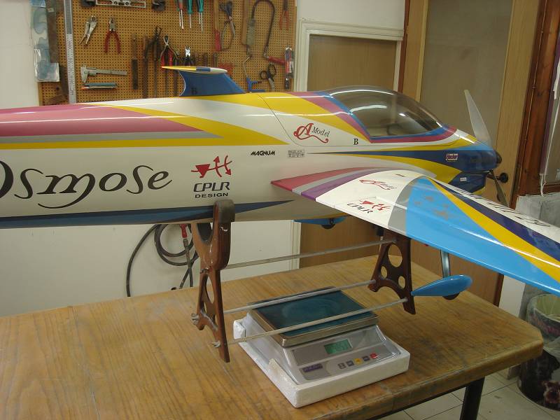

Old 05-07-2008 | 11:31 AM
  #331
najary's Avatar
Joined: May 2003
Posts: 1,201
Received 37 Likes on 32 Posts
From: Ramat Hashrone, ISRAEL
Default RE: Electric Osmose Building

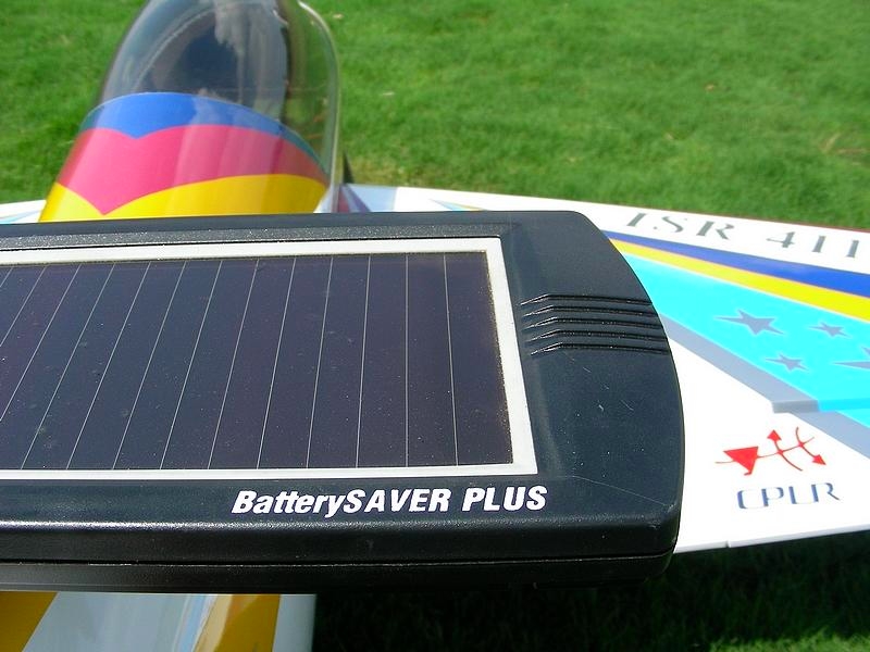

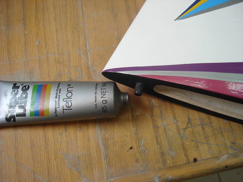

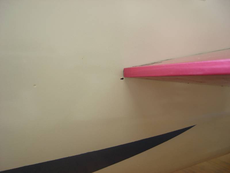

Now is the time to remove the wings adjusters and to save 14 gram more (4,853-4,839).
The final weight is 4,839 gram (With TP 5000 V2 Extreme).
Regards,
Isaac Najary

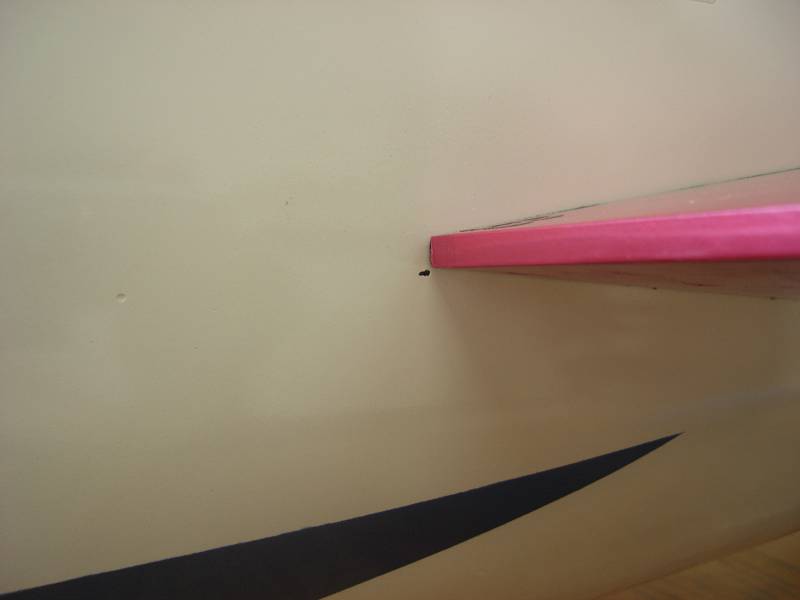

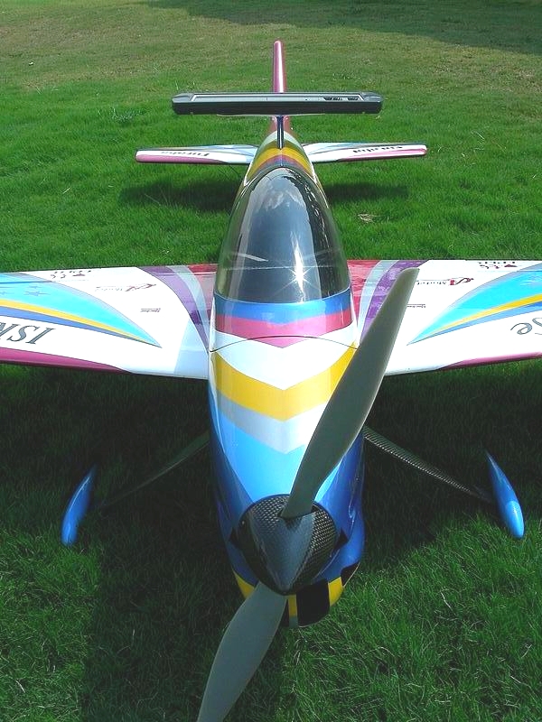

Hi christian
Divergence of 20mm of the C.G. is very common, in the plan of the Oxalays (and other plans) the divergence of C.G. is 20mm.
There are so many variants that has influence on the C.G. location. For example, the distance between the wing and the stabilizer,
I think that in the ARF version of the Osmose the distance between the wing and the stabilizer is about 10mm shorter than what was marked in the mold.
Also in my Osmose the incidence of the wing is different from what was marked in the mold (see picture).
Regards,
Isaac Najary

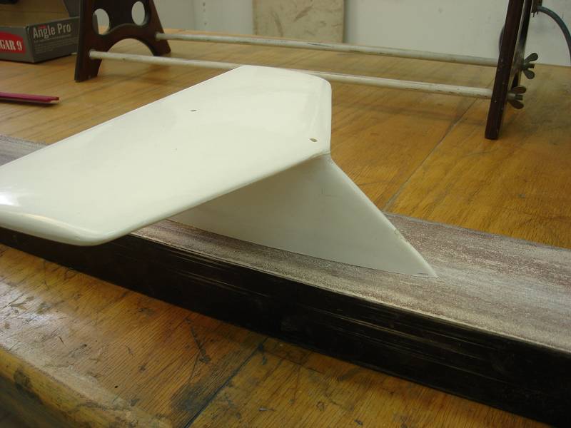

I had left mounting the T-cannalizer as the final step in the model, thinking this would be an easy step. Attached is a photo of my newly discovered situation. With the airplane jigged-up at zero degrees (canopy line and stab), the T-Can is more than 1.0 degree positive. In order to see how much I would need to adjust the T-Can, I added a 1/8" spacer underneath the trailing edge of the T-can as shown in the photo. This is still not enough to bring the T-Can to "zero" degrees.
I am thinking to trim the bottom of the T-can to get the correct angle. I will need to trim (starting at the LE) about 3/16" off.
Did your T-can arrive at the correct incidence, or did you need to go though a sanding to get it to sit at zero degrees?
Thank You,
Jim W.

What have you settlted on for wing incidence? On my installation, with the canopy line at zero degrees, the engine shows 1.75 degree down thrust.
Thank You,
Jim W.
Hi Jim,
In my Osmose the incidence of the wing is different from what was marked in the mold (see picture).
Regards,
Isaac Najary
Old 08-19-2008 | 11:38 AM
  #347
najary's Avatar
Joined: May 2003
Posts: 1,201
ORIGINAL: jim woodward
Hi Najary,
Thank You,
Jim W.
Hi Jim,
My T-can did not arrive at the correct incidence, I needed to go though a sanding process to get it to sit at zero degrees.
See post 159, 160 first pic.
Regards,
Isaac Najary

Well - One problem not to worry about anymore
Nonestop Flying Sunrise to Sunset....
