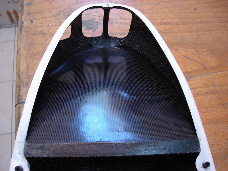

Old 12-15-2007 | 11:39 AM

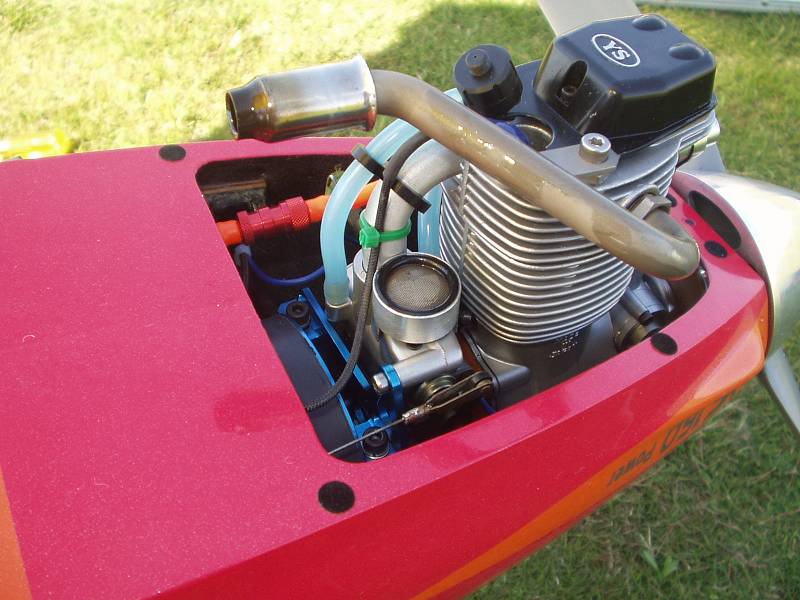

Note:
This method is not recommended for internal combustion engines due to the strong vibrations.
Isaac Najary

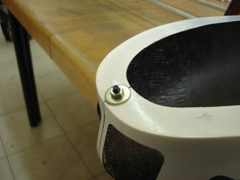

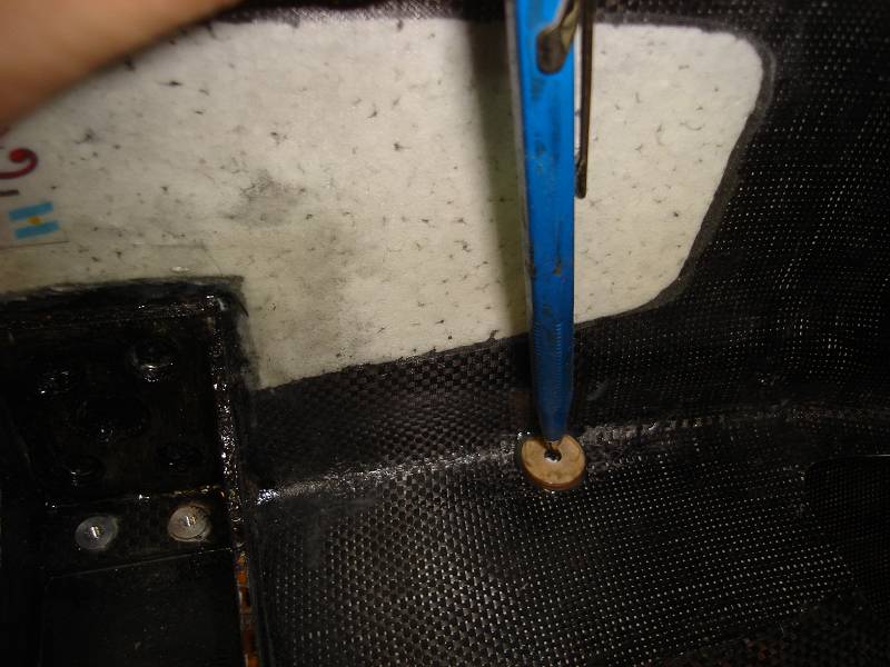

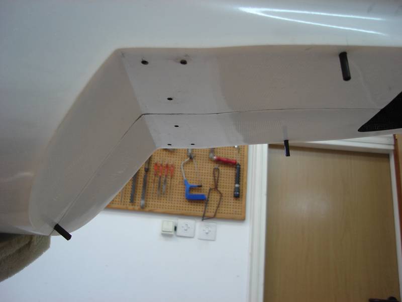

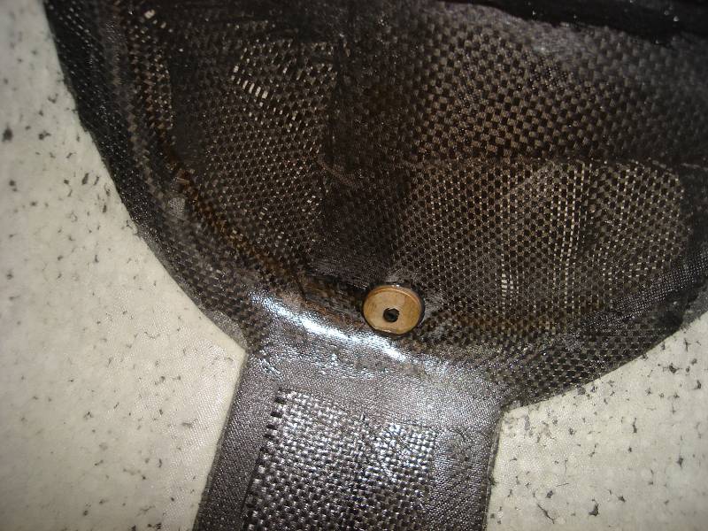

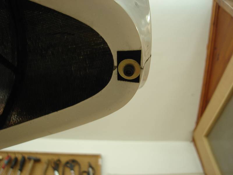

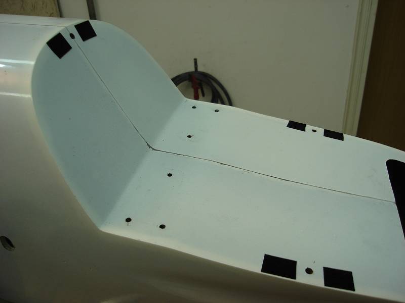

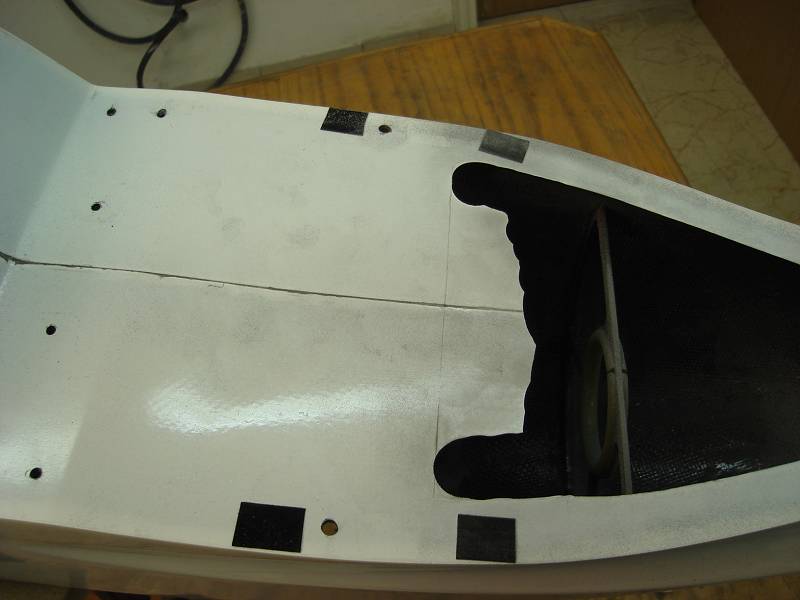

Hi Isaac , from your pictures please clearify the following for me on the Belly pan attachment . What are the little black squares on each side of the locating pins ? On the front of the Belly pan you have a small bolt - are you going to use this to bolt the Belly pan down through the air intakes you made in the Belly pan ?
Juan

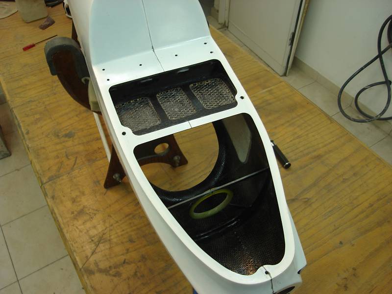

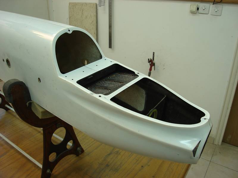

Old 12-19-2007 | 03:00 PM
  #115
najary's Avatar
Joined: May 2003
Posts: 1,201
Received 37 Likes on 32 Posts
From: Ramat Hashrone, ISRAEL
Default RE: Electric Osmose Building
ORIGINAL: jnp
Juan
hi Juan
The little blake spuares are soft sticker which I use to prevent contact between the belly pan and the fuse (see picture).
Yes I am going to use the air intakes as an access to the bolt.
Isaac Najary

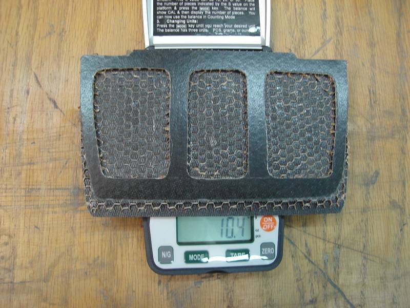

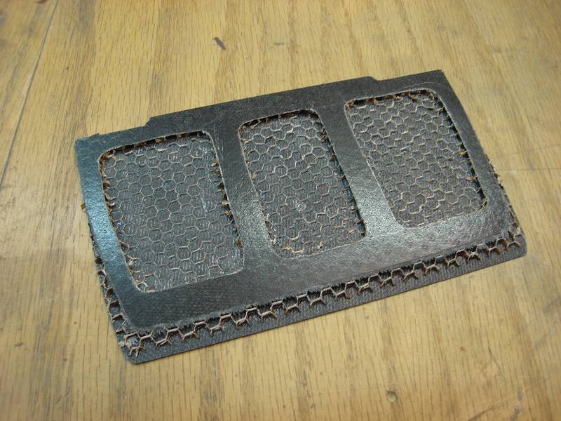

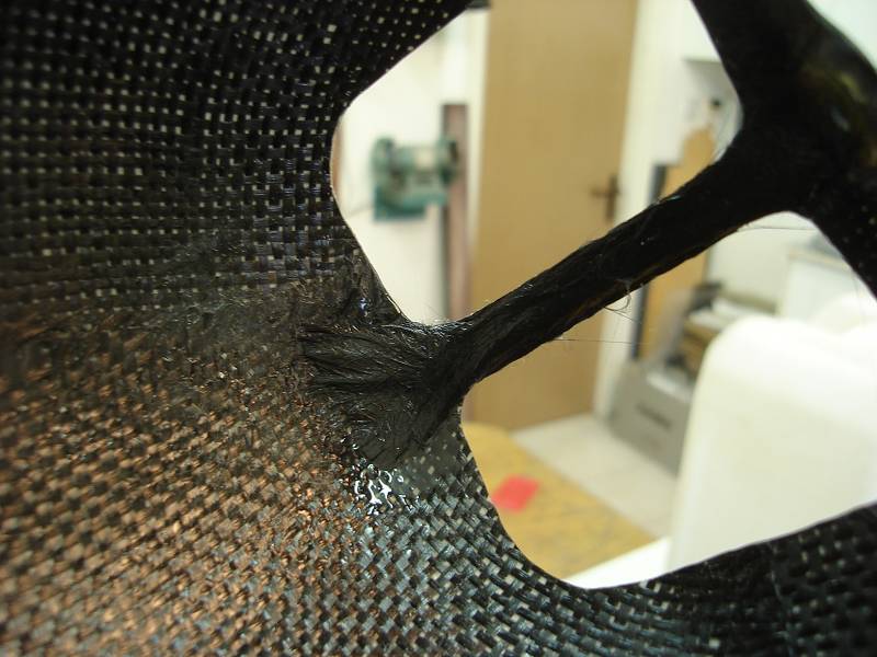

Saving 8 gram
ID:	829365   Click image for larger version
ID:	829366   Click image for larger version
ID:	829367   Click image for larger version
ID:	829368   Click image for larger version

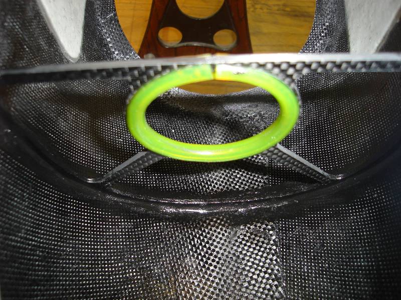

more
ID:	829370   Click image for larger version
ID:	829371   Click image for larger version

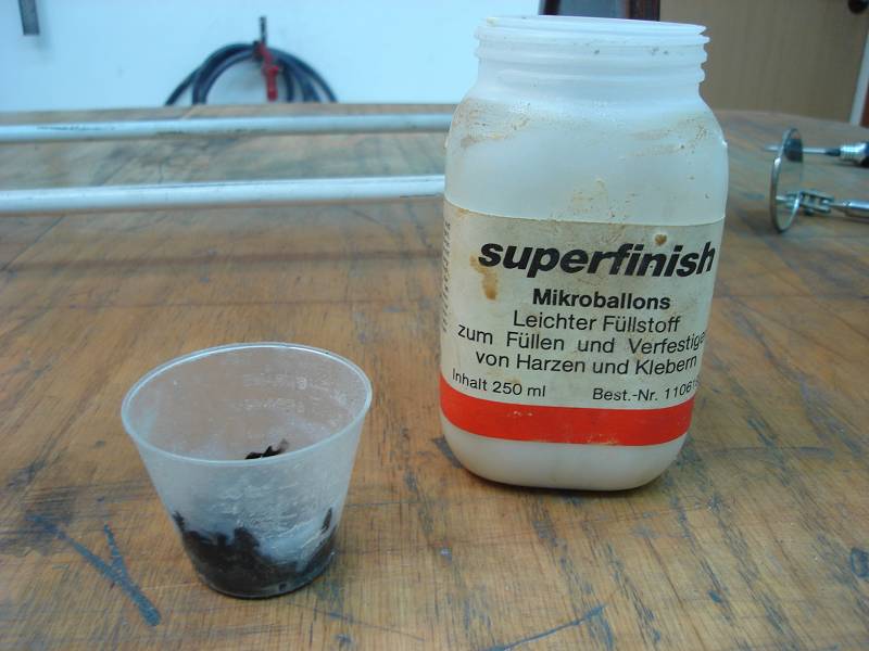

What is the black stuff you're using to colour the epoxy?
Cheers
Jason.
Old 12-20-2007 | 12:42 AM
  #120
najary's Avatar
Joined: May 2003
Posts: 1,201
ORIGINAL: Aussie_Knife_Edge
Hi Najary,
Cheers
Jason.
Hi Jason
It is pigment for fiberglass, can be found in stores that sell fiberglass materials.
Isaac Najary

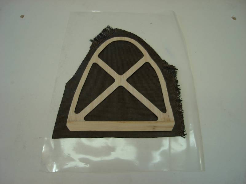

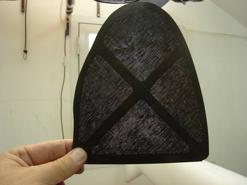

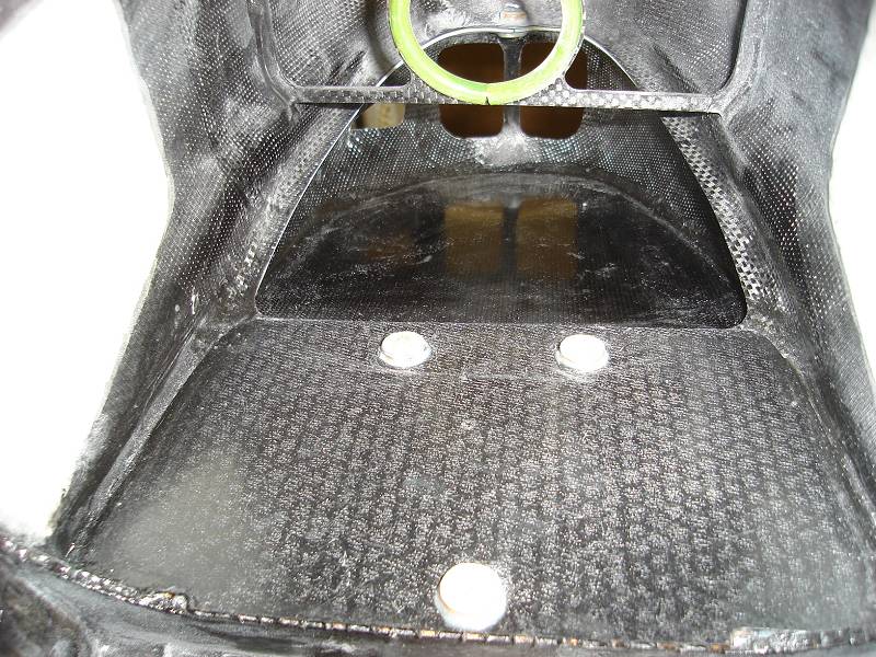

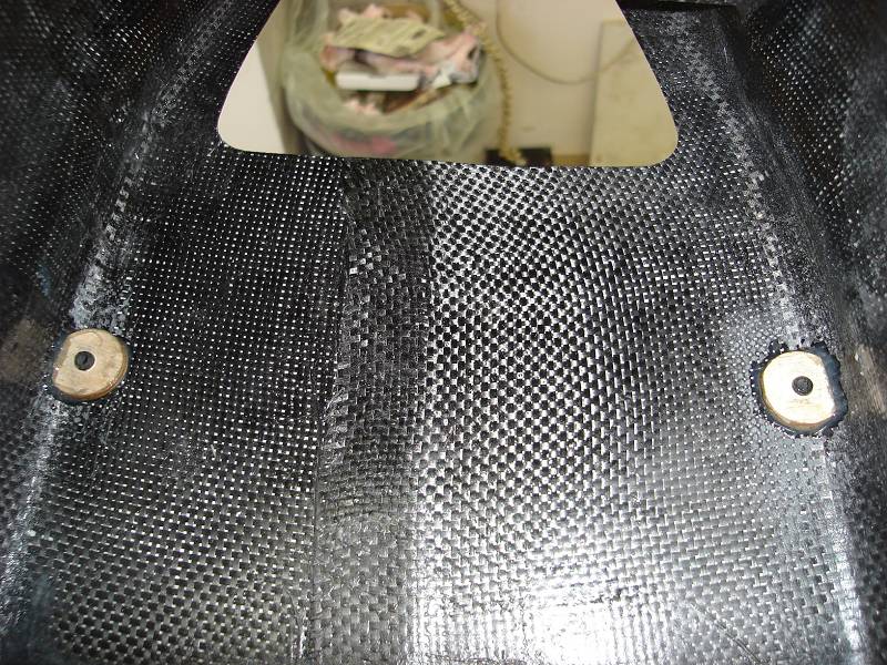

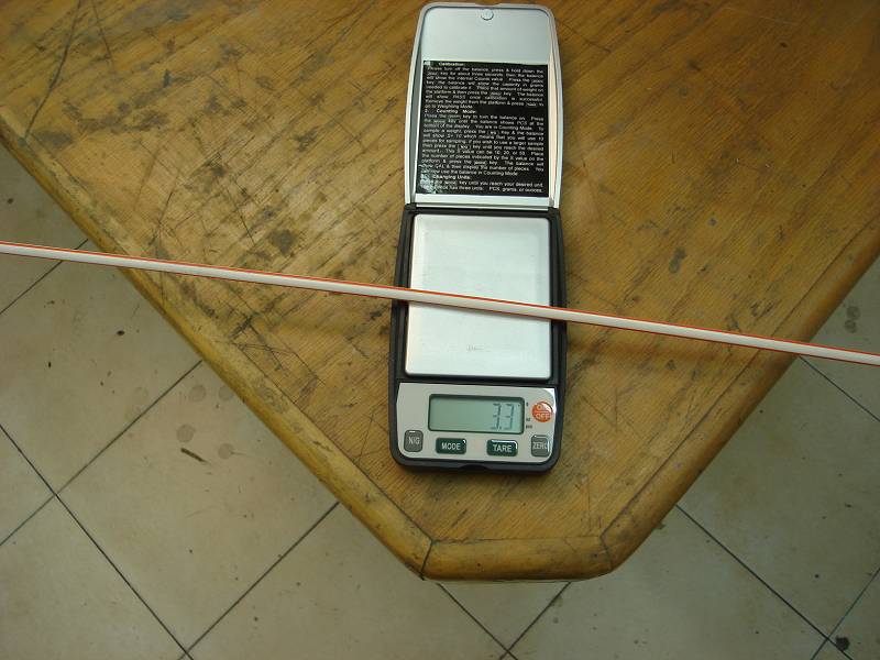

Saving 6 gram
Isaac Najary
ID:	829996   Click image for larger version
ID:	829997   Click image for larger version
ID:	829998   Click image for larger version
ID:	829999   Click image for larger version
Old 12-20-2007 | 12:45 PM
  #122
najary's Avatar
Joined: May 2003
Posts: 1,201

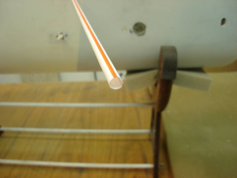

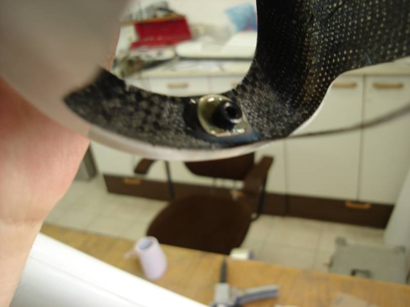

more
ID:	830002   Click image for larger version
ID:	830003   Click image for larger version
