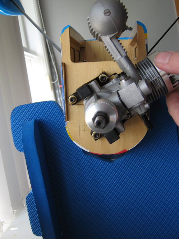

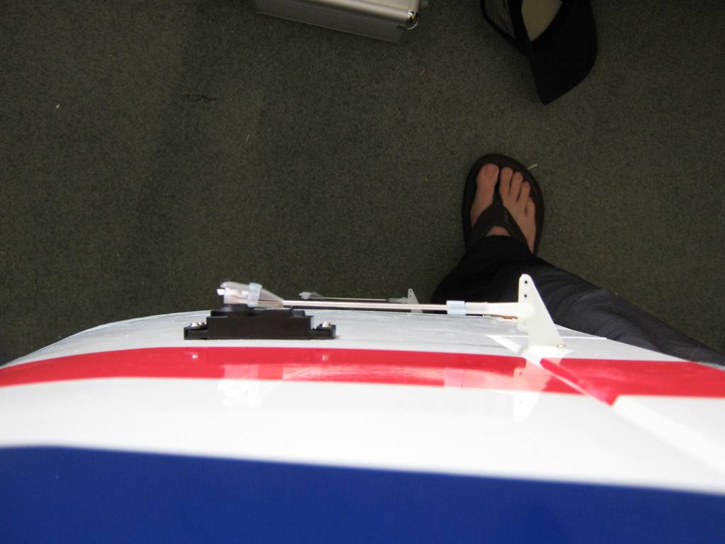

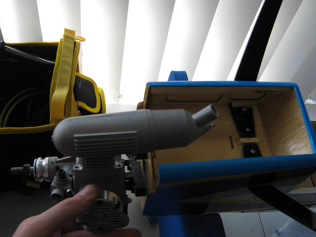

I hope the OP doesn't mind me posting my build as i go as well?
I didn't get much done today on mine, I got the tail gear mounted, servos mounted on the wing and got the inner servos ready, o and worked out the location for the motor.
As I'm on a budget I am using a .75 two stroke instead of the popular 4 strokes. because of this the muffler sticks out horribly on the side of the plane when mounted inverted.
What I have done is aligned the mounts so the motor will be at 225deg from upwards allowing the muffler to slot perfectly into the pre made exhaust section. The only down side is I need to make an incision for part of the head to come out of the cowl, but its only slightly coming out and will give reasonable ventilation so it would look better than a 70 size muffler sticking down the side
I will update pics later tonight as my camera has run out of batteries :P

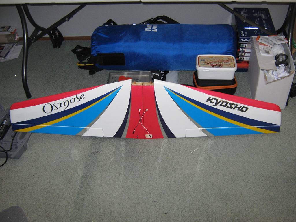

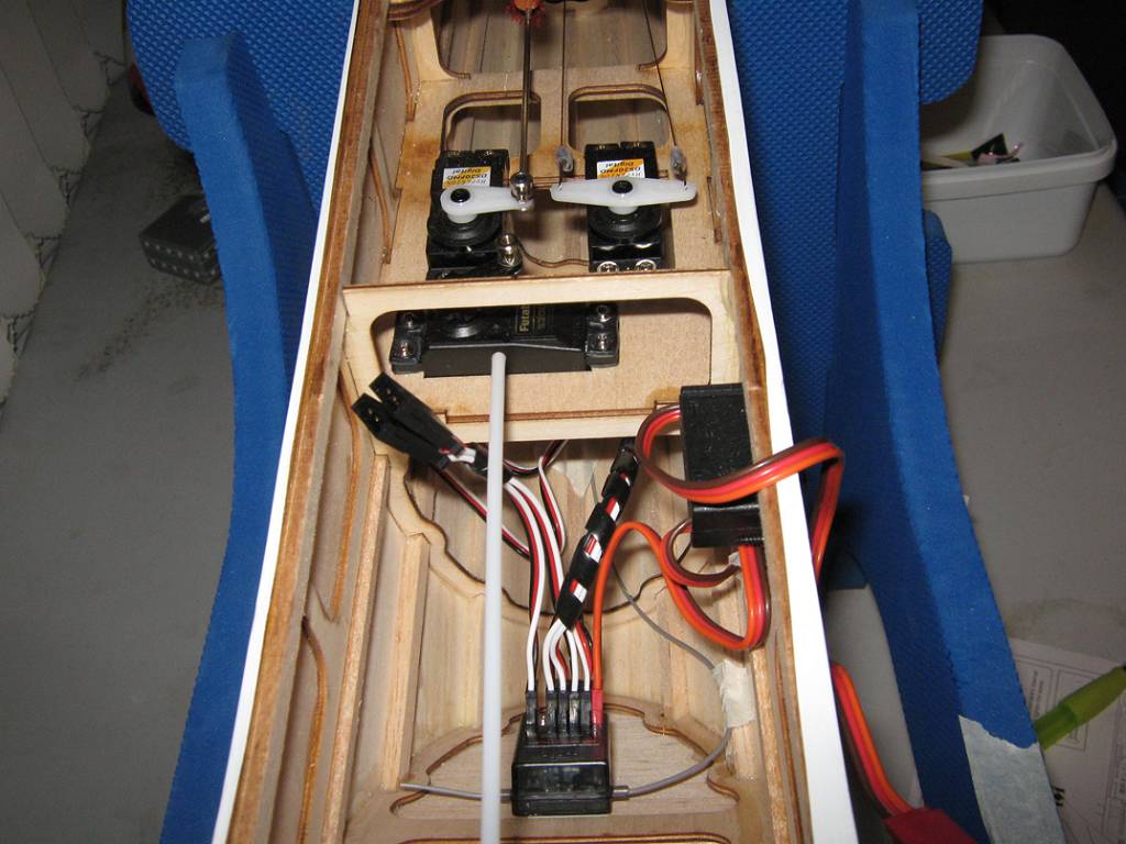

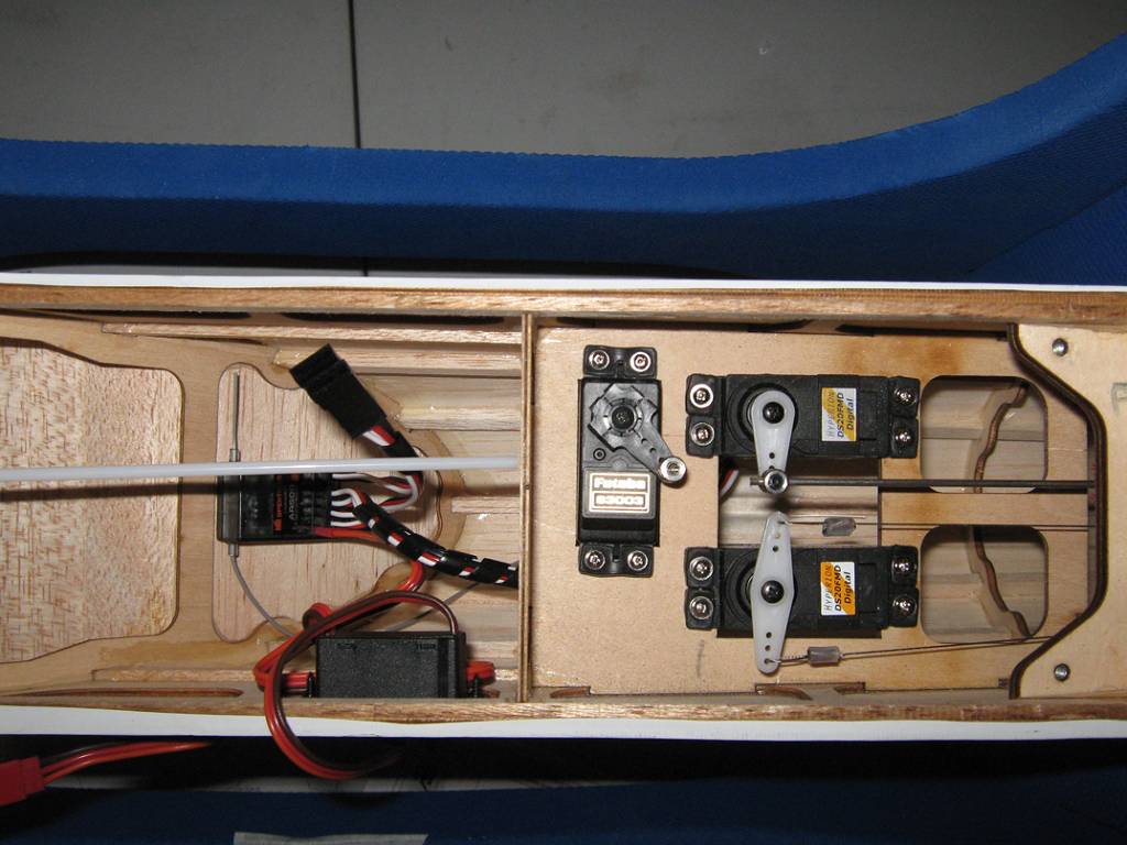

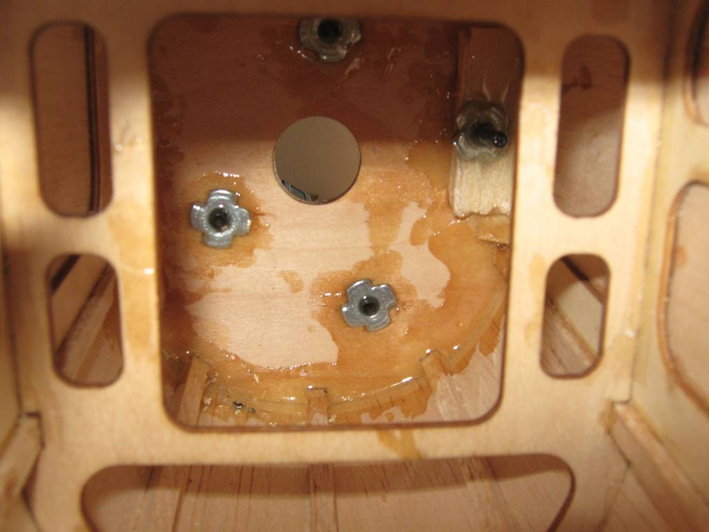

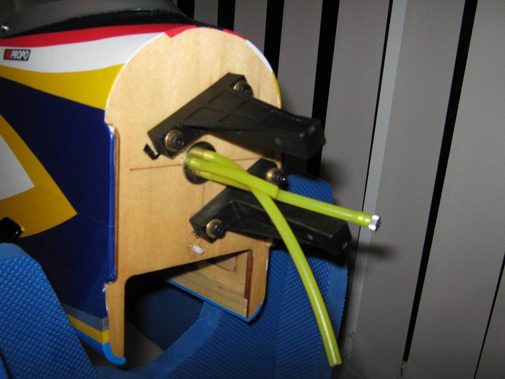

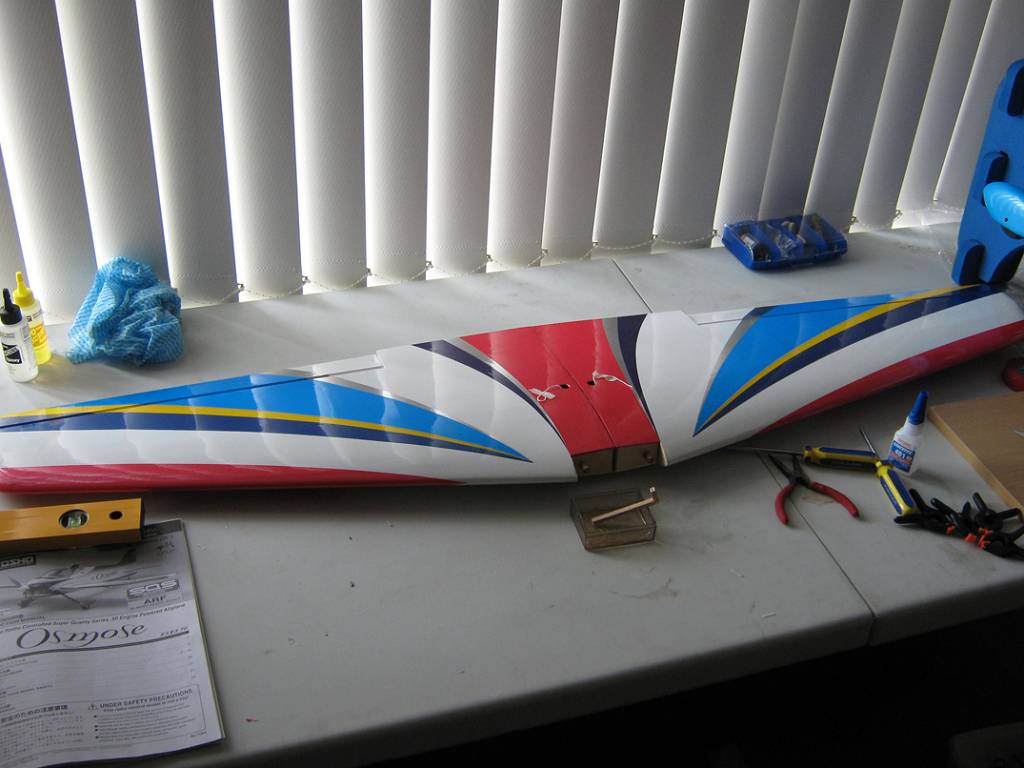

Well camera now has new batteries so I'll post up the latest pics.
engine mount secured and firewall epoxied, the firewall was a pain to get at but with some kiwi ingenuity and a long stick of balsa
I was able to coat all the edges, I cant for the life of me see the bottom edge but I am pretty sure its well coated.
Wing servos are mounted.
finally decided to put on some decals as well, Not gonna plaster this model as I think it will look really nice with just some stratigiclly placed decals. Just need to find myself a decal of the NZ flag for the tail.
L
I was able to coat all the edges, I cant for the life of me see the bottom edge but I am pretty sure its well coated.Wing servos are mounted.

#124

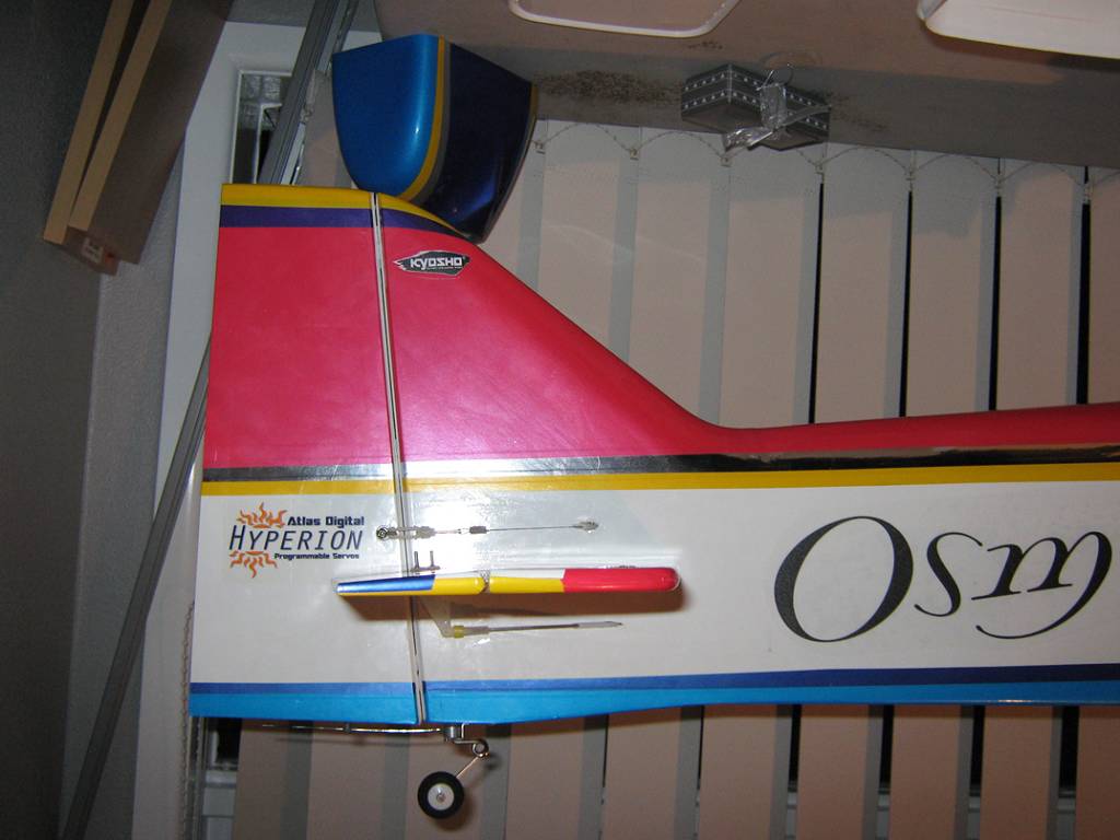

Its almost done, like 99% complete.
Just the engine to mount, Cowl to measure and cut and the CG and she's ready for running in.
hopefully only a few more hours and good weather will see this bird in the air.
Can't wait
Can't wait
