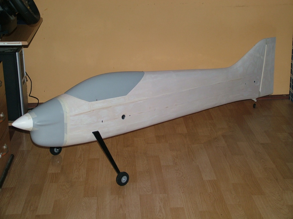

Old 04-24-2010 | 10:06 AM
  #138
Joined: Aug 2006
Posts: 520
Received 62 Likes on 28 Posts

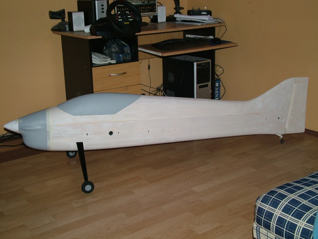

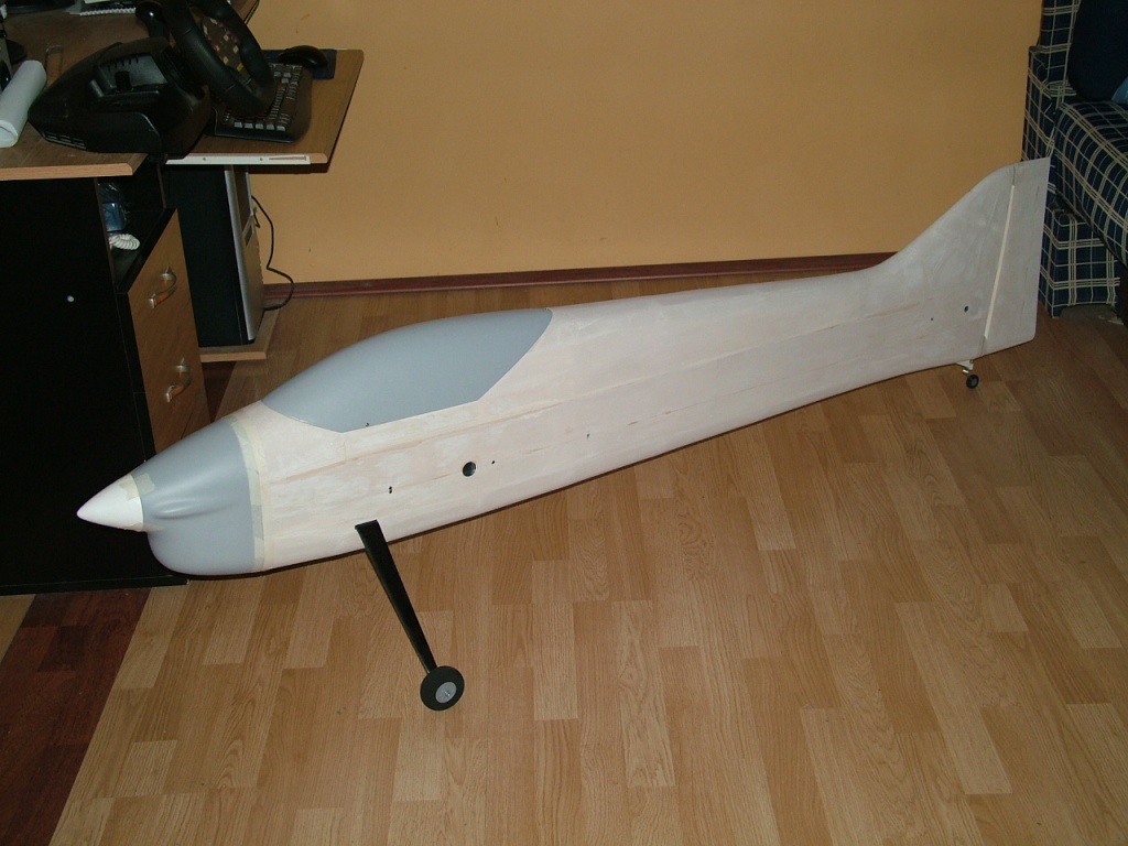

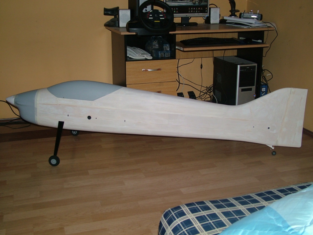

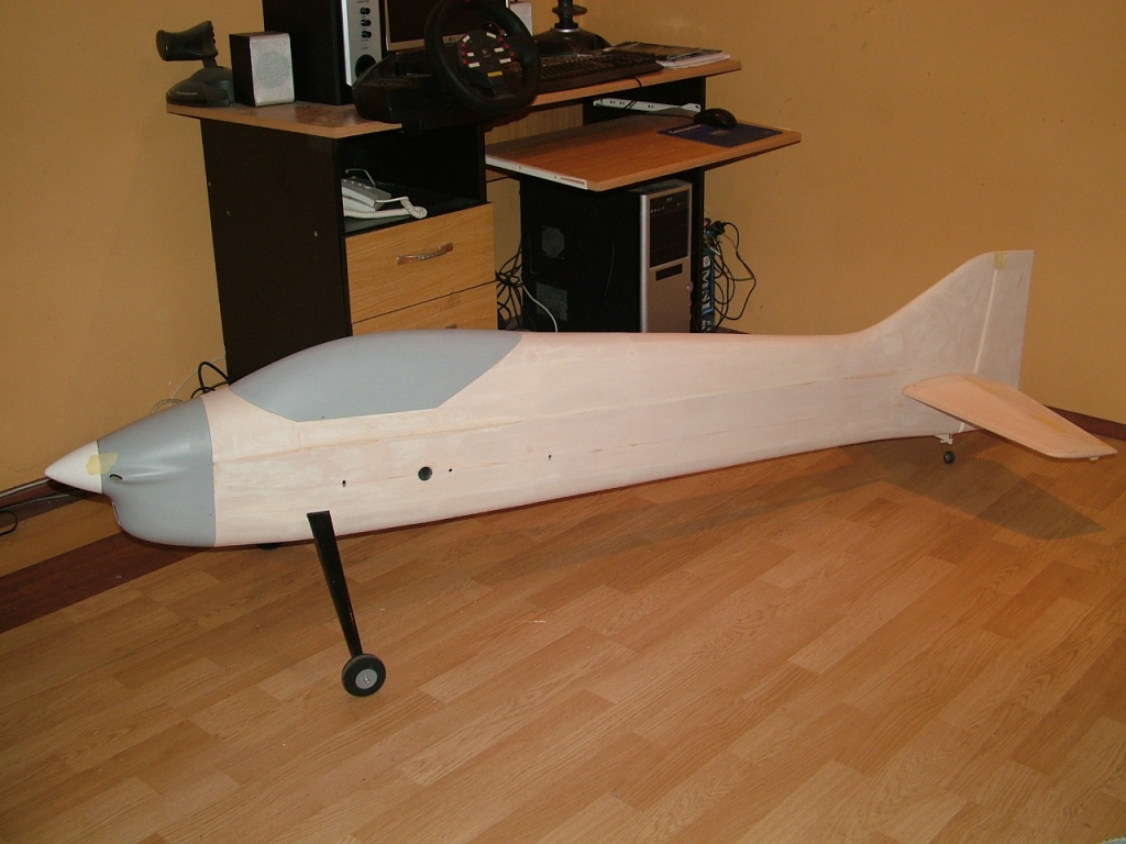

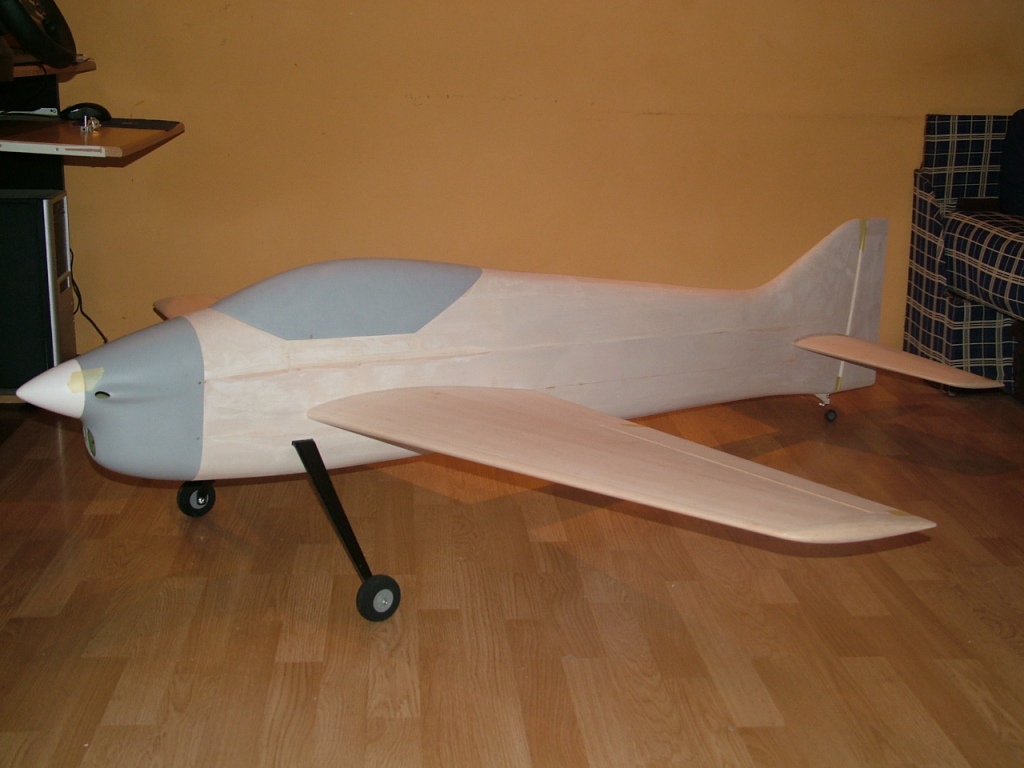

From: Trollhattan, Sweden
Default RE: Designing a new pattern model
I recently returned from my trip to France and started working on the model again so i'm back with an update. I have both bad and good news so here we go:
- The bad news: I really messed up the finishing process for the wood fuselage. Trying to fill all the gaps and seal the balsa surface, i covered the fuselage with a layer of dope and talc mixture. This worked perfectly for the rudder so i thought it would also work nicely for the fuselage, but it turned out it to be a bad decision. The balsa skin was softened by the dope and created slightly concave shapes in all areas where the balsa was curved and forced to follow the shape of the formers. To make things worse, this also results in a lot of added weight because it's difficult to sand the excess mixture in the concave areas.
The only solution would be to strip all the balsa sheeting and start over, but it would take too long and, as you will see, i have other plans. I won't give up on the wood version and the plan is to finish the fuselage as it is and get the model in the air as soon as possible. I mounted the landing gear and tailwheel and quickly fixed the canopy in place with a few screws:

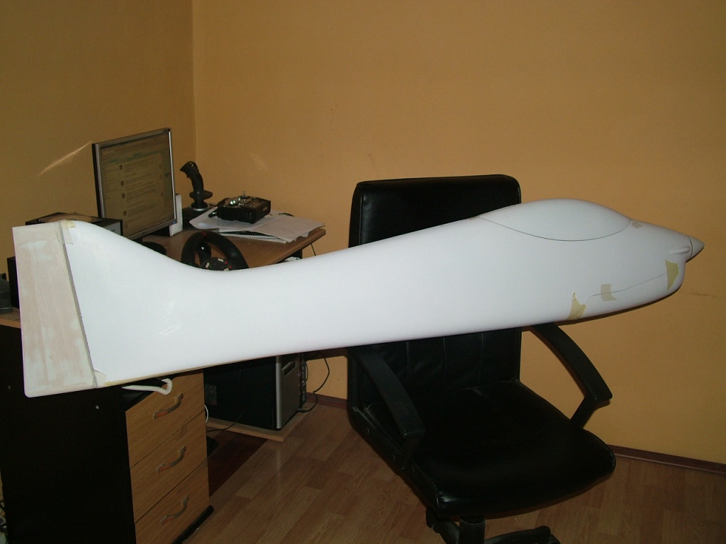

Old 04-24-2010 | 10:09 AM
  #139
Joined: Aug 2006
Posts: 520
- The good news: a full composite fuselage should be ready soon. The mold plug was made by me a long while ago and while i was away a good friend of mine finished the molds. The fuselages that came out from the mold so far are a little heavy (~900g), but we're working on it. We already bought better materials and everything we need for vacuum bagging, so i expect weight will soon improve.
I took a few pictures during the mold plug carving process, so maybe i'll post them here to show the main steps.

Old 05-31-2010 | 01:44 PM
  #143
Joined: Aug 2006
Posts: 520
And some news from the composite front: popped another fuselage from the mold, but it's still not good enough. I couldn't get the vacuum installation to work without leaks, but we'll see about that later.

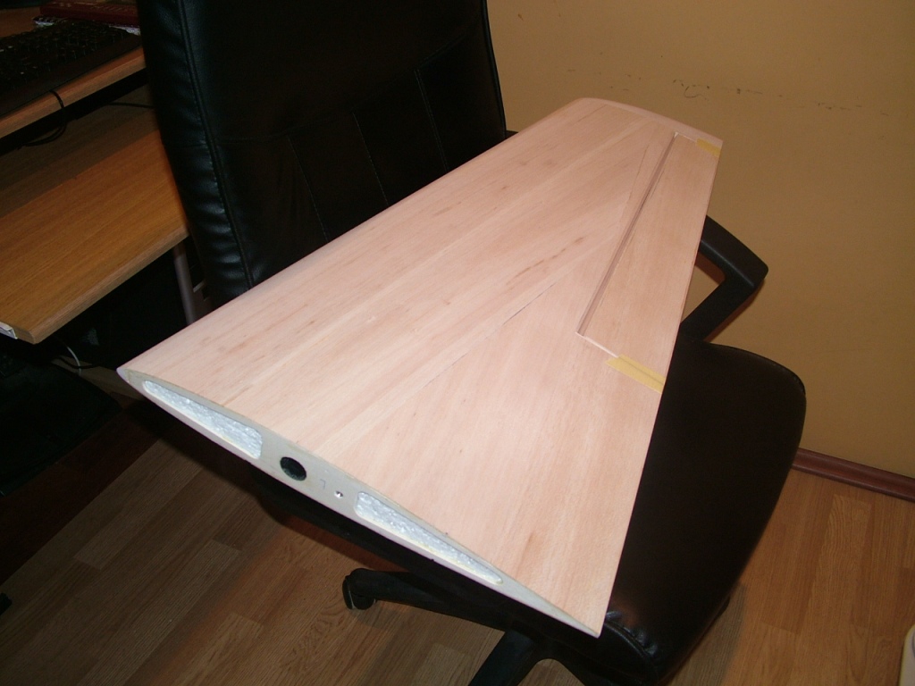

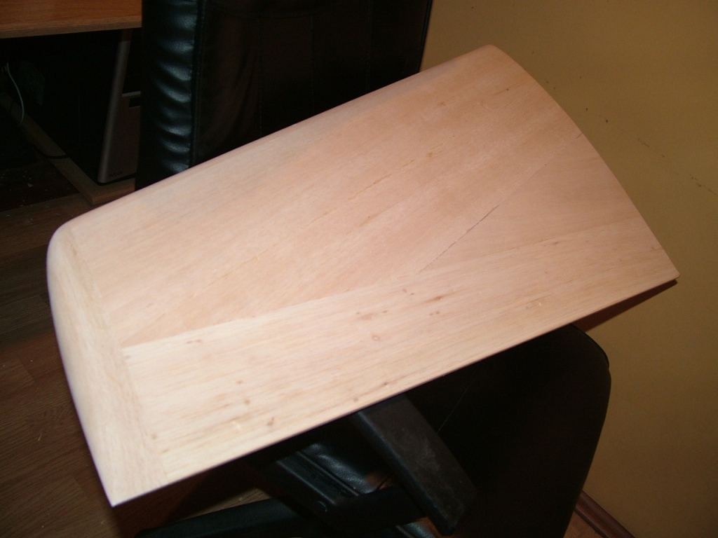

Old 07-01-2010 | 01:06 PM
  #146
Joined: Aug 2006
Posts: 520

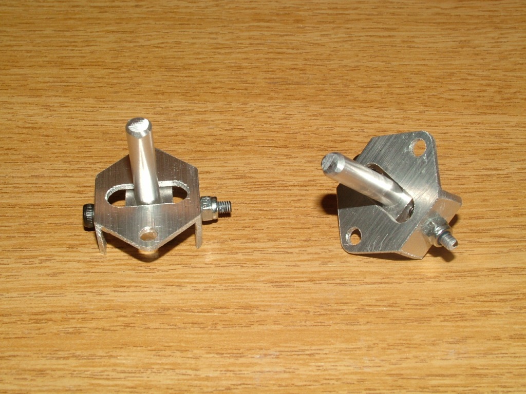

Wings took a little longer to build, but they are almost done now. I thought i got used to the size of the fuselage, but now with the wings in place the plane seems huge and i can hardly find enough space for it in the room. I still have to add the servo supports and the aileron hardpoints, but i'll do that later when the materials for the control rods will arrive.
The incidence adjusters i bought were junk, so i had to manufacture them. It wasn't very easy but with the help of a few friends who let me use a lathe and a small CNC machine, the result seems airworthy.
I took some pictures during the building process and i thought i'd post them here.
