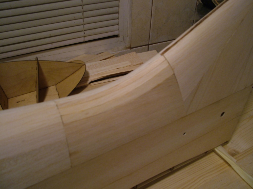

ORIGINAL: MarkGrabowski
Alex, is the balsa you used on the top, curved parts of the fuselage the same thickness as the flat sides? If not, how thick is that balsa compared to the sides...
Mark
Hi Mark,
Initially i used 1.5 mm balsa for all areas. Anyway, i recently stripped all the balsa sheeting and re-covered the whole fuselage. Flat sides are still 1.5mm, but this time i used 2mm balsa for planking the curved areas to compensate for the final sanding.

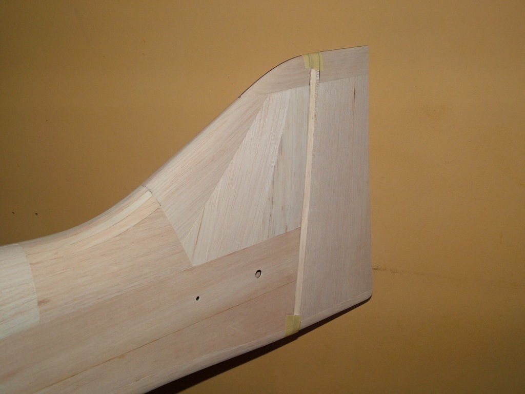

Alex, I really like the way you've blended the vertical fin and the top of the fuselage without resorting to the large chunk of balsa carved and sanded to fit. Could you please post a few more photos of this area, if it's not too much trouble? Thanks for sharing in this build!
Mark

The fuselage is now film covered so i can't take more detailed pictures, but i found a few old images. I hope it helps.

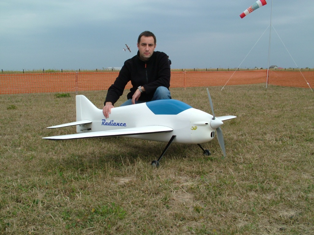

I finally took the model out to the flying field for the maiden flight yesterday. The conditions were not ideal (overcast, strong crosswind) but even considering the limited practice i had this year (only 6 flights with a foamie), i just couldn't wait any longer.
Take off was short and all the trim needed was 1 click of right aileron and 1 click of up elevator. First flight was a little shy, but by the third flight i was confident enough to try a knife edge loop. It went very well, probably just needed to add throttle sooner in the second half. With more practice it will be perfect.
Knife edge pulls a little to the belly, but i completely expected that having the CG so far back. Downlines are very slow, and even if the entry speed is higher the model actually decelerates on its way down. I forgot to switch to rudder high rates for most of the stall turns, so i can't comment on that at the moment.
I attached a few pictures from the flying field and 2 videos. First one shows the maiden flight, so it's a little boring and for the second i tried to gather more aerobatics from different videos. Don't expect too much from these videos, i was just flying around trying to get used to the plane.
