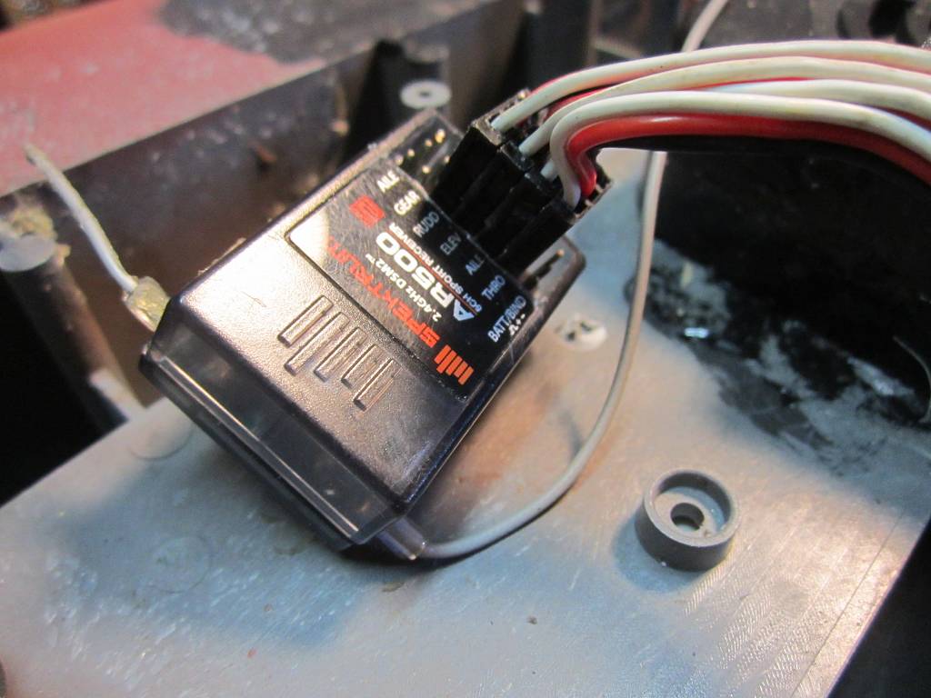

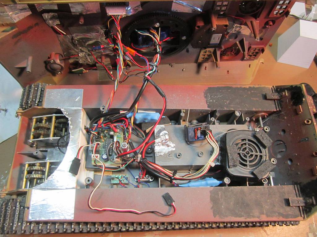

The battery is fully charged. Reads 7.86 vdc I have tried turning off the tank and controler to "reboot" but it dosen't help. Sitting over night seems to fix it... once, then if I turn it off and back on it goes haywire.
I will inspect the solder joints next as I have checked all the plug in connections.
Fully charged should be over 8 volts, I think mine are usually 8.4 when they go to trickle charge.
Anytime I had a glitch with it, it was a low power issue. The battery can still have charge, but if the tank is drawing heavy, it can be enough to drop, especially if you're using NiCads. I use the 1800 mAhs in my Tamiyas all day long, but the same battery in the HLs with 400 motors, metal tracks and gears, DBC and Benedini there's a lot of drain.
Once I switched to NiMH 4200mAh, never had an issue.

I tried a new battery and went through the configure mode. The LED's on the DBU light up for each option I pick, but the up throttle will not start it so I don't know if it saved the options.
Could my throttle on the controler be the problem?
It might be. Try changing up the servo connections to the reciever. ie. Change the throttle for the turret. See it if will start under the control of the turret stick. You will also be able to check your throttle stick, as it now will be lighting up the DBU LEDS
Did you check the three wire cable and ensure all connections are good. I had a wire break off one time and it was hard to see it was broken.
Your battery seems more then adequate, and if the above all checks out and the tank still won't start, try reheating the DBC solder poiints.

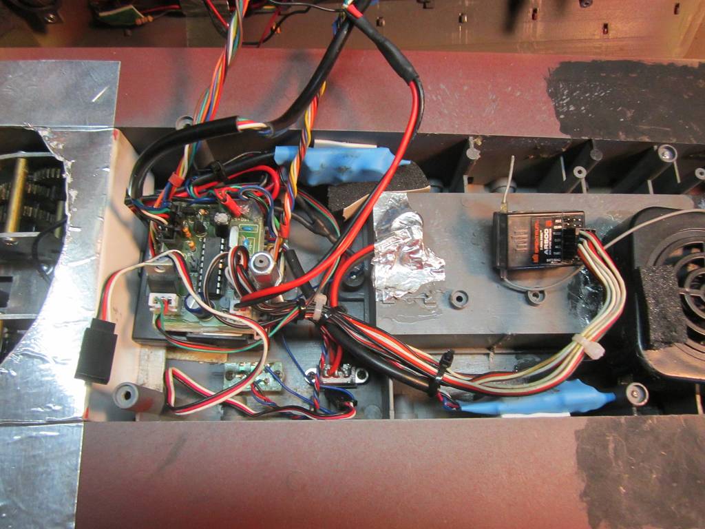

The three wire tests good with my meter.
I have reheated one solder joint on the board that looked bad with no luck. I am going over the others with a 10x loup. I have soldered miles of stuff so I know that a cold joint is a bad connection.
I'm going to switch the servo connections after supper.
OK.
I tried switching the servo plugs to see if it is the throttle stick on the controller. Nope. Still the same, just on the other stick.
I tried reheating all the solder connections on the board. No change. Before I reheated them all I looked them over with a 10 x loup and my OptiVisor, andI must say thatPhil does nice soldering. Clean, without too much solder.
I'm going to unplug the battery for the night and try it in the morning. It has fixed itself for the last two mornings, then the Gremlins wake up.

The battery read 8.42 volts before I ran the tank and it reads 8.16 volts now. I will try what you said and see what the voltage drops to under load.
No voltage drop with the throttle stick up, should start the tank. .02 volt drop when I fire the gun. The only control that produces a voltage draw is the fire command... Battery at 8.15 volts now.
You might try running some wire. Perhaps one of the traces on the board has a hairline break. I would start running the ground from the 3 wire receptacle to the Voltage regulator on the DBC, and then to the ground point on the Chip. Without a proper ground all kinds of things can start happening
Perhaps the temperature is playing into the trace problem. Maybe when it warms up something opens up and a connection is broken , By paralleling the key connections with wire you may solve the issue.?? Just something to try.
