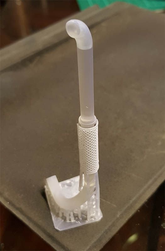

3d printed truck exhaust stack.

That looks really good. As good as shapeways. I'm still trying to get the LD 001 to work right. Today is their absolute last chance. I tried to tell them the problem was in the software and they needed to send me new software but they didn't want to do that, instead they sent me a test file that they had sliced over there in China and when that file would print they said that it proves the printer is okay and the rest is my problem. I replied that I always knew the problem wasn't in the printer but in the software and if that was their solution I would open a claim with PayPal, which I did, yesterday. Yesterday creality was notified that they have 10 days to respond to my claim and this morning I got an email from them with a link to a site where I can download new software. I'll try it after work tonight but if it doesn't work I'll let the PayPal claim play out.
Even if this works, I'm still considering buying a d8. The print bed on that thing is huge for an SLA printer. With the creality I could probably print 8 tires at once, but on the d-8 I'll bet I could print at least 20 at a time.
