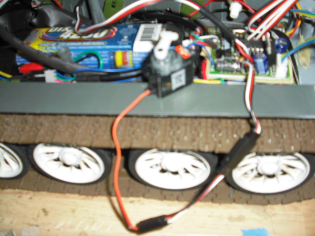

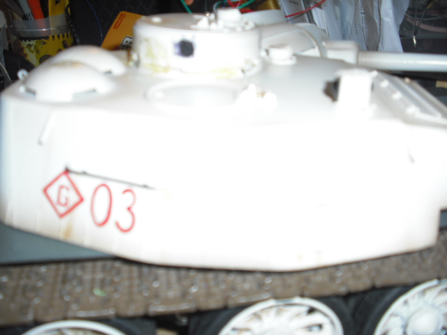

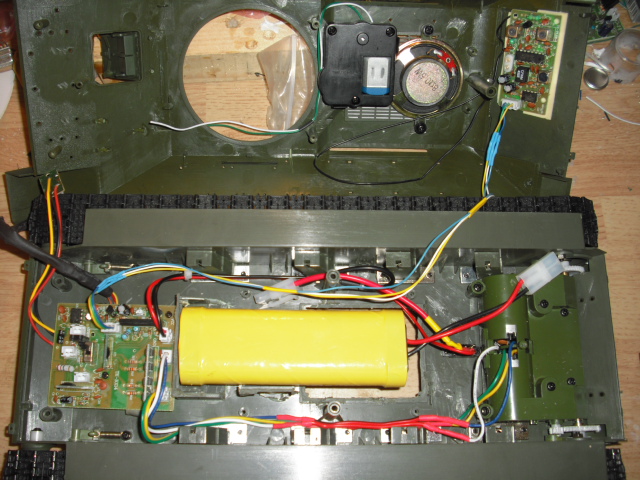

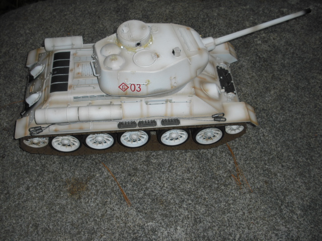

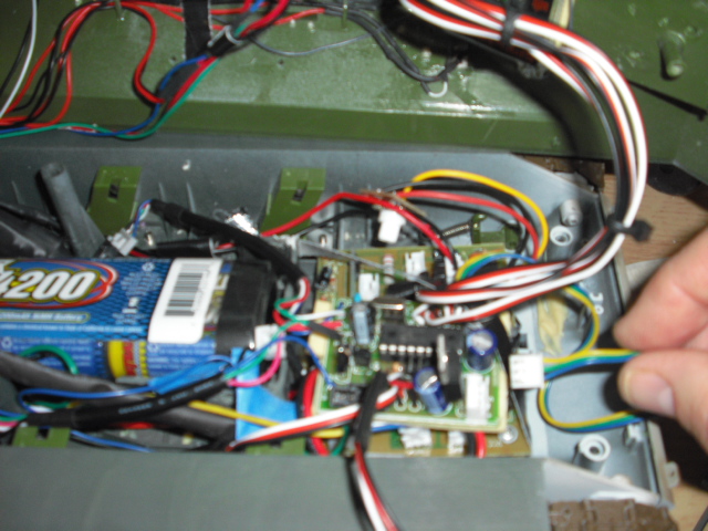

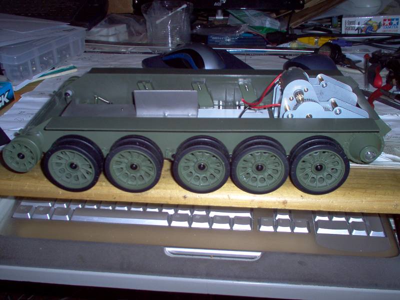

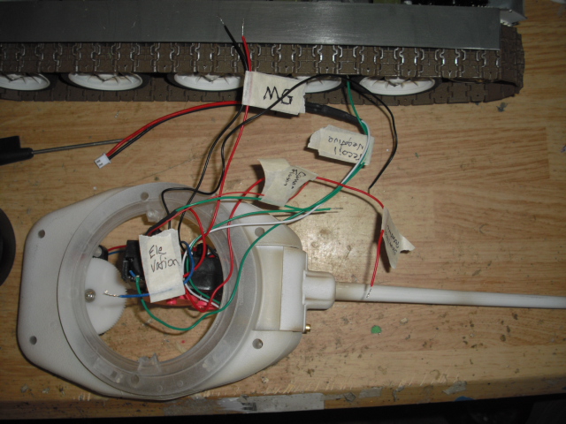

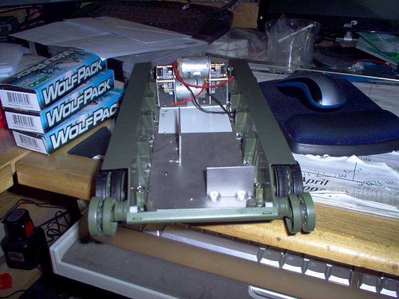

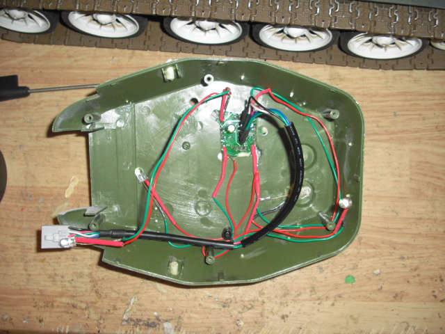

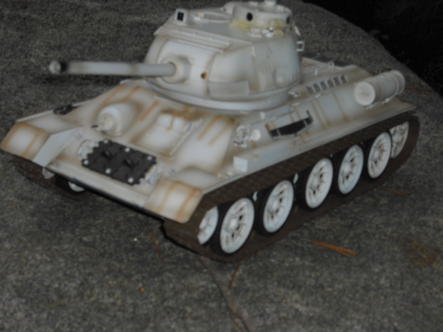

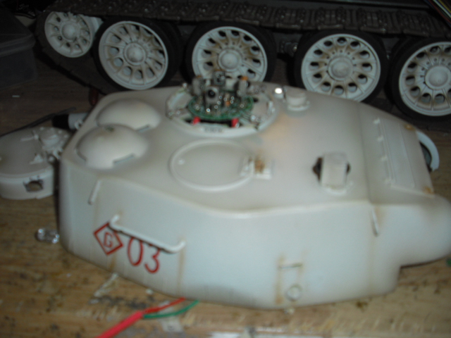

Hey Guys,
The Winter T-34/85 has the Heng Long RX-14 upgrade and with the use of the DBCRC2 I am using the DX5e radio with the BR6000 receiver!
The main thing for this post is to show cases the DBCRC2 and its capabilities! Also I will be showing in what needs to be connected where,
and doing a couple of videos! One to show the functions and the 2nd to show the programming sequences!
You can remove the Heng long Rock, and just have the barrel cannon recoil!
You can have true inertia proportional drive!
You can add 3 unique sounds to your tank! Hit, Cannon, & Death sounds!
You can now use a Hobby radio now like the 2.4 GHz DX5e, to me, which is perfect for this DBCRC2 because it offers you 5 channels!
It is also a Tamiya compatible battle system, with 3 different weight class settings, and reduction in power to the tank as you take hits and LED registering the hits!
Now this is where I have done some thing unique and Blitzed out the tank! I have installed the DBU in the TC hatch and added some extra lighting! I still need to sand and repaint!
Here are some pictures of how it came together! The first and second picture shows how you can set it up with the standard Heng long receiver and radio!!

I have a few photo op pics, but the pictures below I am trying to show you how you connect your new DCBRC2, notice you still use the Heng long 3 pin data cable that use to connect into your old receiver, it now connects into the DBCRC2 board from your HL RX-13,14 or 18! The first picture shows how you need to piggy back your wires to use the 2 Sound card setup! The forth picture shows you can hook up a servo to the 5th channel! I could have use that for the recoil, but I chose to use the WSN, now I can use that servo for something else?? [sm=50_50.gif]And video below is show casing the 3 unique sounds, and no Heng long Rock,,, the hidden DBU with extra lights! I will make the instructional video of how to program the DBCRC2 hopefully tomorrow!

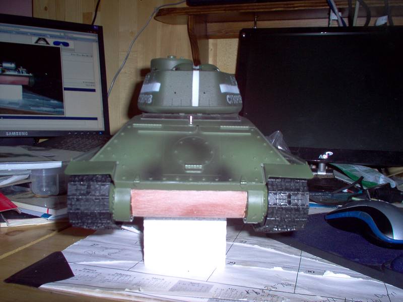

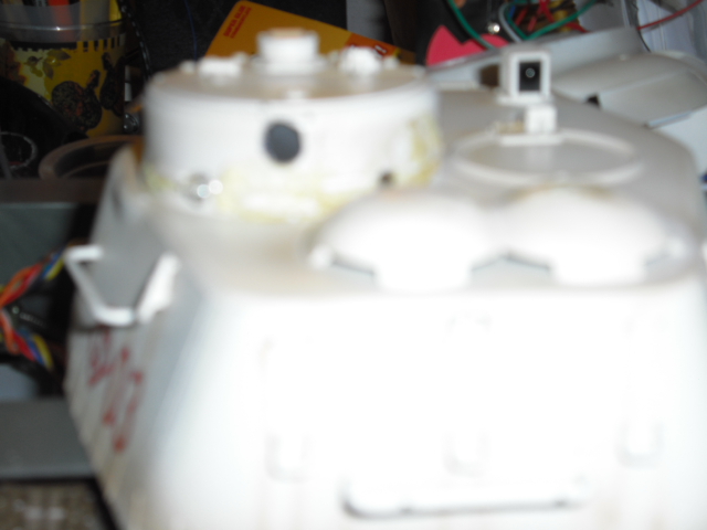

Would that of been one of mine you were setting up Phil cause its going into a T-34/85 the green one .

yep going to close it I have some flexable styrene im going to try on it see how it looks then ill post it here .

Hi Phil changed my mine took a old pill bottle and cut it down to size with a dremel cutting wheel for the rear cover if you do this gearbox replacement make shore if you drill and tap the shaft that its level same with the T-34 wheel pins off just a little and the wheel will wobble .

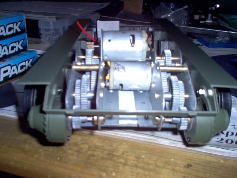

Nice stuff. Have you done anything in the gearbox to reduce/eliminate that horrible gear hop that likes to happen in these things? Thats the only thing keeping me from driving mine regularly. It seems that the axels just need some shimming to keep them tight.

the new black steel gearboxes that Bill at Rc Command has seem to be built with tighter gear spacing and may not have that slop in longer use as the silver gears do .
