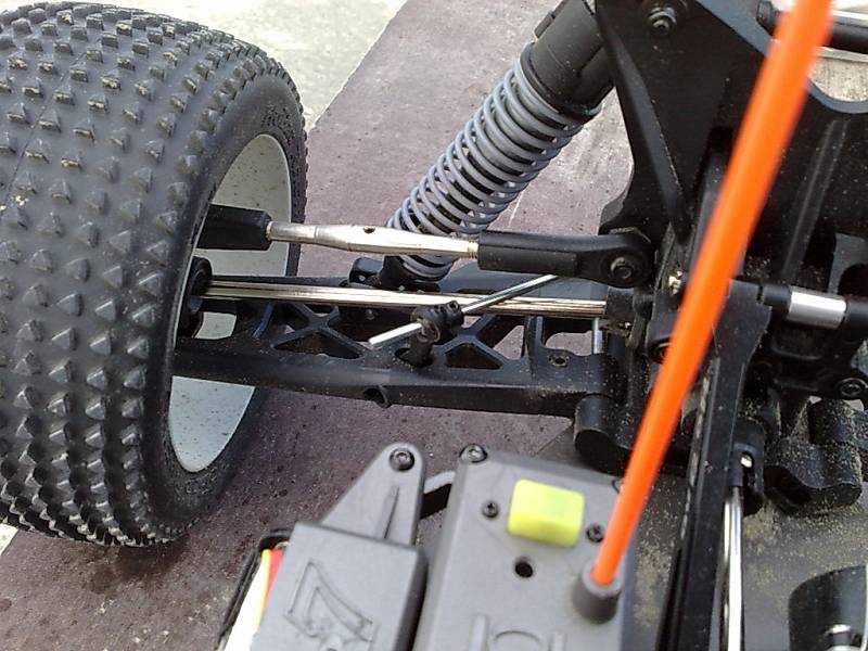

Well Its All Broken In
This thing drives GREAT.!
I really like the way it lifts up the rear inside wheel while turning, looks cool
Just a few questions again.
Can I wash the wheels + tyres, Theres so much of grease + drit on the rear left tyre + wheel, because the exhaust gasses get blown straight to it.
Second is there any way to stop the body from melting onto the exhaust.?
Thanks Guys

20% simple green will leave it looking brand new, the key is let it sit on there for a minute, then rinse. take off radio tray and engine then spray and hose off, wd-40 and done. the pipe looks like its sitting a bit hight, try lifting the header and have the pipe more horizontal, it rests on the side guard, melt that instead.

The truck is clean
Only the Rear Left tyre + wheel is disgusting because the exhaust blows the smoke into it.
So is it safe just to wash the wheels + tyres.?
Yeah I cant get my JP 4 to go lower down.
Have tried everything,.
It hasent even seen dirt yet [:-]
I just brushed whatever lil' was on it.
My only complaint with it is the brakes.!
It really needs better ones.
Ill try re-adjusting them now.

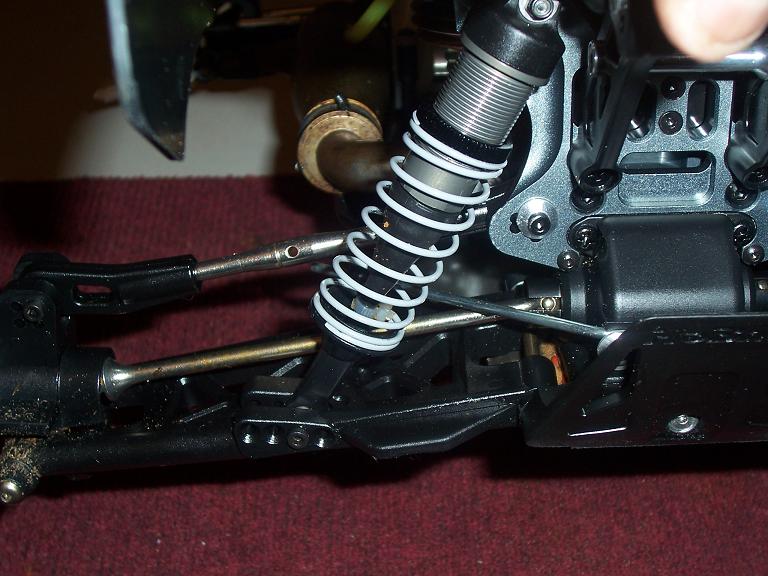

here's a couple shots of the mods i've done. 8.5 c-hubs, brake horn, hub extender locks (my favorite, no more 3 wheel action), losi 8 shocks with extensions (still need a little work to get full down travel), radio box, ace and hitec servos and sts d21b with dynamite 007 HT pipe and header.
