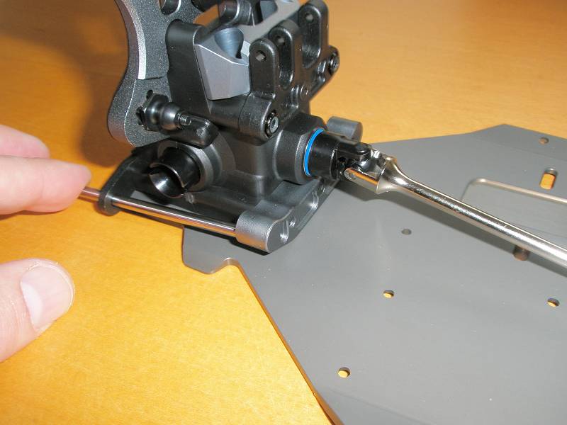

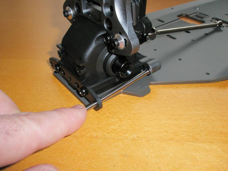

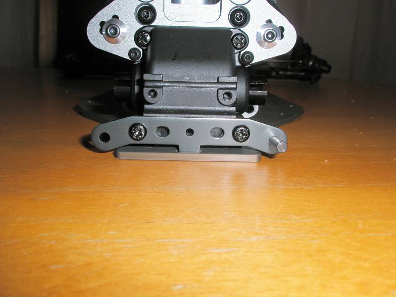

Hey,
Ive hit the next problem now! The holes for the shaft to connect the rear lower arms to the gear box dont line up. Ive checked and re-checked against the manual but I cant see that ive done any thing wrong.
Has anyone else had this problem? Or can see what ive done wrong?
Cheers

ORIGINAL: droidswarm
Hey,
Cheers
YIKES! I have to believe that's the wrong suspension mount block you have mounted in the front (plastic part). Have you checked it against the other diffs, like maybe the rear? Just maybe you have the wrong suspension mount block there.
Keep us posted!

ORIGINAL: PatrickBW
I think mine was similar, and I checked and checked too.. Can't see your pics too well CUZ I CAN NEVER SEE PICS on RCU anymore............., but it does look kinda bad..
Patrick - How did you sort it out?
Still cant see what ive done wrong. The plastic suspension mount block is the only one like it in the kit, and the rear one is exactly the same shape and size as the rear one so cant be wrong. Can someone please compare the photos to their ST to see if you see any differences?
Thanks and Happy Christmas!

wrat said his were the same.. I guess it's normal??
Old 12-23-2007 | 03:51 PM
  #394
Joined: Jun 2007
Posts: 239
From: Chinnor, UNITED KINGDOM
Default RE: the hyper st PRO thread!
It cant be normal, the holes are so far off I cant get the shaft in!

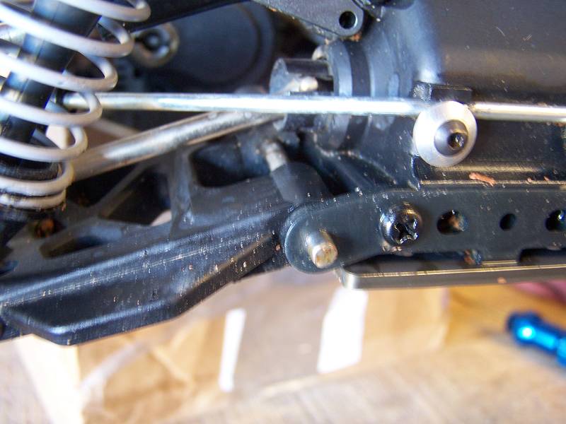

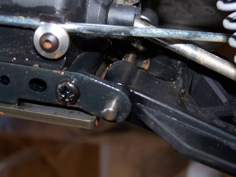

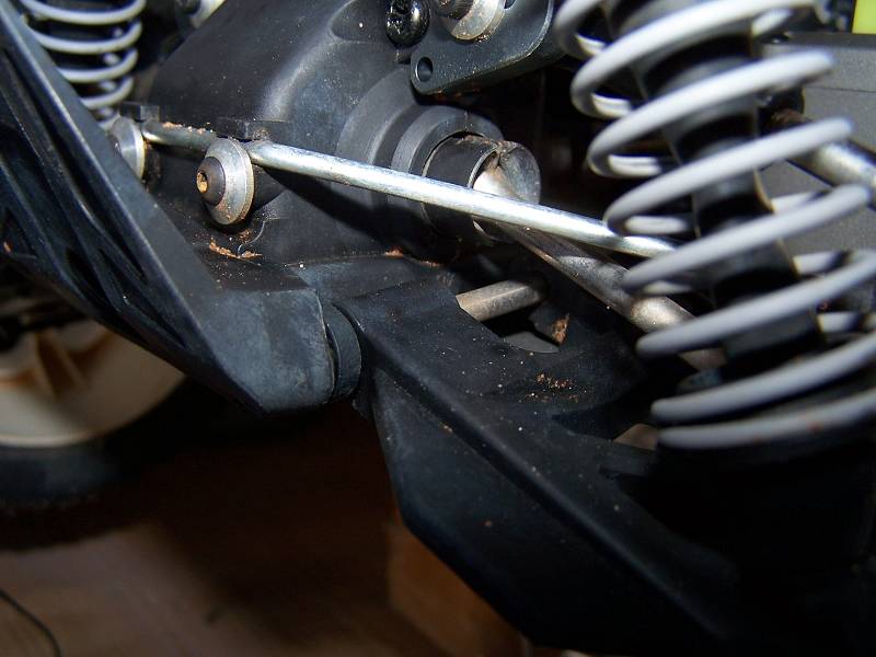

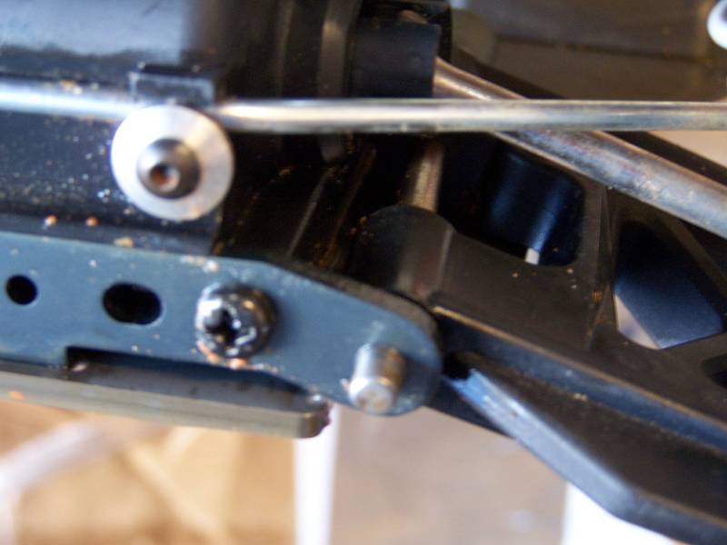

Mine is the same way. Here are some pics. You can see that the shaft is at an angle and not straight. That is the way it goes.

just bend the rear arm mount a bit or drill the whole a it bigger. try installing it with the arm in place, should be easier then.

Thanks alot for that VNMSGT - A legend as always!
