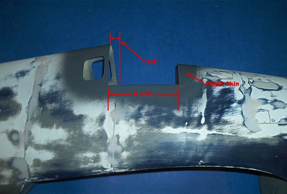

Some of what I have been up to, lot's of slow work! I sanded the fuselage down pretty good, lost some weight there. Cut much of the ply junk behind the servo tray out. Extended the cockpit and cut the small windows. I'm molding a scale cockpit kit for this plane, it's for the hard core ARF basher really. I don't expect to sell many for this plane, but it will fit other 1/8 scale Hellcats. It's not a lot of work bashing this plane, working with a glass fuselage makes things much easier, so for me it's not much trouble at all to add details.
I also added a ring of balsa to the cowl lip and sanded it back quite a bit to make the opening bigger and more scale shaped.
Also on the fuselage I patched the openings for the stock pushrod exits, the rudder one is especially unsightly! I just used small pieces of glass cloth saturated with 5 min epoxy. Just make sure you sand the inside first. Hal is a little ahead of me on the fuselage panel lines, I'll add those next after I fill all the other stuff on the fuselage.
I finished my landing gear extensions and have them installed, the hit the trailing edge piece! It will sit higher and help make clearance for the drop tank.
I will be fixing the cowl lower intake!

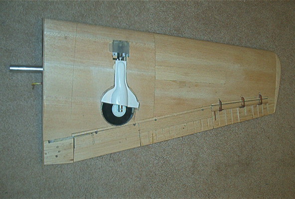

Well I guess I'll add one more flight report. Mine got maidened Thursday in the AM. Had already set up to take the day off work, Fentress was open so off I went. I had previously set up the engine and retracts, so with some final nervous measurements of flight controls and a range check, we were off.
Taxied out, final control check and lined up on centerline. Opened the throttle and we were off. Some rudder to keep it straight and the tail was off and flying before ai knew it. Ran it along to get some apeed then we were up and off. The 120 with the 15x6 is a good combo but not all that fast, will be looking for an 8 pitch prop to keep ahead of the Zeros. Just a couple clicks of elevator and alieron trim and it was flying hands off. I was a little concerned about the stab incidence, but it seems fine. I did notice a tendency to roll in a loop, might need to tweak the elevator setup just a bit. Went high and did some stalls, definetly a warbird! Drops a wing pretty abruptly but gives plenty of warning before it does it. A couple high speed low passes and it was time to get in the pattern. Since I have approx. 12000 feet of paved runway I elected a no flap approach. Got in the groove and reduced power, the plane settled into a very nice decent. Flared out and touched down... OH MAN a bounce, but rught back on. Just a little too fast on touchdown I guess. Very nice.... The second flight I was able to pay attention to things like the retracts going up, and try some more stalls with gear down. Al in all seems to be a very good flying plane with few vices. I got the second landing a little more on-speed, but the plane certainly seems to have more lift than it needs. Next time out will have to try some with flaps... wind came up and I decided to switch over to the CAP.
I did notice, however, the CJ retracts didn't seem to hold air as well as my Robarts..... My P-39 usually has air left in the gear from the previous flight even after an hour or so. I don't think it's a problem in the air, but just something ot keep an eye on.
All in all I'm very pleased with it...... I'm really looking foward to getting the 120 better broke in so I can rev it more and put a little more prop on it.
Andy

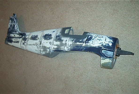

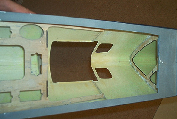

I finished up the final dimensions for the cockpit, shown in the first picture. As stated before the canopy will fit the standard plane with no modifications, but if you want a scale cockpit you will need to move the cockpit back 3/4" and then cover the front slanted panel with some Flight Skin. It's just a fiberglass sheet .012 thick, great stuff!

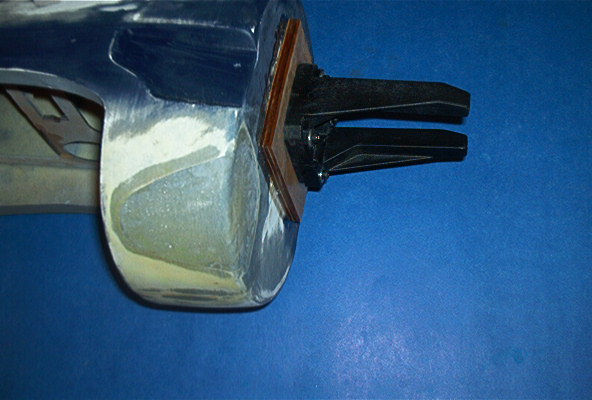

I also filled the giant hole for a muffler at the firewall, just used some florist's foam and sanded it to shape. After glass cloth and resin I sanded it smooth.
Hal sent me a template for a ply former for the cowl, worked great. I just rough cut the inside so I could adjust it. I mounted the cowl further back so the nose doesn't look so long, can't do that with those big 4 strokes. I still have to open the areas where the cowl flaps are for cooling. The mounting screws will be inside the cowl also.
Next will be cockpit floor and cockpit, panel lines, glass wing and mount to fuselage, attach tail group and paint!

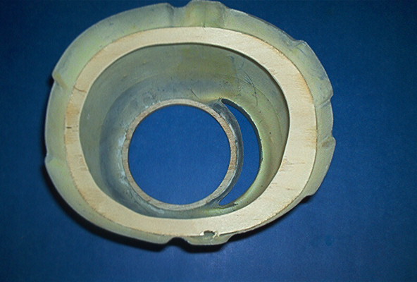

Default RE: CMP Hellcat
This shows the usupported shape of my cowl and with the lite ply installed. The ply makes the cowl much more sturdy. Any one who needs a pattern I can provide it via email. Incidently , the Brian Taylor 64" Hellcat cowl fits the CMP and I used it to make the first cut.

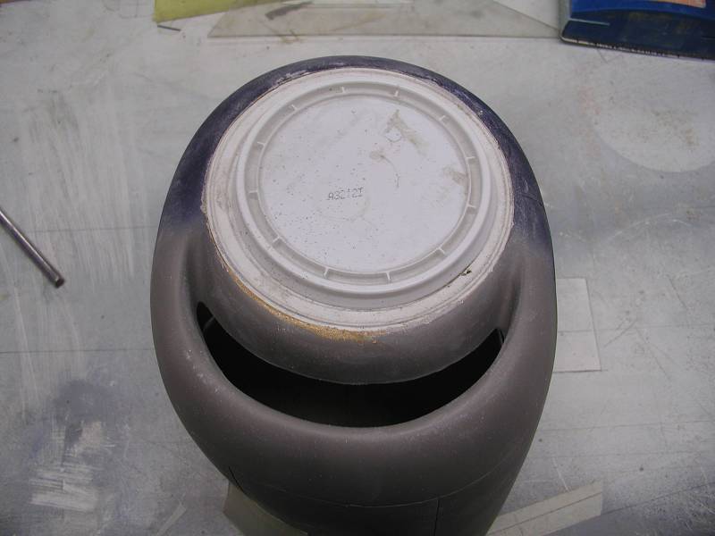

I've finished with the cowl modifications for my engine cooling strategy, I used the 2 lower cowl flaps. Using that great stuff Hal told me about called Flight Skin, I cut new cowl flaps. Thought if I'm doing the bottom ones may as well do them all so they look the same. Always thought the top ones especially looked lame anyway. The top cowl flaps are just for looks, no air passes by them, all that is done by the bottom flaps. I stuck some more foam behind the firewall and cut it down so lot's of hot under cowl air can get out. The rest of the plan is to use the dummy engine as a baffle to direct air directly over the engine. The cowl mod really helps the look of the plane, can't wait to see it in it's colors!

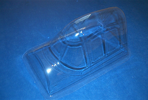

Andy, I am just now finishing the production plug for the canopy, it needs to dry completely or it could get damaged. I'm shooting for some time later this week and it's looking good, thanks for your patients.
