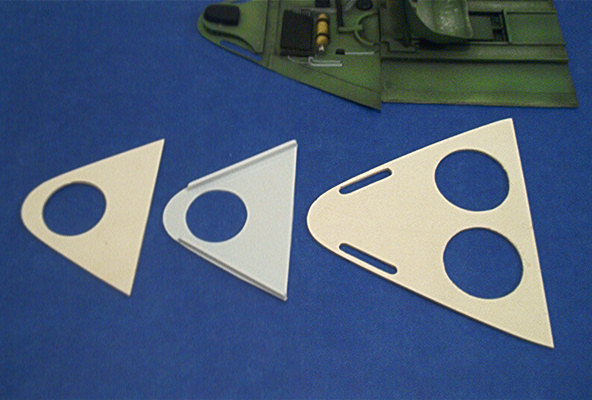

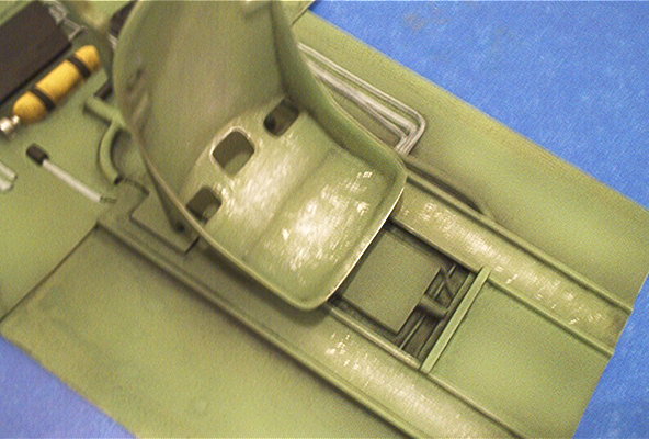

OK Cat lovers, got some real Grumman art for you. I've been working like a mad man trying to get this cockpit thing done! Thanks again for all the compliments, appreciate it!
I'm using an O.S. .91 on my plane, so can't help with props on yours!
First are the basic parts, not quite done with the instrument panel, but it's close. Got the floor and back armor plate, along with the former that is behind the little windows.

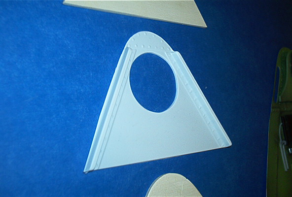

Bet you would like to see them painted?! The back panel is loaded with what I call FREE detail! It don't cost any in weight so why not add it? Can't see it that well but it is visible because the seat sits back away from the rear former.
More to come....

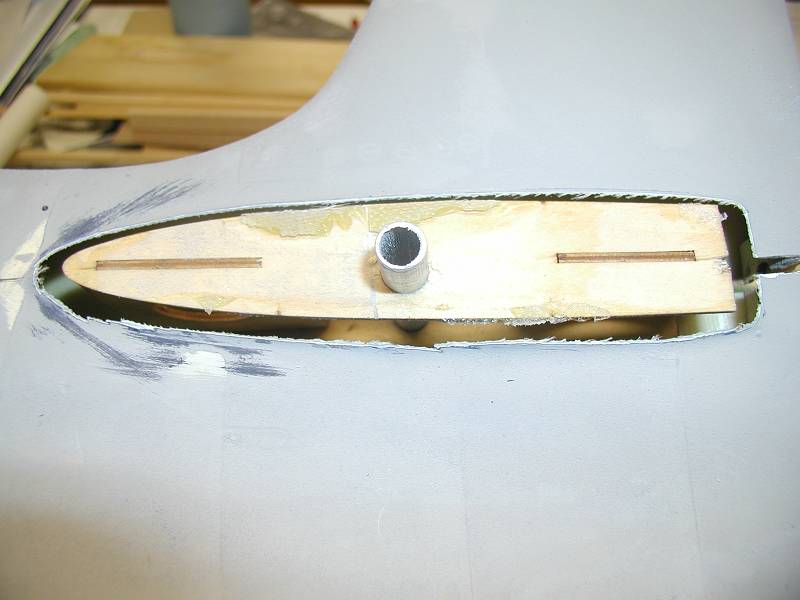

After temporarily mounting my stab, I found that they were not lined up with the wing, and that they were too long. I then cut the raised area away from the fuselage and found a ply framework mounted between the fuse sides that was only glued in a small area on one side. I removed it . Next I inserted some foam blocks to fill the hole in the front . Next I made two pieces of 1/16" ply that matched the stab airfoils and joined them with small ply pieces I was then able to set the correct incdence ( 90* to the rear edge of the fin ). Next I filled the remainder of the holes with foam. The foam was then given a fiberglass coat. From there is was just a matter of lining things up and gluing, filling and sanding. More pictures to follow.

More stab modification pictures.

ORIGINAL: HalH
This is Hal's plane, is he crazy or what? I might have to do that!

Nice job Hal! I looked at your Horizontal Stab fix for awhile, and you inspired me into trying the one piece stab slide in...
Transfer a cut pattern from the inside rib on to the tail section on both sides of the fuse, and make your initial rough cut. Next, make a center section for the horizontal stab and build the stab as one piece. Then, just slide it through. May have to make a few adjustments to get it where you want it, then Gorilla glue it on the insides and add a little filler on the outside. Next add the elevators, etc...
I'll let you know how it comes out!
