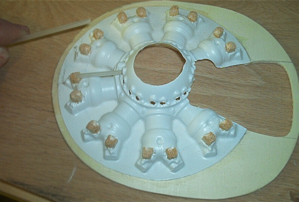

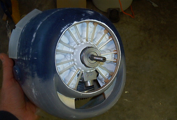

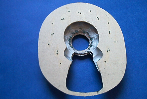

Decal for an engine? LOL No offense Richard to your work, I know for you it was a quick fix and something to paste to the baffle. The electric small scale guys do this all the time, they can't afford the extra weight. You're right it is no dummy because it's nothing but a picture. Not cheesy? Well I would disagree, welcome to RCU!
I'm mounting my cheesy engine to a ply former that I will glue to the cowl. One of the advantages to a 2 stroke in this particular plane is the short crank shaft housing, I was able to move the engine back more than 1" in order to shorten the nose. A disadvantage is the same thing! When it comes to mounting a cheesy engine it has to be mounted so far forward, but this is just a sport plane anyway!
Now here is what I did, not only did I go with the cheesy engine but I went with extra cheese! Just the way I like it! I glued the engine to the lite ply and added some CA and Micro-Balloons to the inside. Also I added a balsa ring to the crank case for extra support.
Then I addes some small pieces of balsa to act as pushrod housings, then cut some pushrods out of plastic tube. Then just some electrical wire for the spark wires.
Paint the black backround first, then the cylider heads, crankcase and pushrods then the wires.
Dion

Here she is...

I would have to say that both engine replicas have their advantages......
The picture is good for those who may not expect to have the arf long, want to save weight for electrics, dont have the time to invest in making the dummy radial look right, or intend for it to be a daily flyer and just dont care.,,,,
while as the dummy radial is more scale up close and personal and shows time/skill..... I think most people dont take the time to properly detail the dummy radials.
Both have their purpose.
Nice build!, looking forward to seeing it completed.

I agree with almost everything you say, in fact you repeat some of my same points. As soon as the picture gets any glare or is looked at from a side angle the illusion is lost completely. My point was that I totally disagree that a picture is better than a 3D dummy engine. That is my ONLY point, anything else is extra chatter. His post was directed at my engine, that is why I felt it needed to be addressed. If you take a plastic dummy engine and just paint it black with a gray crank case it will look great and the illusion will be the same from any angle, so I disagree with you on that point and on the point that a picture is a dummy engine, it's just a baffle. I want to say that I don't care what people do, but that would be insensitive and I'm trying to work on my sensitivity! I just had to correct a trolling nOOb!
You bet I will continue this thing, cockpit is going to be nice!
Dion
