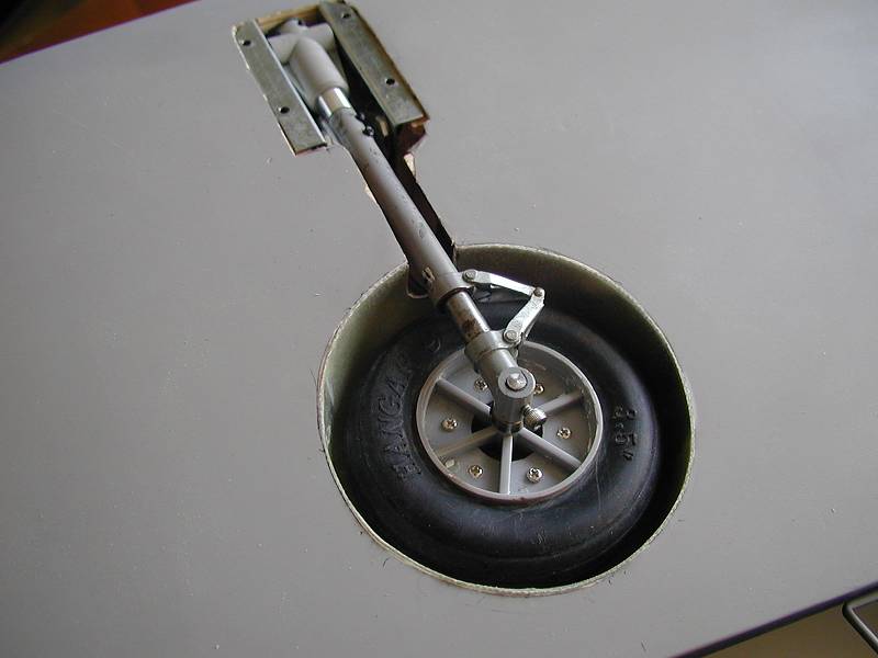

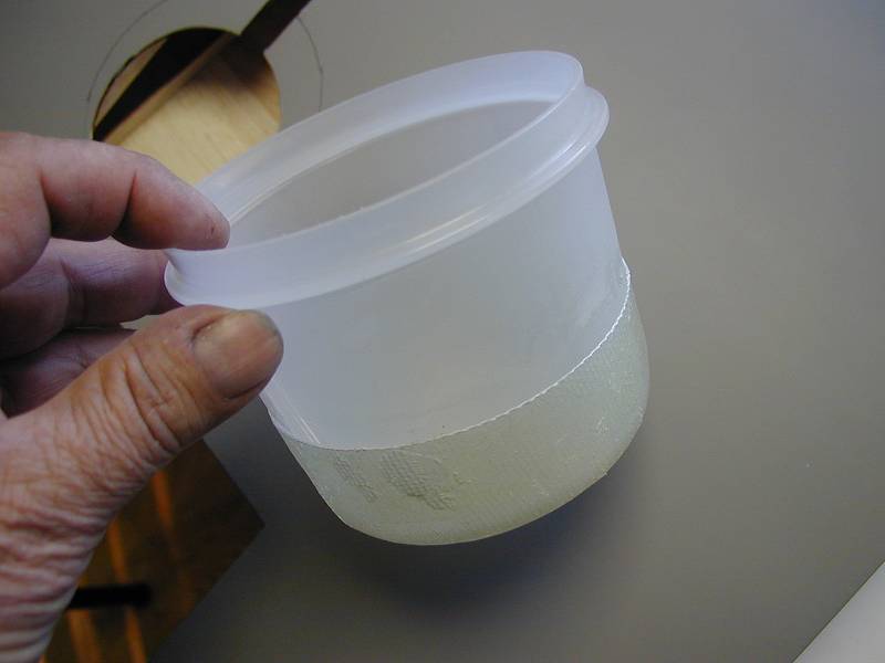

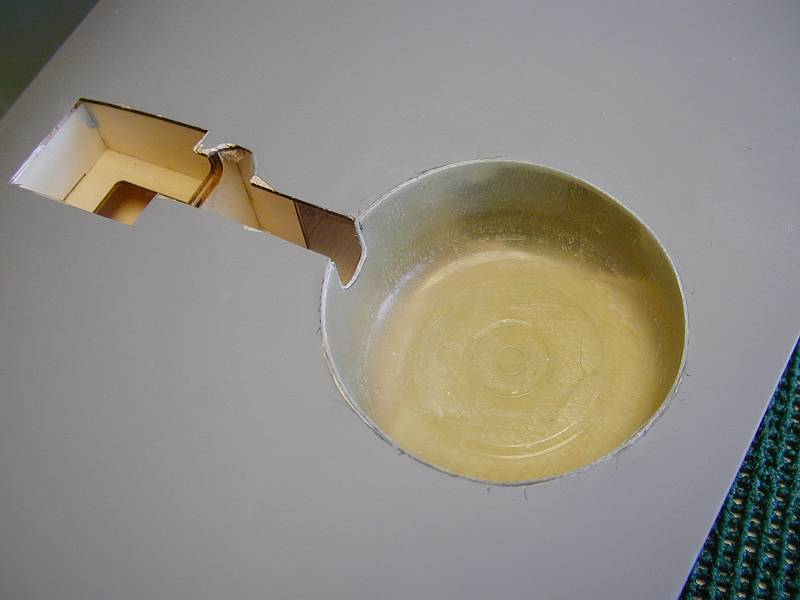

Thanks guys,
I think I am not too far off from the correct location if you look at my pix. I made myself custom wheel wells and fitted them in this morning. Came out alright, I guess. Used a Tupperware jar slightly larger than the 3.5" wheels I am using. Fiberglassed on the outside and trimmed it acc. to the airfoil.

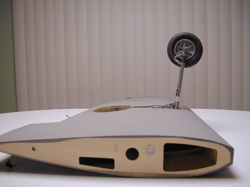

Hey bigbird,
I have attached a pix that should give you a pretty good idea of the location. I have no way of measuring the exact location of the axles since I have not installed the wing yet. But to give you some numbers here is what I measured: The struds are 2.25" behind the lead edge of the wing when extended.

Looks good to me! I guess I'll start on my retracts. I'm stripping the wing, tail feathers and control surfaces and fiberglassing and painting. I have one wing stripped and was not impressed at all with the joint at the dihedral. It appears to be filled quite a bit at the trailing edge, fitting better toward the leading edge. From what I could tell you didn't have to cut into the ribs on either side of the wheel well, is that right? I'm using 4" wheels so I'll have to.

Hey, bigbird
I did cut into both ribs. As you can see in picture #2 fro my first post, I had the bigger wheel well outlined. But I am using "only" 3.5" wheels. As a matter of fact I am using the H9 wheel from my big P-47 (80" wing). I stiffened the sheeting around the bigger well with balsa and epoxied the new fiberglass wells in place using micro balloon. That way it helped to strengthen the area around the retracts. I feel pretty comfortable regarding structurel strength of the wings.
