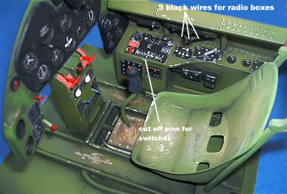

ORIGINAL: bigbird007
Thanks Pappy, I guess the main question is about all the pins. I understand the push pins are for levers but there are quite a large number of other pins. Maybe just a pic of the finished cockpit would give me enough. I'm not very good at the challenges you like so well and follow directions pretty closely. I try not to let my handicap slow me down to much.
Bob

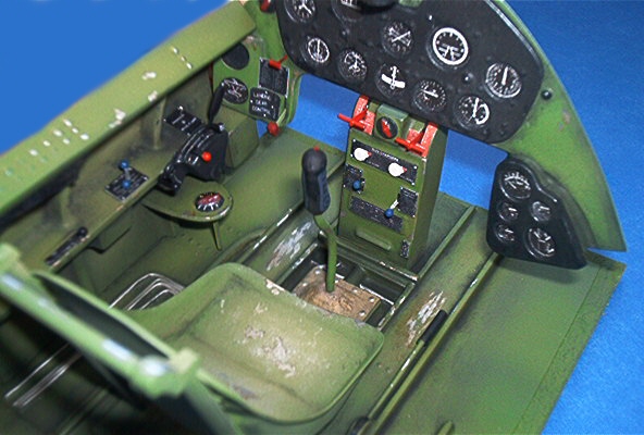

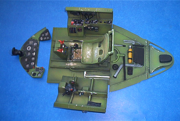

No problem Bob, I was just wondering. If you have questions, please ask. OK, here are some pictures with some explanations. The right panel just uses some placards for detail, but you can spruce this up by adding small cut off pins in the places where small toggle switches would be. Notice the 3 black radio wires. Also for the two larger silver levers I gave them a 3D look by gluing on a strip of plastic, see first picture.
Next picture shows the Left panel. Attach the map case as shown. A few more pins on this side, notice the placards locations. The throttle quadrant is the only tricky one, I spent more time on this one by adding small pieces of scrap plastic to the pins to make them look like levers. Also for the throttle lever I made it out of thin aluminum and a little balsa, use a Coke can.
For the instrument panel you just need to add 2 levers. Make both as shown in the picture.
Forgot one, the center console. The red emergency flap and gear levers were made with thin aluminum and small brass pins. Use the Dremel small drill bits to drill the holes in the aluminum first before cutting out the levers. Then trim them down and add the small brass pins, wick in a small amount of CA and paint red. The rest of the panel has only 2 blue pins.
I'll post more as I get my plane finished.

Beautiful, Thanks! I hope my cockpit turns out half as nice! I mentioned in an earlier post that I'm making a pdf of the instructions, you can have it if you'd like. If you like it you could put it on your web site for others like me who need them. I'd also like the cowl former template if you still have it. I asked Hal but he said he couldn't get into his basement...
I was planing on using a glue stick for the placards and do I need to spray with flat clear for longevity?

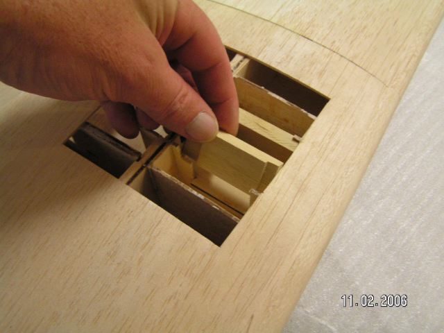

Here's what I decided to do to install the Sierra Giant scale retracts. The problem was the rails provided didn't leave enough space between them to set the retracts in and if I made them narrower it wouldn't leave much meat for the screws that hold the retract down.
I opened up the wing and trimmed the sides of the retract bay where the bottom slots into the sides. See picture 1.
I marked the back of the mounting blocks supplied and trimmed out the outline. This allows the full width of the block to mount the retract.
Then I cut some 1/8th aircraft plywood (5 ply) to epoxy on the back side to help strengthen it. I still have to sand out the spar for the air cylinder and cut the bigger hole for the 4" wheels I'll be using. I plan on using the carbon fiber idea that HalH showed in an earlier post. I'll also beef up the original structure with some more epoxy.

Now for the gear doors, for the Sierra gear see page #25 Post #612. Hal installed them in his Hellcat with my gear doors. For the Century Jet gear see page # 24 Post #591. I had to cut 3/16" off the mounts for the CJ gear and I think Hal cut off 1/4" off his for the Sierra gear.
For the cockpit do not use a glue stick, use a special glue for paper that you can get at Michael’s. I use Aleene's Tacky Glue, Dries clear and flexible. Elmer’s and other glues like that have to much water in them and don't stick well.
You must clear coat your cockpit, especially after weathering it like I show you. I wish more people would try the black chalk weathering, they would see how easy it is to get a nice looking part.

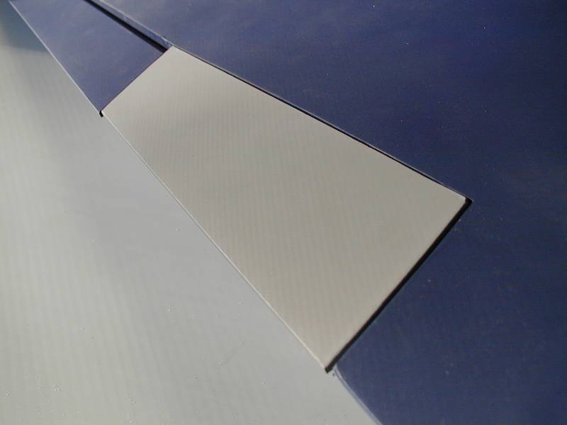

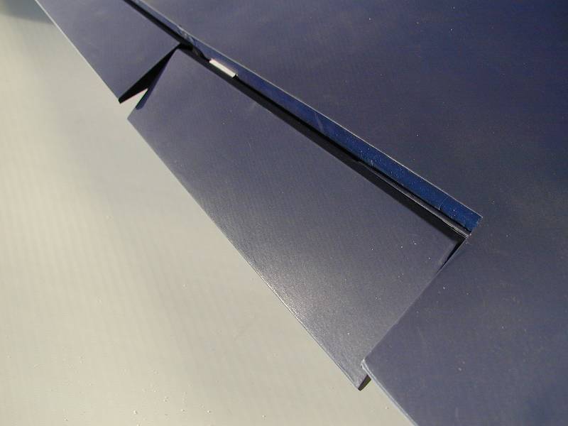

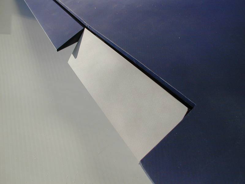

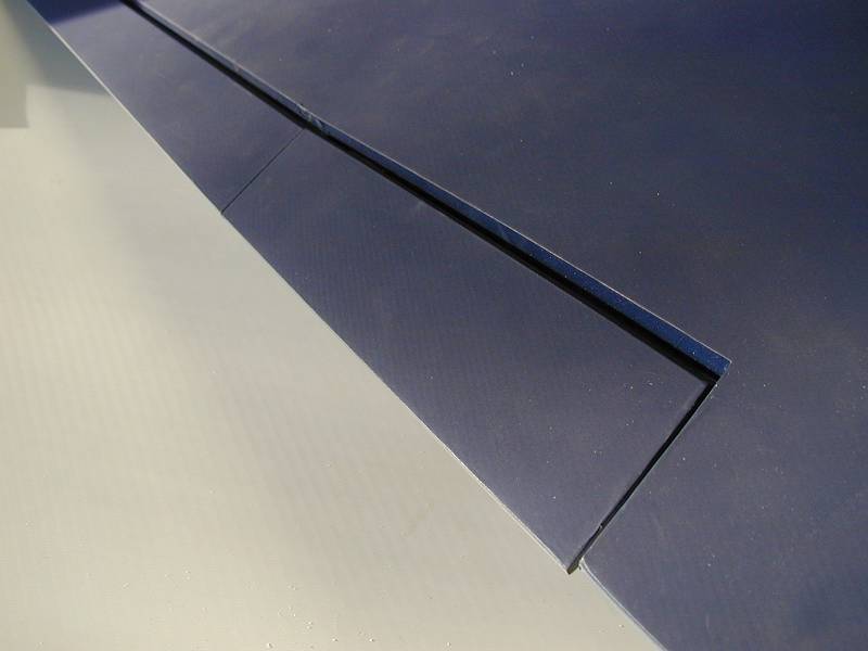

bigbird;
Here are my pictures of the left wing first with the wrong flap surface, painted correctly. You can clearly see the same large gap on top as the aileron. The next picture showes the flap down as much as it goes. Gap now is even bigger. Now I switched to the correct flap surface, which is painted incorrectly. You can see how nice and small the gap became. On the next picture it is obvious that the down movement is much more pronounced with the gap still being small. On the last pic I show the end view of the flap with the light gray on top and the dark blue on bottom. Yes, my holes did line up for the control arms.

Strange, it looks like it was put together correctly and re-assembled wrong for painting.
Mine is obviously the torque rod hole on the top of the wing. My flap won't move as much as yours did assembled wrong.
