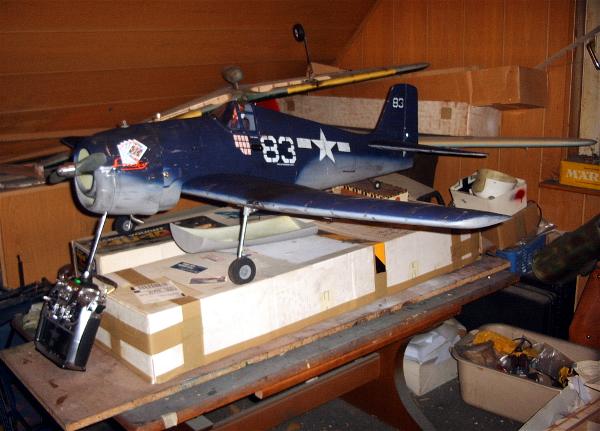

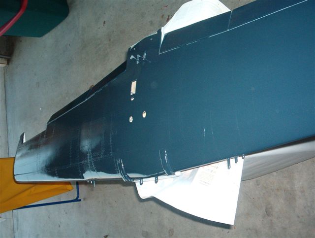

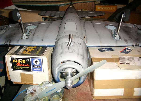

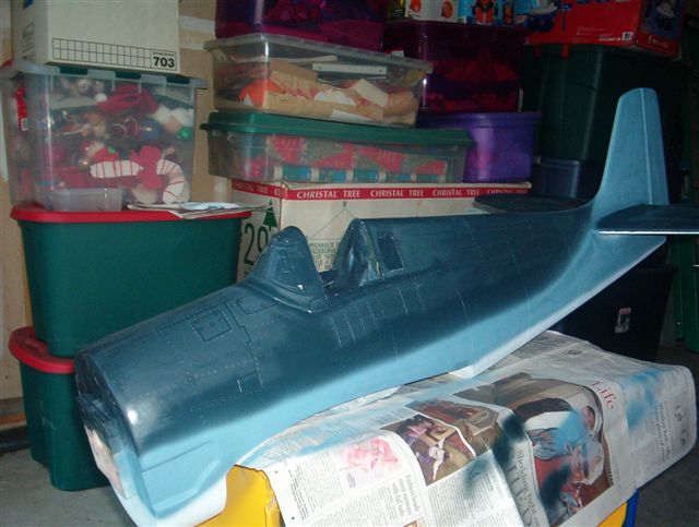

Well thought I would try to get things going. Here is what I got done this weekend. Hope to maiden no less than one month but I am also finishing my 1/5th TF Corsair that is just about to maiden also. Thought by now we would have more finished pics by now from other builders. Not exactly up to Luke's standards but I am trying and having a ton of fun. This weekend will start markings and the weathering.

I am using Model Masters Paint that is made by Testors. Dark Sea Blue on top then Intermediate Blue in the middle and Rustolem Flat White shot with my touchup gun.

I used the Model Master paints also, then I covered it all with Polyurethane to make it fuel proof. The colors appear to be right on.

Yes shortened the wing to next first rib which was a total of about 6". Best mod you can make. It puts the gear in the right place to give it the right stance. Looks so much better. Also if you can see did the flap and aileron mod. This is my second one, built the first stock except for paint which was also the 3 color scheme but this one is has the Cat mouth on it. Still need to make the tailwheel retract but that will be soon. Doing all of Luke's mods except for his cockpit which I missed out on but have everything else so I took a TF Corsair cockpit and modified it to look ok. Most will never know. Lukes canopy also makes a big difference. I will post some more as I get closer this weekend hope to get a lot of the weathering done but I always have 2 or more projects at once.

Well, after almost four month building this "ARF" I am as good as done. I got carried away with all these scale detailing stuff and since the weather doesn't seem to be willing to cooperate I am in no rush to head to the field for the maiden. When it comes to that I will wait for the best weather possible. Tomorrow I am going to fire up the motor and tach it with the three bladed 14x9 prop. So far I am tickled pink with the end result. I know she's going to fly nicely.
