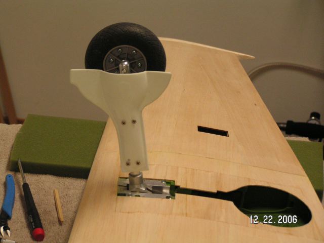

I'd love to see som pictures of either installed in the AC and what pitfalls you ran into during the process.
Ben
I'm using the Sierra retracts and this is what I have so far. I still haven't figured out how I'm going to close the small doors yet (they're not on yet). I'm using a 3 1/2" wheel and had to make the opening bigger which meant cutting the ribs on either side of the wheel well and making new short ribs to strengthen the area. You also have to cut down the spar a little to get the retract in (see page 51). The gear doors are from Luke.

Bigbird, Thanks for the information. I came into a complete set of Robart's from a guy in our club that is selling a bunch of stuff. I've read on here at least one person that used the 615s so since I got Robart: #188 Air Control Kit, #615 100 Degree Rotating Mains, #164 G PSI Pump w/ Gauge, #650 Shock Landing Gear Strut,for the package price of $100.00 (all NIB). I figure if it turns out I can't use it here it will fit some future project. From the looks of your pictures you stripped the wings and are going to do a recover. What do you plan to use? What other mods are you doing? What engine? I've seen the Flap aileron Mod and that looks cool.

I'm going to fiberglass and paint. I've got a custom cockpit, drop tank and dummy radial also. I bought a YS 110 for power and plan on a Spectrum DX7 radio. I've built 4 kits and put together a couple of ARF's but this is my first foray into bashing... we'll see.
