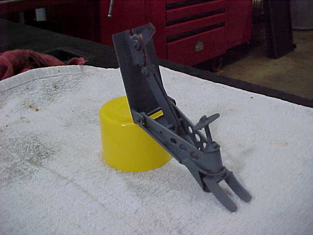

thevirgian, here is where I am at on the tailwheel. In primer most likely paint tomorrow. Very happy with how it turned out. I am hoping that I get to fly it this weekend but my wife is having minor surgery Thursday so not sure. Thanks again Luke your tailwheel plans worked out sweet.
Randy

Randy, I can't tell from your pictures, but did you use brass angle at the mounting plate and pivot point? It must have that, or the tail wheel will not hold. Look at my attached illustration to clarify what I mean. All you would have to do now is use a Dremel with a wire brush wheel and take off the primer to solder that joint. Let me know.

Hi Luke yes I did. I also did the same thing when I built the yoke. Thanks for the reminder. I painted it white this morning.
