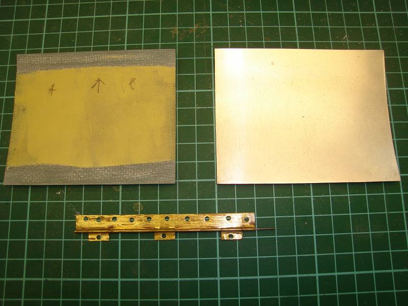

Hi Guys
Made a scale hinge for the cockpit door out of K&S brass strip,tube and piano wire.Was a bugger lining up the canopy rail so the working canopy will slide through ok without fouling.Next job is to detail inside of door and add litho to outside.Also in process of trying to make a working door locking catch.
cheers Nudge
cheers Nudge

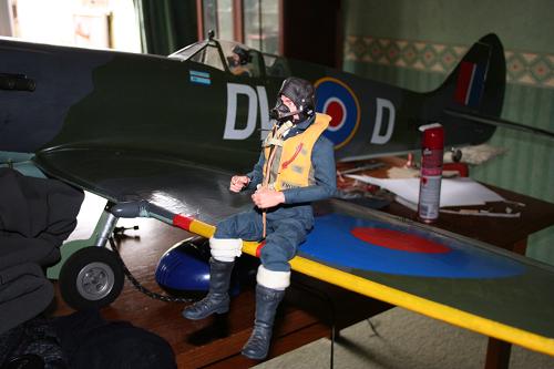

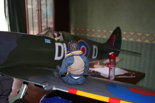

Joined: Apr 2009
Posts: 20
From: gloucester, UNITED KINGDOM
hi bradsome pict havnt got parachute tho figher is 12 inchesfrom head to foot and just under 4 inches wide and the weight is 8 onces as it is without a parachute`if you are not interested then maybe someone on here might be. looking for about £40ENGLISH pounds plus postage they do look good in the yellow spits
#595

#596
Joined: Apr 2009
Posts: 20
