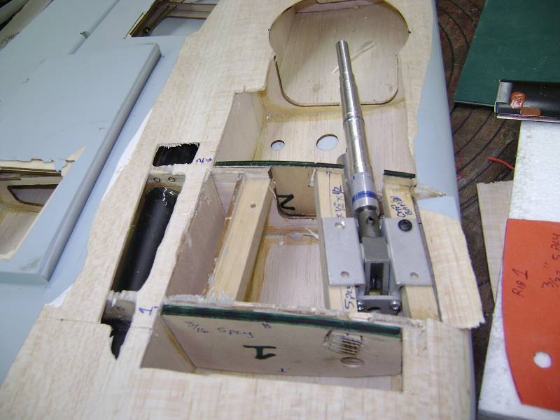

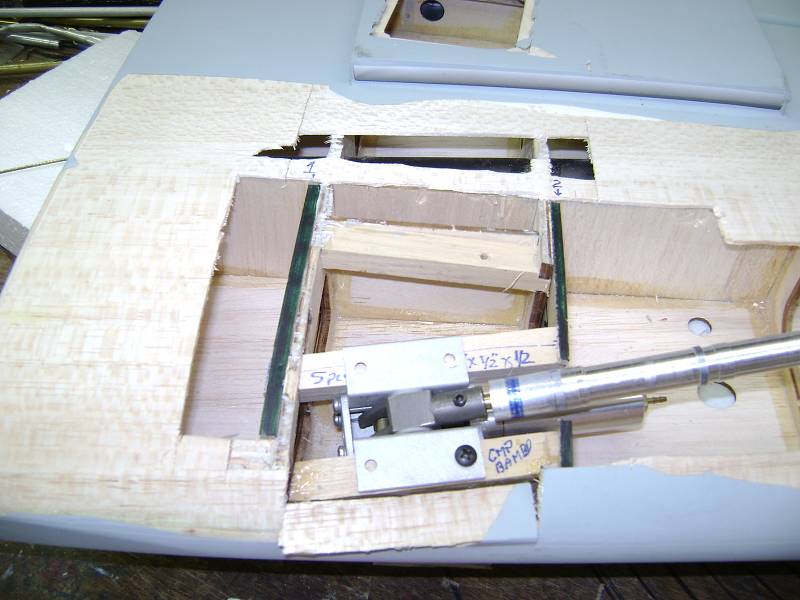

Here are some pics to show what I'm doing. I have nine pics, but I can't get them on without timing out, so slowly I'll post.
Takes more time to think up the design then to do the job. Total time around 1 hour of shaping and cutting. Of course the other wing will be easy now.
The pic should show the new wood ribs butt up against the outside of the original CMP ribs. The inboard rib is 5 ply 3/16 and the outboard rib is 1/8 3 ply. All ribs will support.
I have put green marker on the new ribs to show them. The rear rail is 3.9"x.5"x.5" 5 ply wood. 2, 1/4" plys glued together.
I have also pics of how to get the rib shapes with a contour gauge to cut templates for the wood ribs.
Positioning the LG rails is a bit tricky to explain, and not for everybody, but easy to do. So here i go.
The sheeting around the LG ribs has been removed as shown in previous pics. Some of the original ribs will have to be ground out with a dremel and sanding drum.
1) I used the original CMP retract rail on the front retract mount. Screw the retract you plan on using to the rails, centered. Larger new hand cut rail in back position of retract.
2) Now you have a retract with rails attached. The front rail is the one that will be glued in to hold the LG in position for now.
3) Position the LG front rail against the inboard rib, extend the strut, and position the forward rake you want and LG angle. Use scale pics for reference.
4) Now note the aprox position of the rails and try to hold and retract the strut into the wheel well. Aim for the strut to pass through the center of the "wheel well"
5) When you have settled on a location where the front rail meets the ribs, use CA only to the front rail assembly.
More to come ..

#181
Joined: Dec 2002
Posts: 149
From: Almelo, NETHERLANDS
Hello Khaloq,
Thank you for your effort towards Sierra for better oleo retracts. I for one do not have the skills or dare to tear the wing up of my brand new plane. For me these kind of things are the advantages of discussions on this forum. So thanks.
I'v one question though. Is the geometry of the Sierra retract exactly the same as the original? In other words, in the downward position, will the Sierra version weels be a bith further to the front?. I hope you know what I mean in my Dutch kind of English writing.
Regards,
Eric Schumacher, Netherlands.

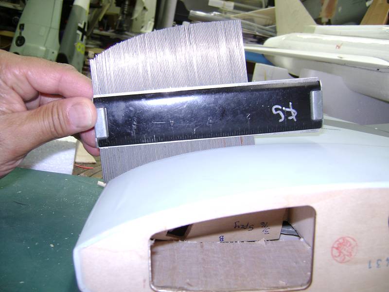

I can post only 2 at a time. More will time out.
I use a contour gauge to get the top of the rib shape and trace it onto the top of the pattern, in this case foam sheet
I use 1/16" foam from my kids craft box to get a rough shape of the rib. One can use card stock as well. It is easy to place up against the original ribs. After you get a shape you're happy with, trace it onto the wood you will use for the rib. And rough cut a rib.

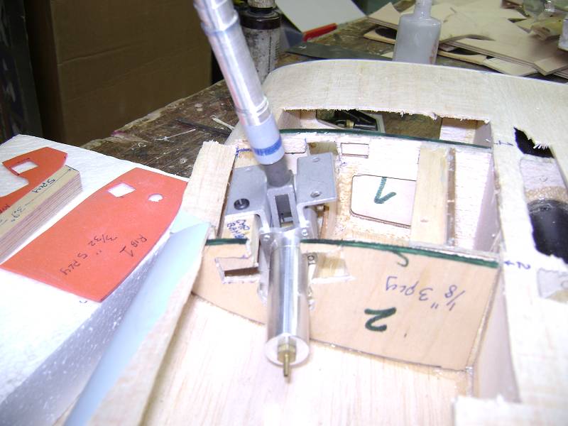

#184
My Feedback: (13)
Note the previous pic does not show the back rail in place. This is important. The front rail holds the gear in position, and sets up all the other components,. It will be one of the last parts to be CA'ed in. Its kinda like a jig to hold things in place.
Also note, I went as far towards the LE to still give a the retract space between the top sheet and retract. The rertacts will also be below the sheeting once covered with the balsa.
Since the rails are below the sheeting, it give one room too done a final shimming if needed/desired.
I am always thinking not to damage hardware, only wood. So its designed to break wood out in a hard hit. And if i hit that hard, back to flying school.

#190
My Feedback: (13)
Thanks LDM
rchorn
I guess you can use 85 degrees +/- when viewed from the front. As for forward rake, I use a diagram of the 109G2,6, tail raised to level the model, then looking at the wheel axle shaft distance from the LE cord. It has way more forward rake than CMP factory puts. See 109 LAIR online for scale info.
I don't use the degree to set my gear as much as I use a scale drawing and try to make mine look right when it sits on the ground. You can always shim a bit or even slide the retract closer to the fuse side or wing tip.
A little shimming on the retract goes along way at the axle.

yes, but those small scoops are useful for bringing in air to cool your glow or electric motor.
Now as far as wheels fitting ni the wing....if you use thin style Williams Brothers...like the Vintage...you shouldnt have an issue.
