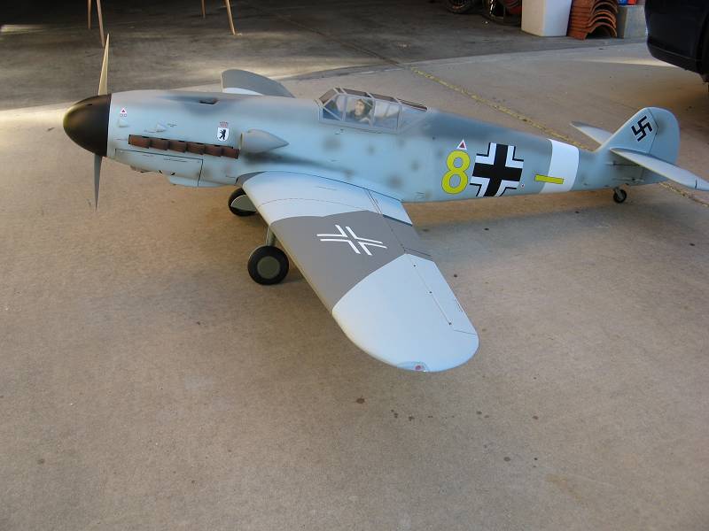

Finished the '109...............
Time to go flying..................

Cant wait to hear the report..

Looks great, WWIIP38 !

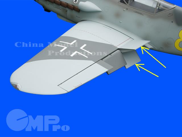

Sorry if this is a silly question.
I am trying to figure out the movement of the inner combined surfaces according to the orientation of the servo mounts.
The hinges on my plane are not glued in place yet, so I cannot just hook up and try.
The ailerons and flaps seem to move correctly when connected with a Y-harness. However, do you need a mixer for the inner combined surfaces?
Helge.

HW50
Please be more specific (exact) about which control surfaces and what the you combining them.

The yellow arrows show the control surfaces I mean. I am sorry for not showing my own plane, since all the surfaces are removed, preparing for glueing the hinges.
I wonder if the arrowed surfaces can be controlled by using a simple Y-harness on one channel on the RX to operate both servos, or if mixing two channels is necessary.
By just looking at the arrangement, I found that mixing two channels is the answer, or perhaps a servo reverser on one of the servos. But again, I wonder.
Helge.

Yes it can be done. Many ways to configure it. Y connector may work. Just look at the servo horn positions when activated. And connect accordingly, if the geometry is correct.
Try it.
I can tell you that with the I radios have, JR 10sxII/8103/9303,ect or something like that, I can do it if I take the time to read the booklet. The control combinations are almost unlimited. Y connector makes it even more versatile.
Me personally, I would avoid the radiator flap (top one) in the up position when using the flaps to land, until I see what the flap/flaps alone do.
Hope this helps.
Helge.
You do realise both surfaces are controlled by one servo? each side? the set up is per wing 3 servos two of them are hooked up with Y leads and the aileron is with an extension lead I used 1 24" extension for the aieleron 1 24" Y for the flaps and one 12" Y for the brakes, the brake uses a T servo arm and a wire off both sides to open the flaps
TAKE CARE with gluing the hinges in... part of my problems with the Y control rod was a sticky hinge.... too much glue and I didnt pick up on the fact until yesterday I spent about an hour with a magnifying glass, some tweezers and a pin cleaning it out to free it what a pain in the ....
