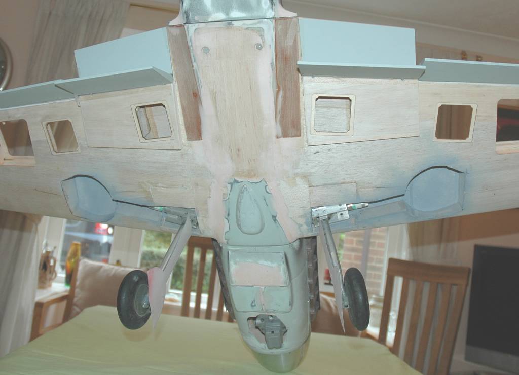

The wing on mine has been well &amp; truly "bashed"
I had our fabrication shop make a new wing tube to get the correct dihedral
the legs are now the right(ish) length &amp; in the proper position which meant a rebuild of the centre section
I also chopped the under panel about so it fairs more into the wing underside.
God, I hope all this is worth it!!

ORIGINAL: messerschmidtman
Yeah...the last thing anyone needs is to spend a ton of hours on mods before the maiden flight only to crash. I've seen this happen more than once.

Well I have been designing &amp; flying this sort of bird for more years than i care to remember !
With all the mods she is coming out suprisingly light for a 109 of this size.
the 180 should provide enough grunt &amp; the CG is in a safe position.
The test flights will be on a large airforce base with all the room in the world.

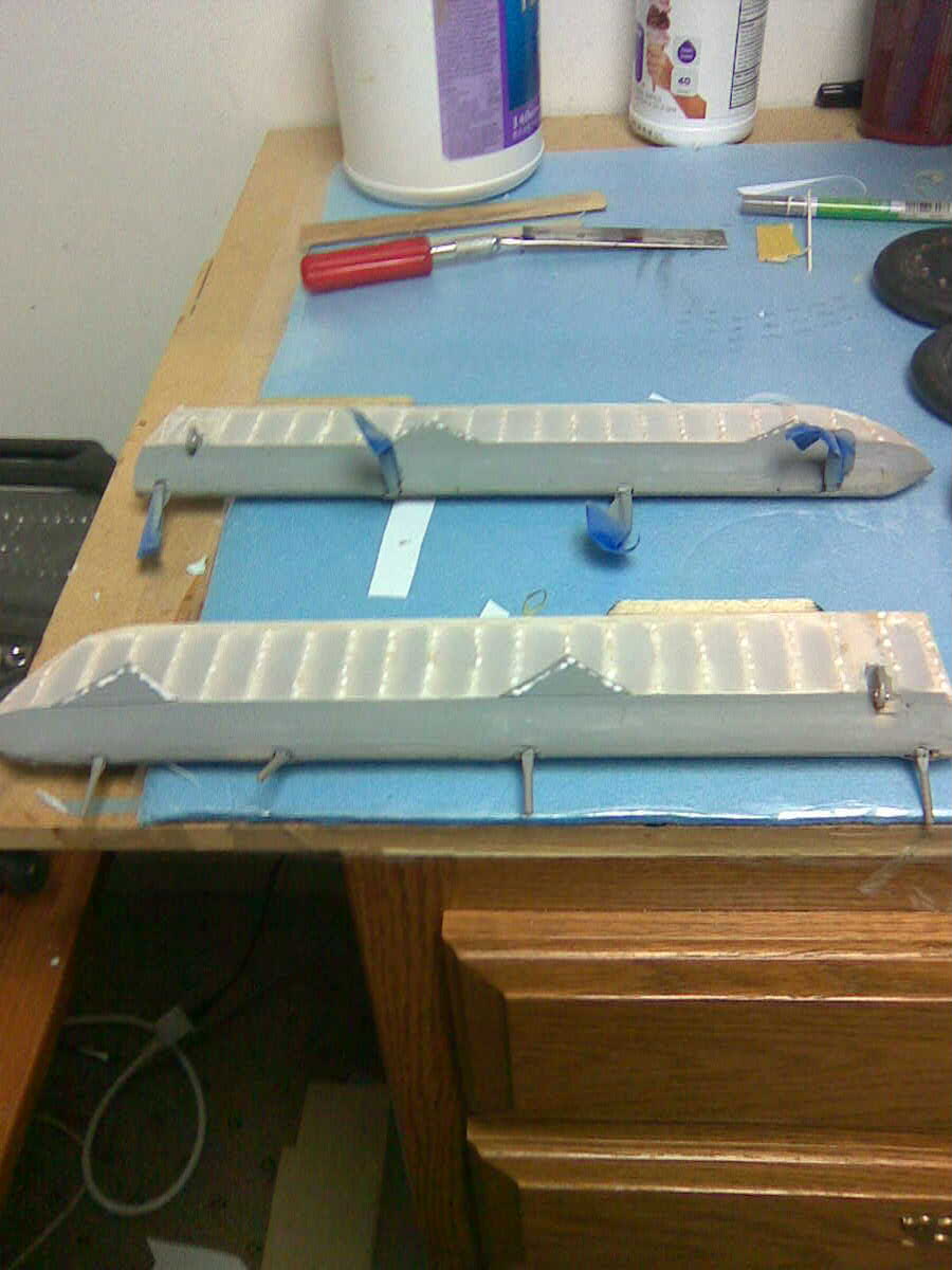

I cant start another bash , I am finally in the stages of riviots ect on my CMP Fw190 , it has sierra retracts , split flaps , full interior , air powered sliding canopy , retractable tail wheel ect ect .
My wife siad "you got thing three years ago as an arf , whats the point lol "
I said hey , "I married you 25 years ago , and i pay for the implants today "
That did not go over well my friends !!!!
