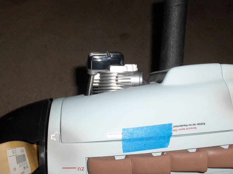

yer 50cc = 3 cubic inch way too big pity really it would be nice to put a two stroke gasser twin in it....... however now I have found this motor I am going to find a plane to fit it lol

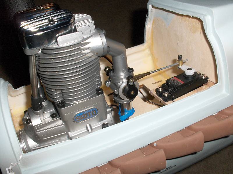

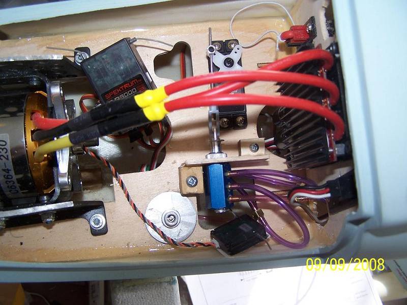

Here is a pic of the installation of the engine servo. You can see the damage to the front of the fuse from shipping. I'll fix this later when I drop the engine down 1/8. I'll replace the prop with the correct one when all is completed up here. I still have to figure the muffler installation. This engine is very close in size to the 180 for those of you planning to go that route.

I am a 4 stroke virgin though so I have some questions..... on this motor the crankcase breather exits by the camshaft through a tube to the intake, there is no snubber to restrict the flow or any sort of one way valve, what happens at WOT with this tube? with the piston going up and down 8000 times a minute that's an awful lot of crankcase air pushing back and forwards through this tube! could it affect the mixture? in a closed throttle situation I gues with the vacuum the intake forms it will suck out all the excess oil but once again the piston pulsed may play havoc with the mix? I can see the advantage to this with no oil dripping out of a tube under the plane.....

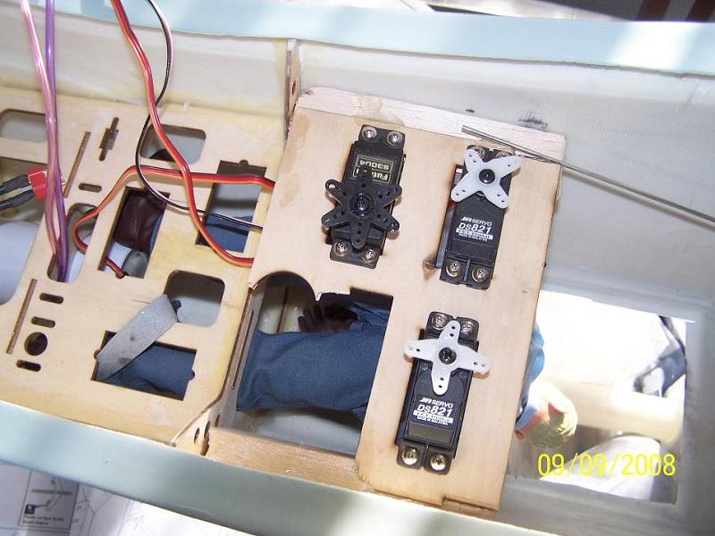

pics of additional engine area work. Retract servo/valve etc all in place and working. Air fill valve placed on the wood mounting surface with large metal washer to hold it nice a snug.
Ive also installed a new servo tray behind the stock one since the stock location will be used for the two 5s 4800 batteries.
Still working on getting the pilot to fit ok.

My Feedback: (157)
kahloq
Love the conversion. I've always wanted to go electric but the price of batteries and watching my friends F4U go up in flames after a bad landing(CRASH) has scared me away from them. I don't mind the smaller ones but the batteries just seem too much to deal with along with the extra that goes into them. Do you have any options or locations where the batteries are reasonable. I have a kit I would love to convert.

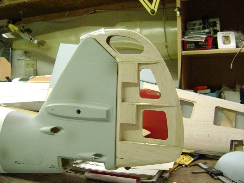

A pic of the rudder.
Pretty good fit but, since CMP put a radius on the rudder LE, I thought I would do what CMP has done with the other control surfaces but neglected to do on the fuse V-stab.
So I opened up the back of the V-stab, sanded the filler down and fit the rudder to the fuse in a more scale like method. The rudder even fits better with the V-stab. I also noticed that the rudders shape was wrong for this version of the 109, so I sanded the bottom corner to a softer radius. Also, I will cover the all the fabric surfaces with Solartex. It has a fabric weave look to it. I will also use aluminum tape patterned with a "pounce"(?) wheel. It will give the look of stitched fabric on a rib.
The rudder will be anchored will a balsa rudder post, countersunk to give the rudder a faired look.
The V-stab is a bit fat and symetrical. I may correct that to the a-symetrical airfoil as in scale, along with the rudder. Our small 109 is a-symetrical. I don't know if it helps in flight, but it gets comments about not being symetrical. It make a good conversation issue.
I will also use hidden control linkage. The model is big next to my small one and the small one has hidden elevator linkage.
