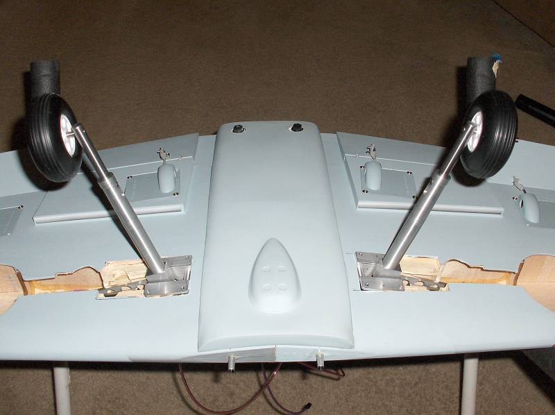

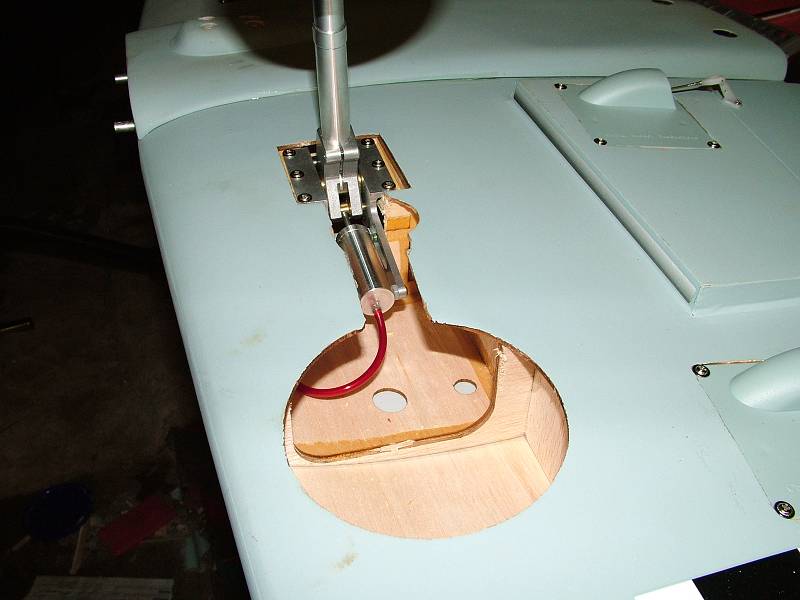

Finally got the retracts today... Here is the setup thus far. I will finish this off tomorrow morning. I plan on taking this out to the field this this weekend come hell or high water!!

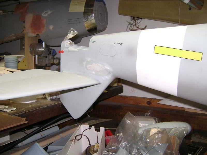

Haven't worked on it for a few days till last night.
Pic of the elevator rod exits patched. Ground down with dremel, then 1/16" balsa backing inside fuse with foam layer glued and sanded flush, then 3/4oz. glass epoxy finish layer sanded to finish.
Steve

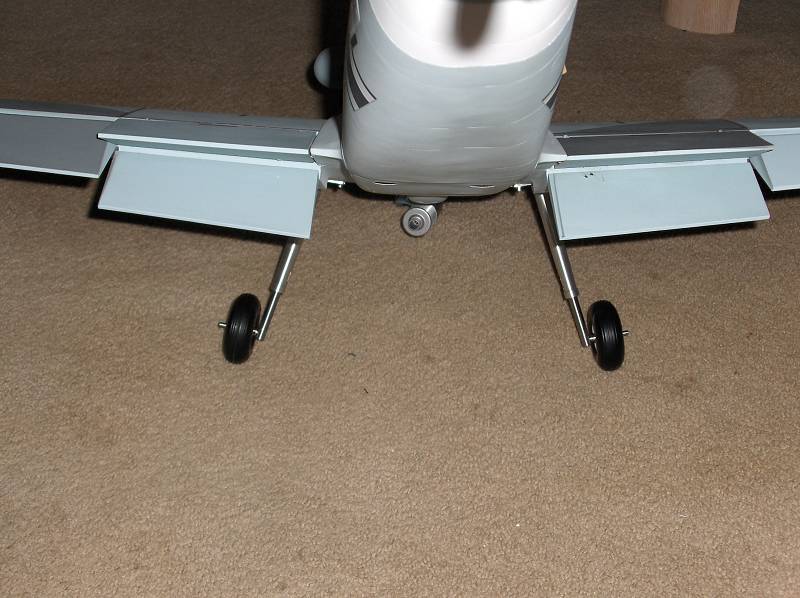

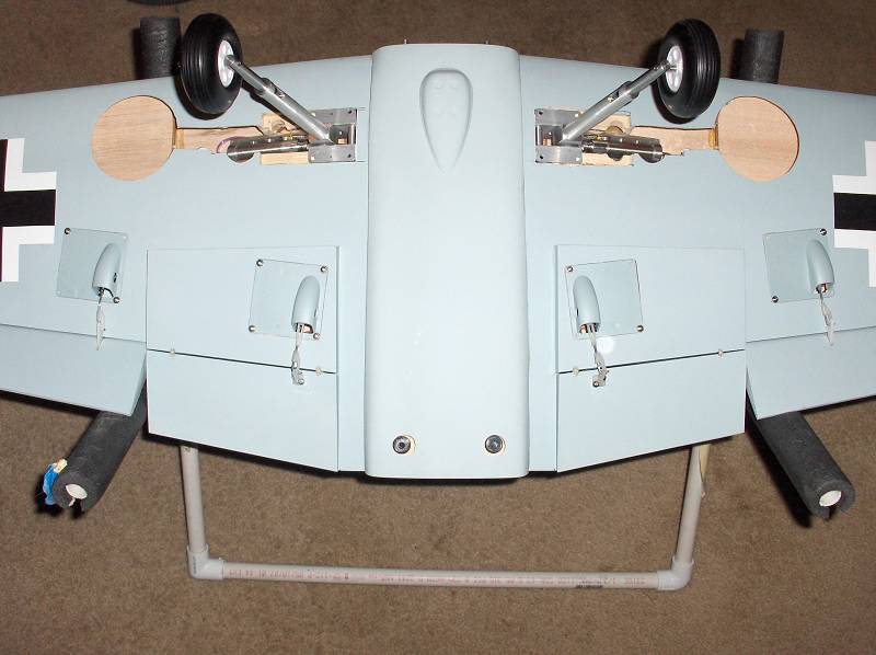

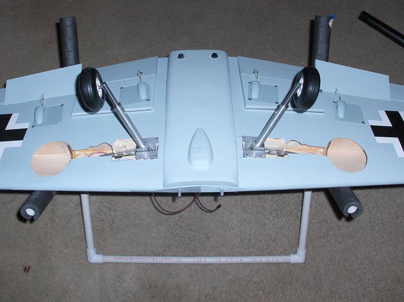

Here are a few pics of the early stages. Working the forward rake now, trying not to do too much dammage to the retract mounts. Looks like I may have to send them to Shindin to have it added[&o]. These gear are ok but I wish I'd bought the Sierra gear. One other thing I changed were the air brakes. . We'll see what happens

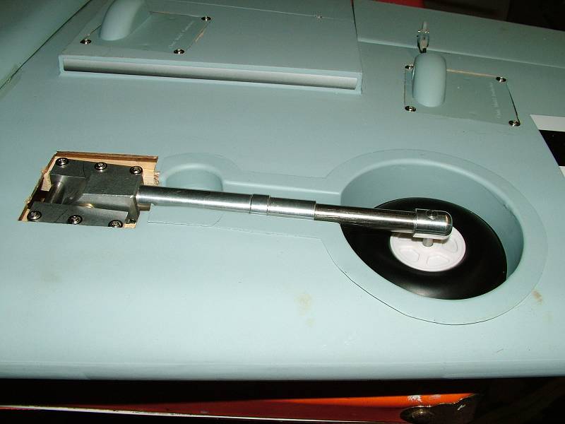

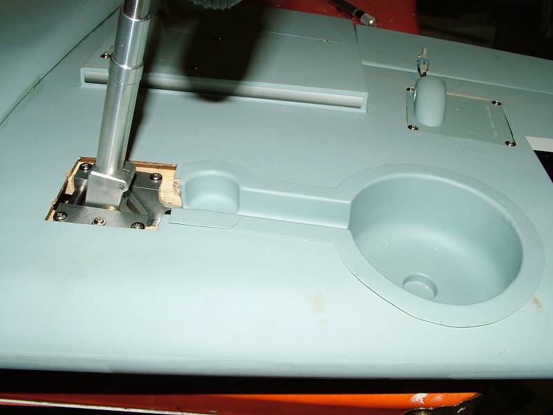

Ok then fitting the retracts http://www.sierragiant.com/ I purchased a set of Darrell about a week ago and I nothing but good things to say about this company! The retracts are a high quality unit with sprung struts included, see the deal he has listed above, to fit them you have to take some chunks of wood out of the support rails and taper the front rib to allow the hose to fit in without chafing..(look at photo 2 blue tube)..... I have also decided to fit the plastic wheel wells too and they go in nicley between the cylinder and the frame of the strut you do have to slightly enlarge the balsa covering to slip the retract in..... I am using the stock wheel too and it fits right onto the gear

With the gear extended, where do the wheels line up relevant to the leading edge? Do you have any pictures taken from the side showing that angle? I haven't decided if I'm going to do the big wing mod and make a new position for the gear or go with a drop in set. Those SJ gear do look nice though.
Tim
Needs bigger wheels! Those tiny things really distract me for some reason. Get some William's Brothers wheels.

I put the Williams Bros. Wheels on my Sierra gear. I should have rotated the gear forward just a touch when mounting them because the wheel is almost touching the spar when retracted. I hope to get them all mounted up this weekend.

ORIGINAL: Evil_Merlin
ORIGINAL: Ramstein44
Looks like I may have to upgrade the wheels. The prop is two inches away from a prop strike.... 20-8. I could go with a 18-8. Running prop per my instructional booklet says use a 19-8 but finding them are next to impossible.
