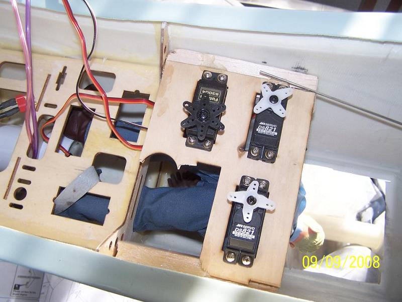

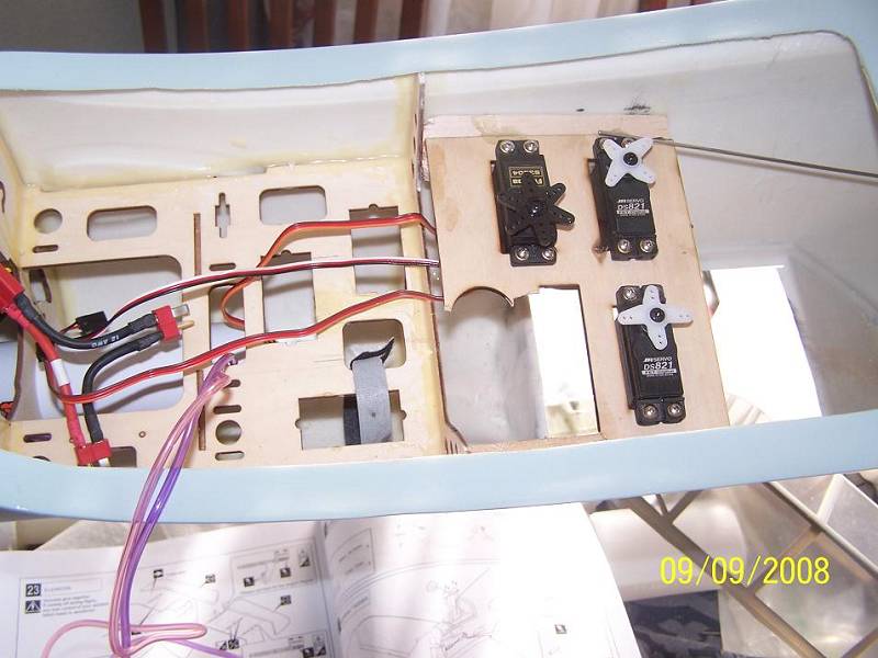

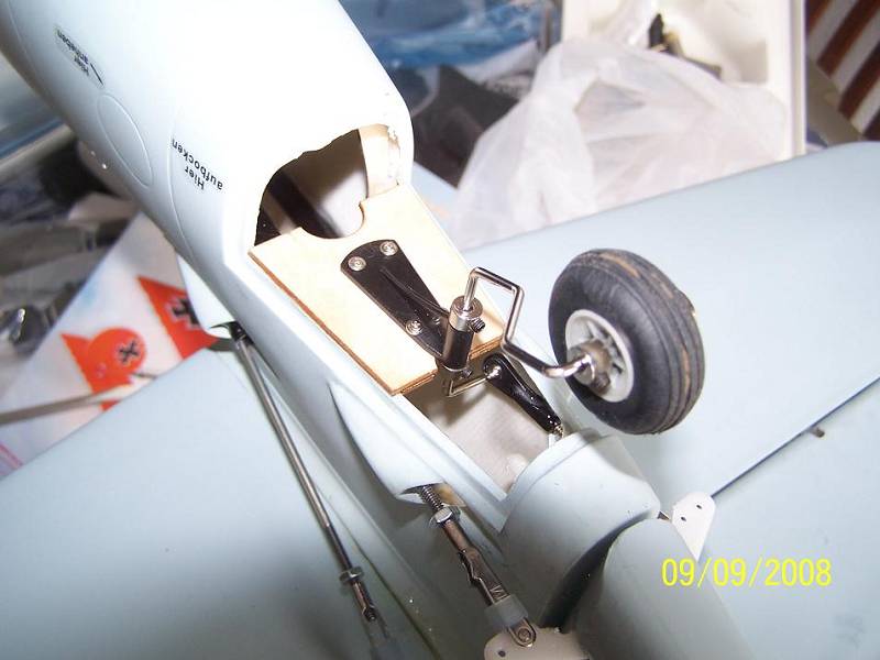

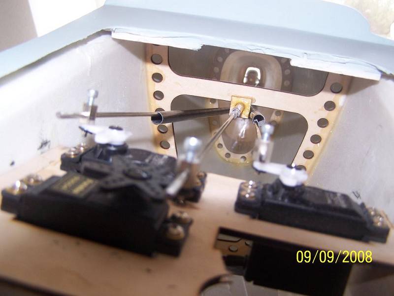

here ya go.
The first two pics show the additional servo tray I glued in place since my big batteries sit on the stock servo tray. The two DS821's are the elevator servos. The next few pics show the control rods going through the black fiberglass tubs. I cut a little off one of the tubes to use at the back end where the fairing exit is for the rudder as well because this control rod is run through a metal tub with nylon insert. This makes sure the control rod doesnt bend since the metal/nylon tube wasnt long enough. You can see in one of the pics some of the black tube which is glued inside the fairing rod exits for the elevator halves.

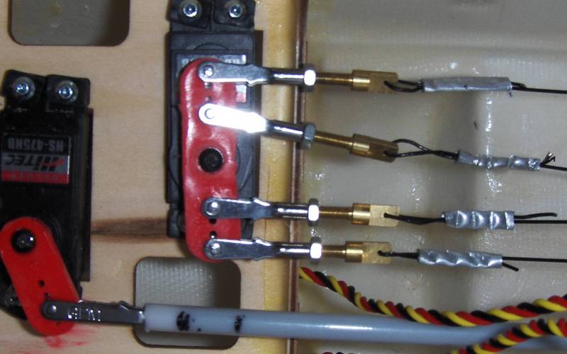

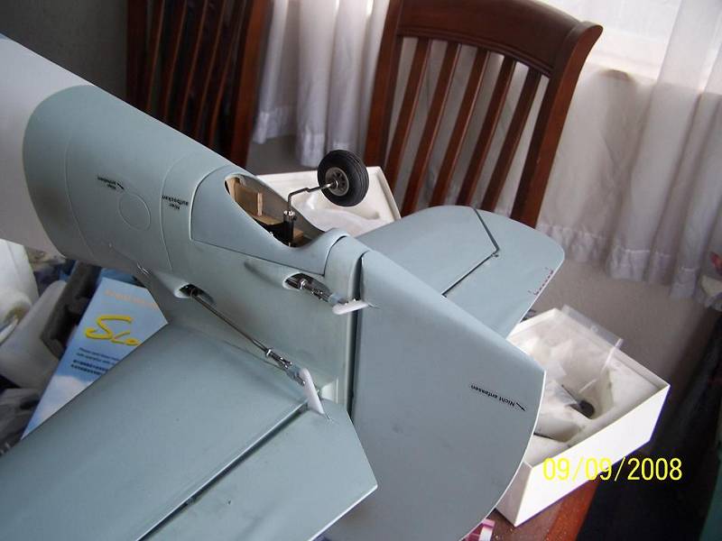

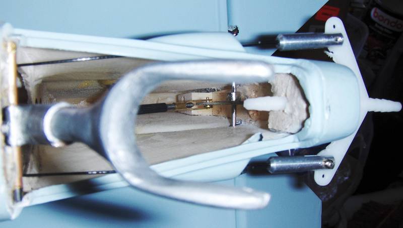

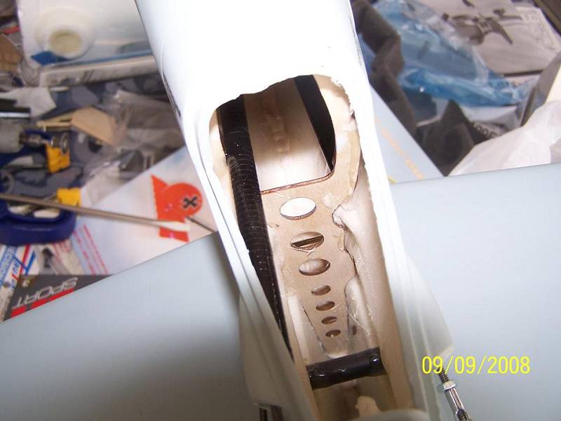

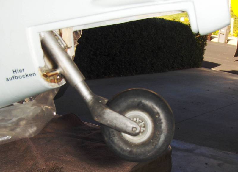

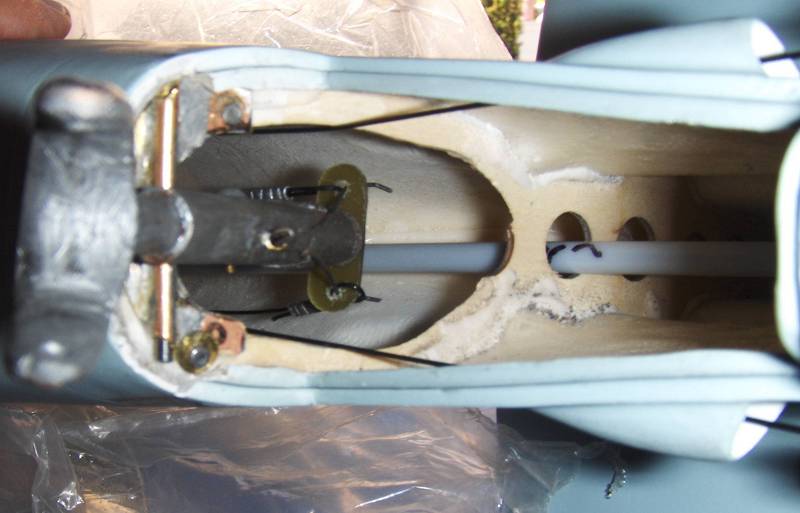

OK guys here's myTCW. I have a shock absorbing retractable tail wheel. The retract mechanism is a HITEK #82MG servo slaved to the retract channel. The rudder and tailwheel dirrection are controled by the same servo and pull-pull cables. The elevator halves are connected by a 1/8 dia steel rod with a control horn made from a wheel collar with a brass arm soldered to the collar. the steel rod is bent in an L shape and inserted through holes made in the fuselage just aft of the stab mounts in the verticle stab. The control arm is put on the straight end of the arm and then the arm pushed thru the other side. The second bend is then made for the other elevator half. (Thanks Steve) You should have ground a flat in the rod to hold the control arm in place. You can tighten the set screw thru the middle hole for the rudder hinge. The elevator control rod is positoned such that the pull is up and the push is down. The control rod has a 4-40 carbon fiber center and a clear outer shell which is attached to formers at both ends to prevent buckeling.
I'll add some pics with comments.
Pic 1 shows the pull pull cables for the rudder and the steel rod and control arm for the elevator.
Pic 2 shows the servo that controls the rudder and tailwheel with the 4 cables.
Pic 3 shows the control arm for the tailwheel and the mechnism for centering the tailwheel when retracted.
Pic 4 shows the wheel retracted and the mount for the tailwheel.
Pic 5 shows the tailwheel when retracted.
Pic 6 shows the extended positon

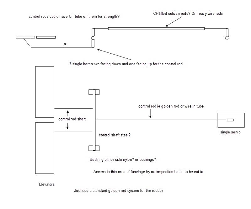

Actually after looking at BQuartucy's setup I am seriously considering pulling off my elevator and starting again....... must admit I really like the retractable wheel idea Just not sure how easy it will be to remove the elevator halves
